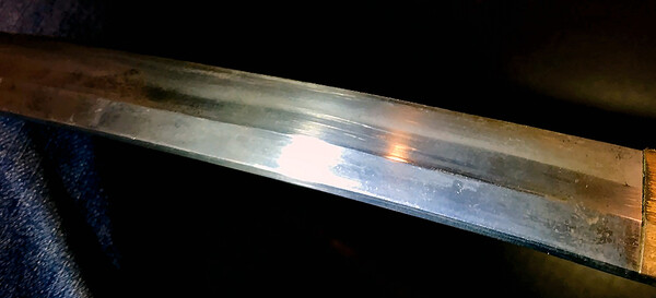

Here are some pictures of the blade. The hamon is obscured but still there. It's sad to see it so neglected, but given it's of relatively recent age and of no major historical significance, it's probably not worth a restoration and polish.
Is it a safe bet to now say this was traditionally made?

this could be a gendaito. Please make a photo with sunlight from the back. You will see the hamon clearly. Post us the picture.
Best
Chris
Hi Chris,
Thank you for the tip with lighting from behind. No sunlight currently available but I used a flashlight instead.
The hamon immediately popped out!  Amazing!
I guess this gives me some idea what the old beauty might have looked like in her prime, eh?
Being an authentic Amada Sadayoshi, there is no doubt that this is a traditionally made sword and is worthwhile to pursue restoration. Sadayoshi was a top smith of that time period and examples of his work I have seen in fresh polish were wonderful. The fact that it is of 'recent age' is not a concern to preclude restoration. If the sword were mine I would share with Andrew to get his assessment.

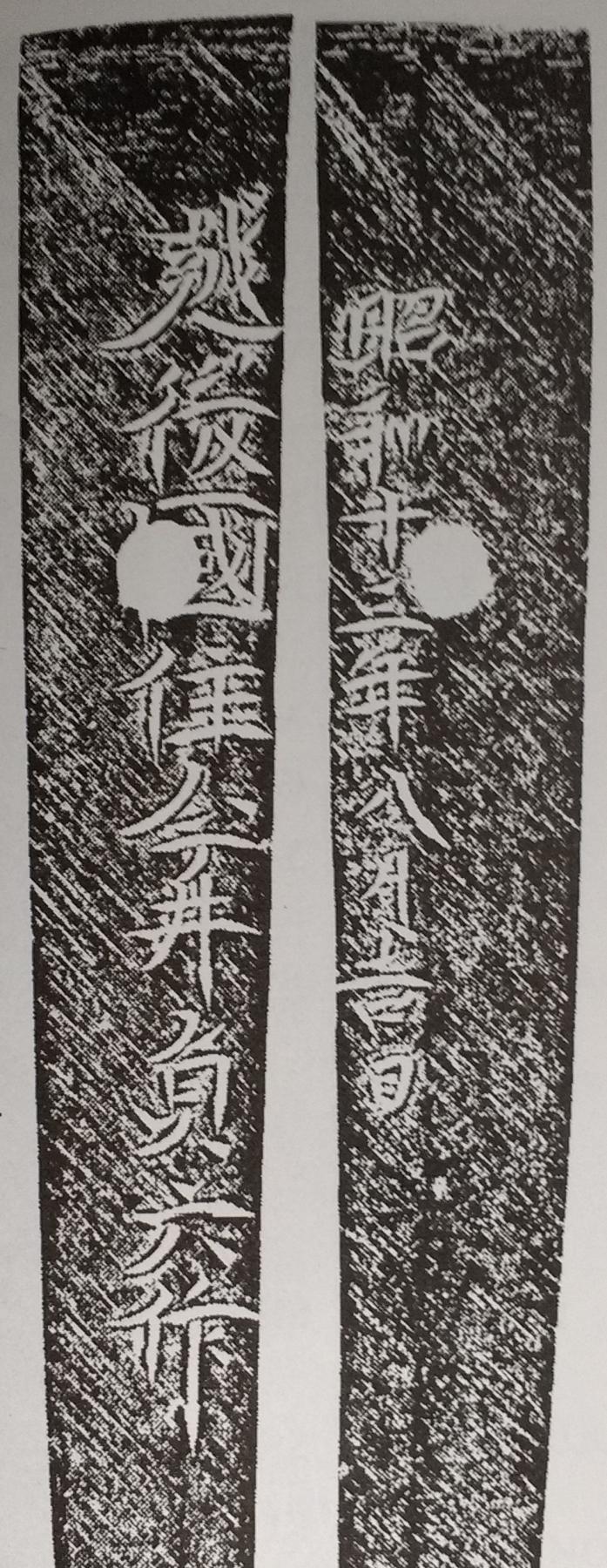

I am certain that it is Sada, and I would bet that this is a dai-mei by his student Imai Sadaroku. Compare with the attached oshigata. It appears to be by the same hand.
  • Like 4
Thanks Ray! it is the stroke of Sadaroku which would explain a lot being one of his last swords and  at his age id have a student do it too.
Great possibilities with this one, looking forward to seeing what Andrew says about saving this.

I have found photo's of two certified Sadayoshi blade's online (at least, they claim to be certified). Here is how they compare to mine:
Genuine blades on the left and right, mine in the middle. Please excuse my nasty copy\paste Photoshop job. I have sharpened the image to make the characters more clearly visible.
To my untrained eye they look pretty darn close. Only the second-last character is a bit off, but perhaps it's a style difference because it's not consistent in any of the examples. Maybe it's like me always struggling to draw a neat capital "R"  :)      What do you all think?
To me that is an indicator that Sadaroku may have signed the sword on behalf of his teacher. It is the way he signed his own blades (refer to the oshigata I shared above) and students often assisted the master to varying degrees. I do not know the circumstances of Sadayoshi's death at the young age of 38, just four months after this sword was made, however if there were health issues it would be expected that the student may have provided support in finishing his master's swords in this way...
