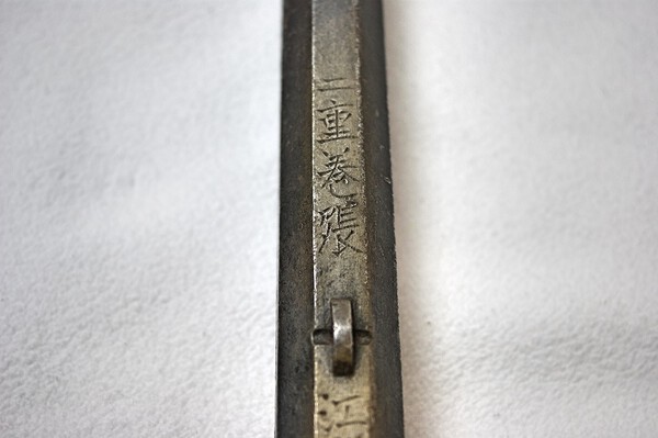

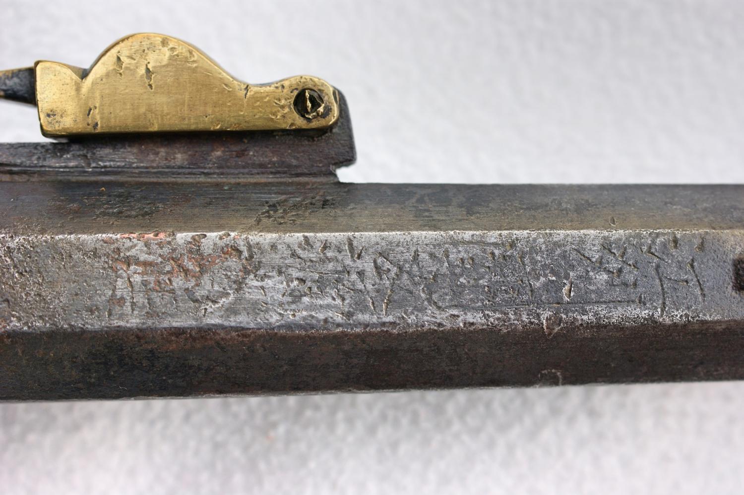

Bugyotsuji Posted September 20, 2018 Report Posted September 20, 2018 Roy, can you take three shots of the bottom half of the Mei each under differently angled lighting? Place the muzzle facing away from you, the Bisen breech screw towards you, and shoot the lower fuzzy section from Fuji 藤 down.... thanks! Quote
ROY RICKETTS Posted September 21, 2018 Author Report Posted September 21, 2018 Hi Piers Many thanks for contacting me I trust that I have understood you correctly Attached please find my humble attempts using my box Brownie sadly I think that these are the best results that I am likely to get. Best as always Roy Quote
Bugyotsuji Posted September 22, 2018 Report Posted September 22, 2018 That’s great Roy, very helpful. Will get back to you. Quote
Bugyotsuji Posted September 23, 2018 Report Posted September 23, 2018 On the short list; hang in there! Quote
Bugyotsuji Posted September 23, 2018 Report Posted September 23, 2018 The double question will remain whether there is another character which has been erased below, (Is it a six-character Mei in total or five-character Mei?), and what is the character after Fuji, if there was one? Only the owner can answer these I think, or the first question anyway. I think I can make out the shape of 里, or 理, which gives a key in the search. The former is part of 重, which is often used, whereas 理 was never part of a gunsmith's name in Kunitomo as far as I can see. There were about 150 Kunitomo gunsmiths, and by a slow process of elimination, 国友藤原重当 might fit in there for example, or 国友藤岡重仍. Many smiths read the 藤 character as 'Tou', (as in Totaro, for example) but in these two 藤 will be read 'Fuji-', ie 1. Kunitomo Fujiwara Shigetou/Jutou and 2. Kunitomo Fujioka Jujo/Shigenao. 1 Quote
Bugyotsuji Posted September 23, 2018 Report Posted September 23, 2018 Or can you see for example: Kunitomo Fujiuchi (or Tounai) Juto, 国友藤内重当 Kunitomo Fujiuchi Shigekuni Jukoku 国友藤内重国 Kunitomo Fujiuchi Shigeyoshi 国友藤内重好 etc.? 1 Quote
ROY RICKETTS Posted September 24, 2018 Author Report Posted September 24, 2018 Thank you Piers I have looked at it under a strong magnifying glass and find I am unable to read the last two characters so you have done far better than I. It is such a pity but I guess we will never truly know any more than you have so patiently discovered my thanks again for all your research on my behalf. Roy 1 Quote
