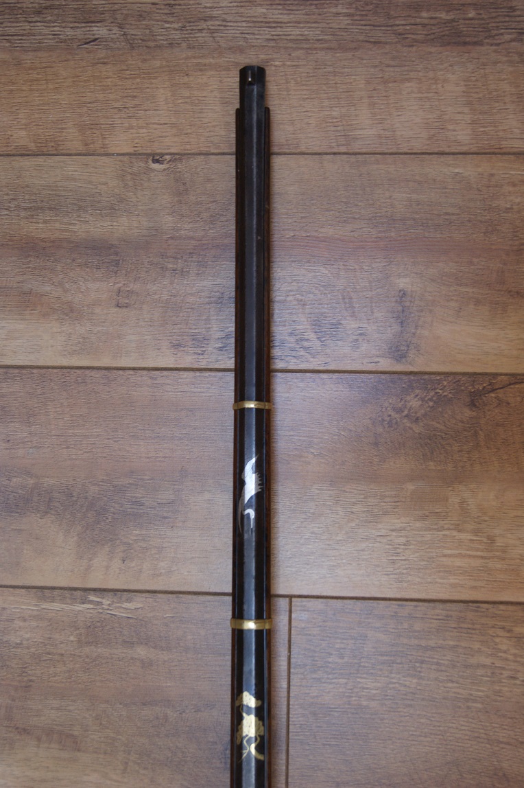

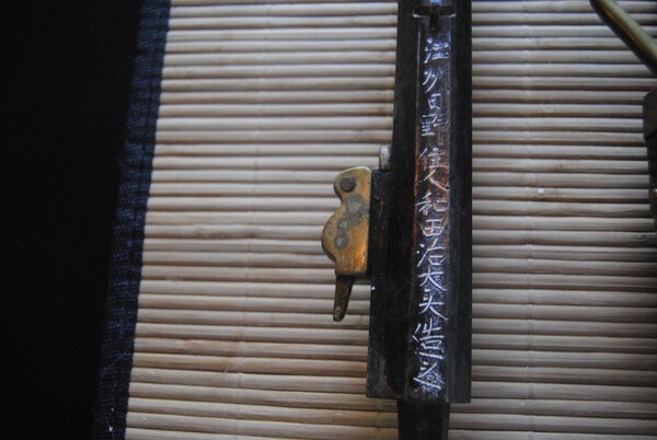

ROY RICKETTS Posted July 7, 2018 Report Posted July 7, 2018 Gentleman, I have joined the forum because I have recently purchased a Japanese matchlock and would be grateful if someone could please tell me the meaning of the characters on the underside of the barrel. I have been an antique gun collector for 50 years and this is my first matchlock. I am happy to supply further images if required. Many thanks and look forward to hearing from you. Roy Quote

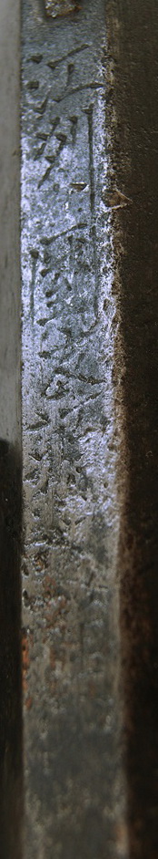

mywei Posted July 8, 2018 Report Posted July 8, 2018 1st pic - Niju Makibari 2nd pic - too zoomed out to see clearly but the first two characters are 江州 or Goushu (aka Omi province) Quote
Bazza Posted July 8, 2018 Report Posted July 8, 2018 2nd pic - OUSHU KUNITOMO ? ? (SAKU?). ? ? = gunsmith's name?? BaZZa. Quote
Bugyotsuji Posted July 8, 2018 Report Posted July 8, 2018 江州国友... 作? Ko-Shu (Go-Shu) Kunitomo Fuji... Saku? Can you take two or three angled shots of the lower two or three Kanji? I have checked the stamp of the locksmith but have not located it yet. Can you show us an overall photo of the gun. (Probably a local Kunitomo gun, but many Kunitomo smiths travelled and worked throughout Japan.) Quote

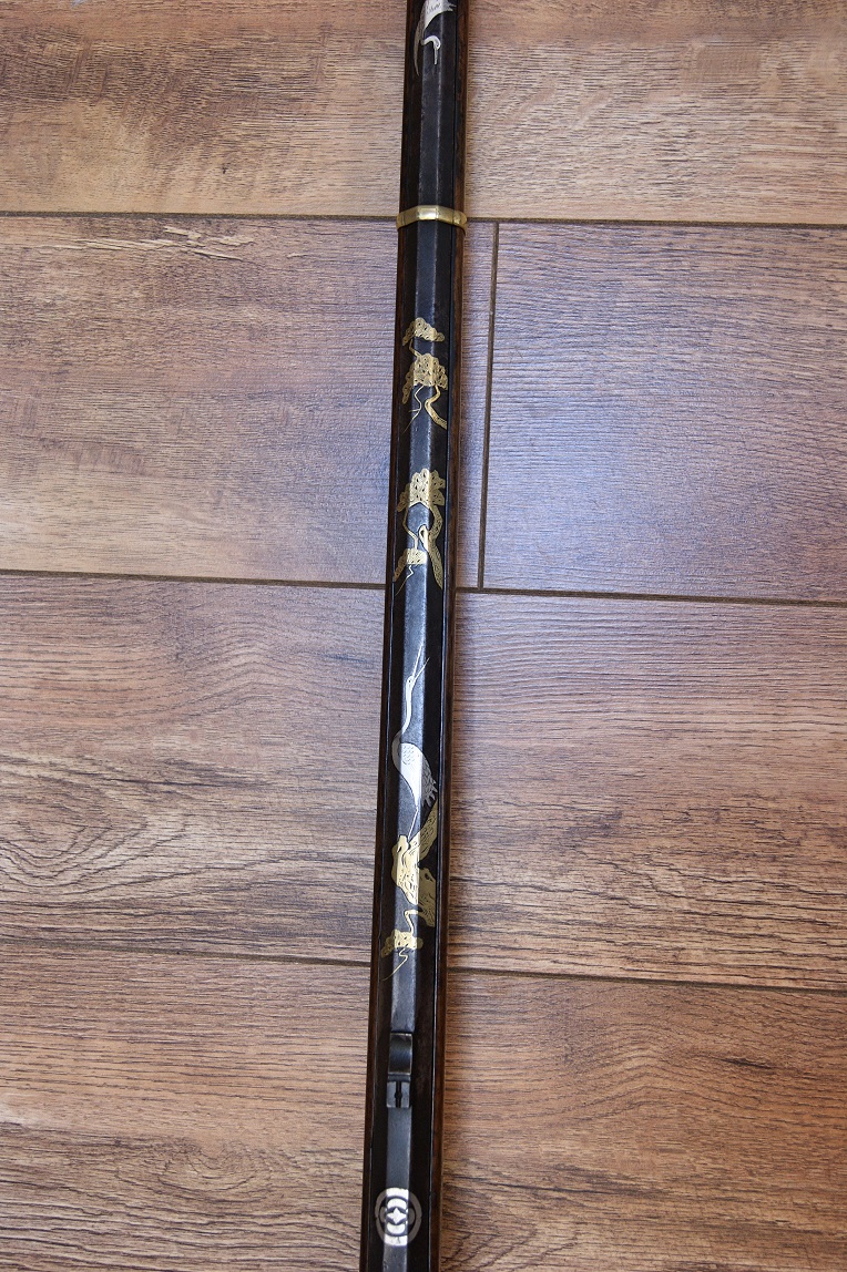

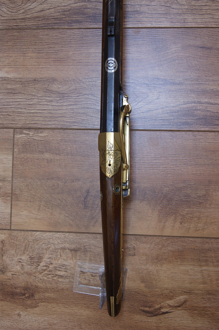

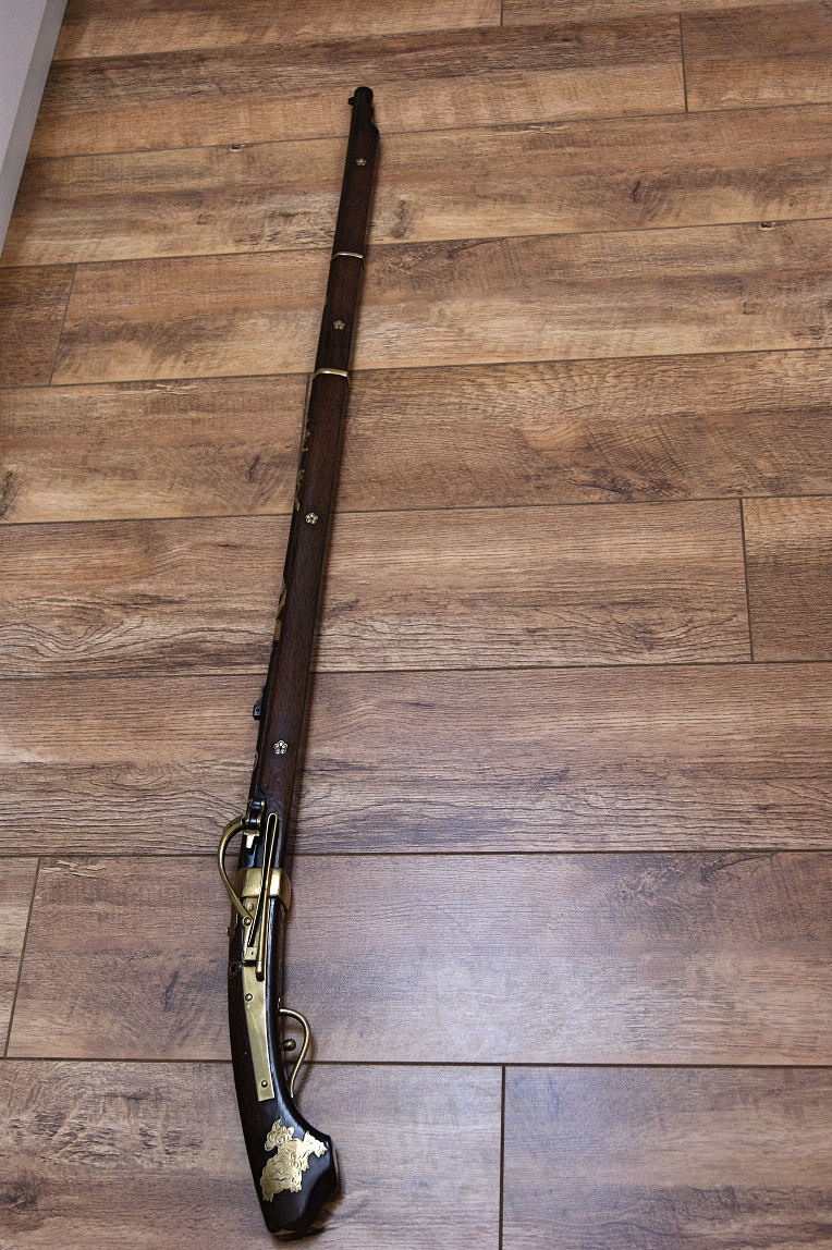

ROY RICKETTS Posted July 8, 2018 Author Report Posted July 8, 2018 Many thanks for all your comments further images are downloaded could anyone possibly give me a date of this gun.Those asking for further specific images these will follow. My thanks again Roy Quote

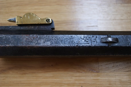

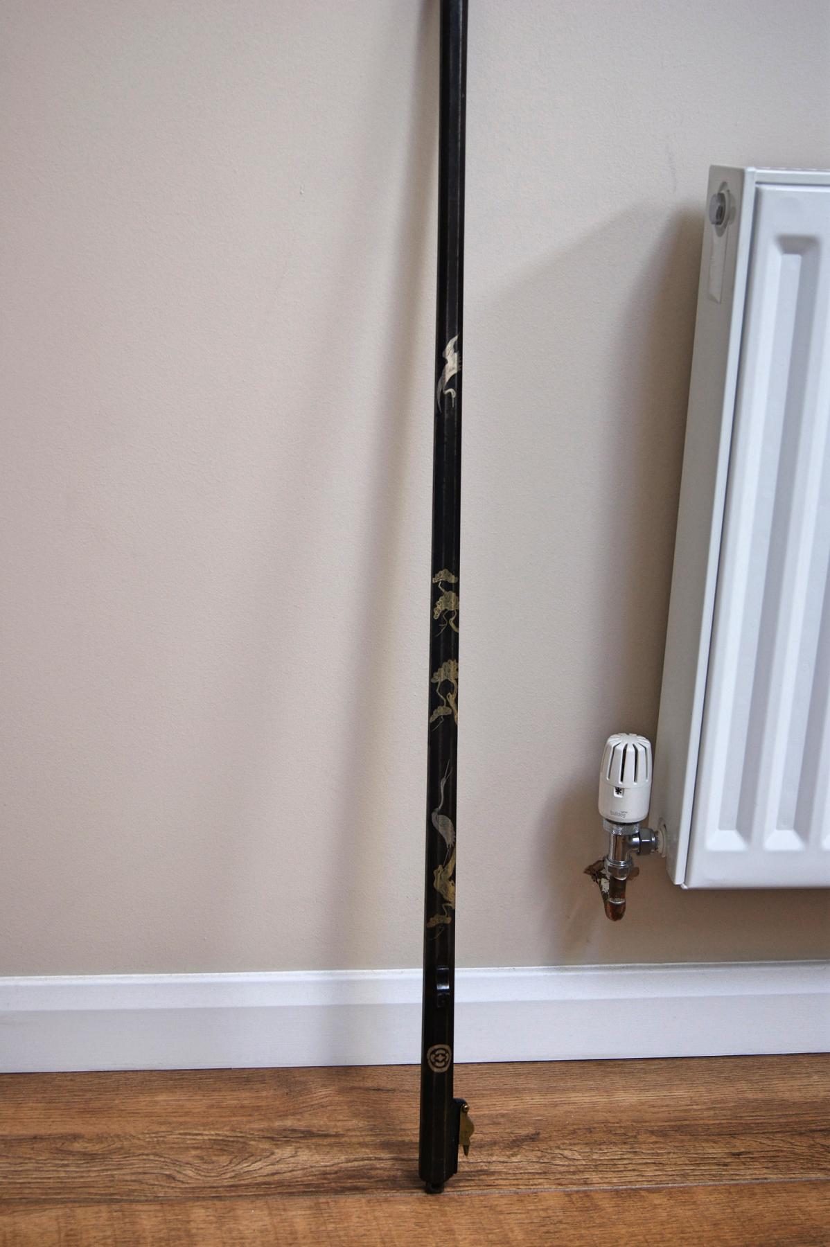

Baka Gaijin Posted July 9, 2018 Report Posted July 9, 2018 Good morning Roy., Could you please post a closeup photograph the Kamon (Silver Circle) at the base of the barrel. It looks like a varient of Maru ni Moko (Maru ni - Contained within a circle Moko - Stylised crest element based upon a Japonica Flower motif). It is the lozenge shape in the dead center that will qualify its full name. Sometimes the Kamon is a direct link to the Clan origin, but more often added to increase its value when sold post 1868. The most common Kamon encountered would be a variant upon the three leaf patterns contained within a circle used by the Tokugawa families. The Kamon (Crest) is also known by the terms Mon, Monshou and Mondokoro Quote

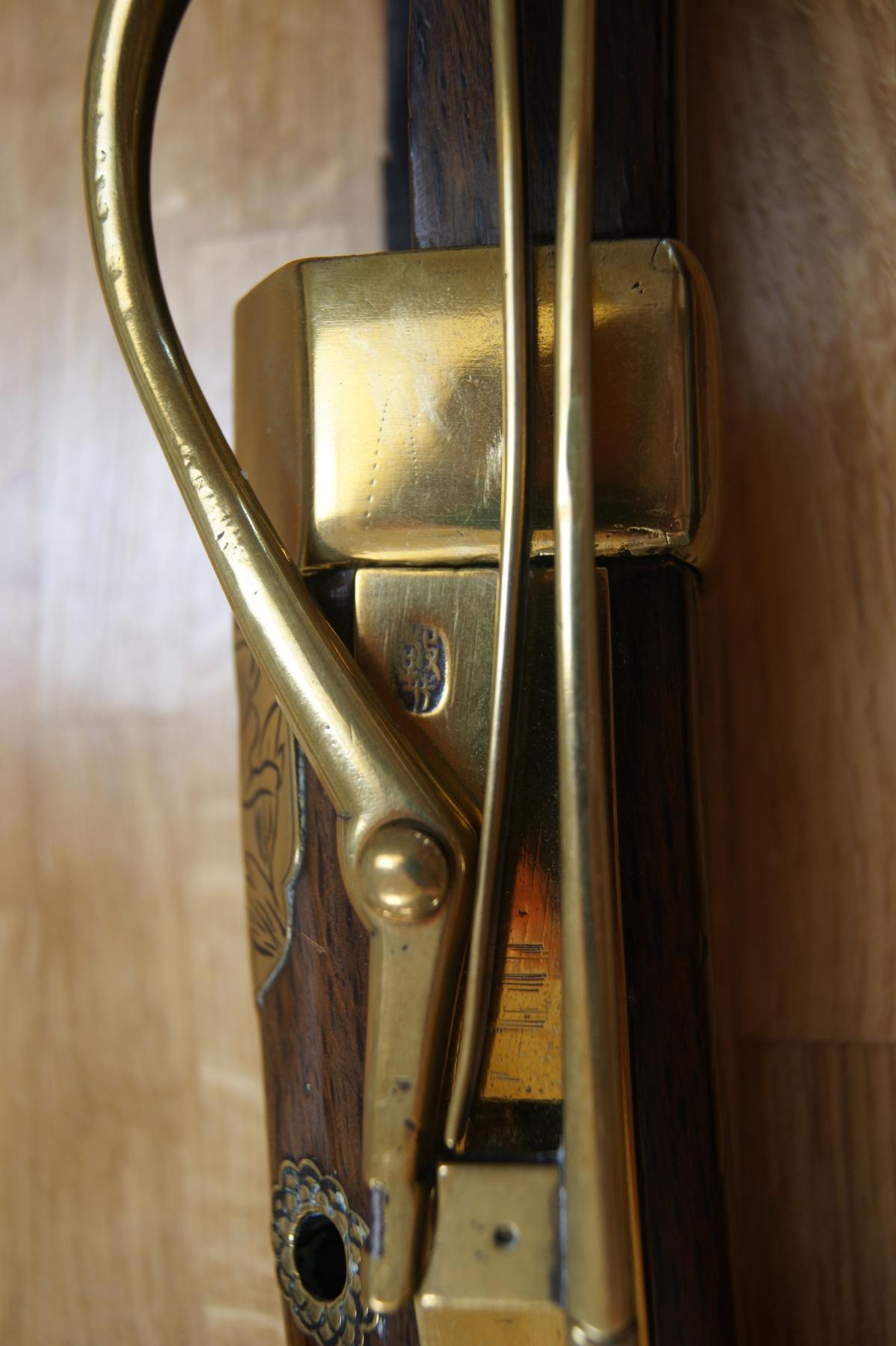

Viper6924 Posted July 9, 2018 Report Posted July 9, 2018 I think this looks like a very health matchlock. Got several features besides the signature that points towards Kunitomo. The caliber looks to be just in the border region between hunting and military grade. I think the decorations at the backend of the gun might have been added later together with the brass bands. As there are four healthy mekugi-pins, these bands are purely decorative. I belive the decoration near the pan is of a sakura flower as are the flowers around the mekugi. This you sometimes see on guns made in the Osaka-region. Perhaps this gun was made in Kunitomo and then shipped off to Osaka to be sold and there getting the added decorations? Nice shape to the pan. Also liking the shape of the rear sight. A very good first buy! Welcome to the club Jan Quote
Viper6924 Posted July 9, 2018 Report Posted July 9, 2018 After focusing in on the pictures I see that the flower decorations is not sakura at all. But it looks nice anyway Jan Quote

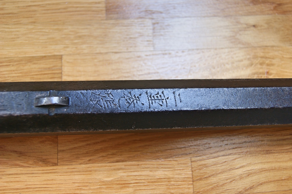

ROY RICKETTS Posted July 9, 2018 Author Report Posted July 9, 2018 Many thanks for your reply sadly I have attached my latest attempt but I am unable to get a better image of the lower of the three kanji as it appears to have been in a vice at some time and it has crushed the characters I have posted several more images of the gun and I have attached an image of the Kamon. Regards Roy 江州国友... 作? Ko-Shu (Go-Shu) Kunitomo Fuji... Saku? Can you take two or three angled shots of the lower two or three Kanji? I have checked the stamp of the locksmith but have not located it yet. Can you show us an overall photo of the gun. (Probably a local Kunitomo gun, but many Kunitomo smiths travelled and worked throughout Japan.) Quote
Baka Gaijin Posted July 10, 2018 Report Posted July 10, 2018 Thank you Roy, The details on the Kamon are not that precise, but there looks to be some indent detail within the four points of the central lozenge. It looks a little like Hanabishi which means flowers or petals in a diamond configuration. So my call is Maru ni Mokko ni Hanabishi. Anyone else? 1 Quote
Justin Grant Posted July 10, 2018 Report Posted July 10, 2018 I think it's a less precise version of the one on my pea shooter. Quote
Baka Gaijin Posted July 10, 2018 Report Posted July 10, 2018 Could be John, what would you call the central lozenge? Takeda Bishi? Quote
Justin Grant Posted July 10, 2018 Report Posted July 10, 2018 Malcom It's a modified Hotta and Takeda deal, the Kuroda Clan also used it. I think it's called a Maru ni Mokkou Quote
Baka Gaijin Posted July 11, 2018 Report Posted July 11, 2018 Good morning Justin, Maru ni Mokkou refers to the outer parts, the usual form of description in the kamon books is to add another ni and then the description of the central lozenge. It may be in one of the Daimyo Bukan, so if we can find the modified Hotta/Takeda Bishi, we should have the correct name for yours. Here's a link to the six volume Daimyo Bukan from 1774 at the National Diet Library. http://dl.ndl.go.jp/info:ndljp/pid/2605727?tocOpened=1 I'll have a trawl through today, pesky clients allowing, and see what comes up. Hi Again John Try Book 2 pages 64,65 & 66 Not exact match, but getting there 1 Quote

Bugyotsuji Posted July 11, 2018 Report Posted July 11, 2018 Sadly that picture on its side refuses to allow me to copy it and then straighten it for better concentration on what is left of the Mei. In order to try and open the Bisen these barrels are often placed under huge pressure and torsion in a massive vice. The result can be a broken Bisen, but more likely unsightly damage to the barrel. A pity, especially as a little thought for wrapping could avoid such damage. Quote

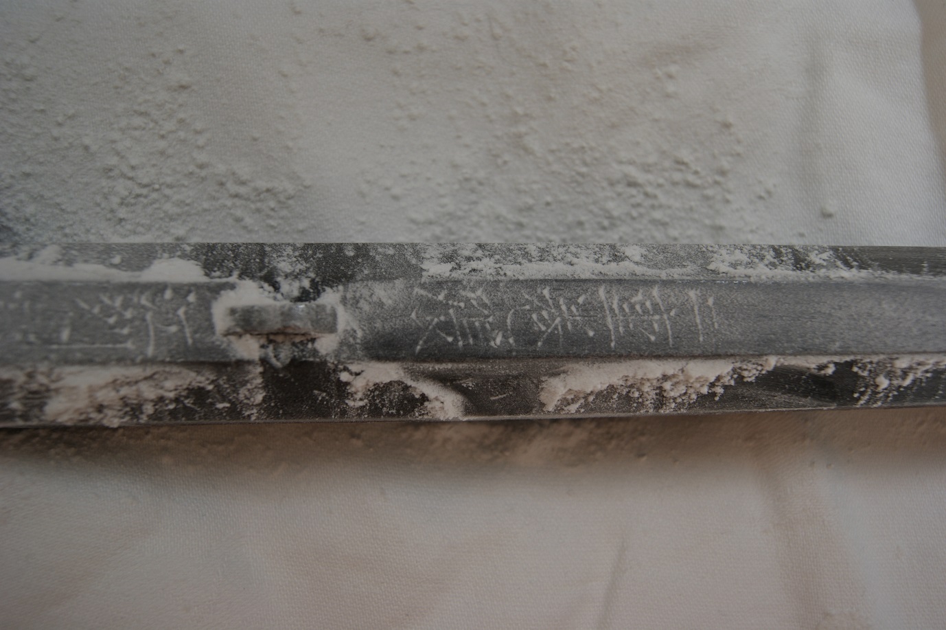

Justin Grant Posted July 12, 2018 Report Posted July 12, 2018 What it really needs to talc powder brushed into the script to help illuminate it. 1 Quote
ROY RICKETTS Posted July 12, 2018 Author Report Posted July 12, 2018 Thank you Justin your input is much appreciated here are the images using your talc method I hope they prove useful! What it really needs to talc powder brushed into the script to help illuminate it. Quote

Bugyotsuji Posted July 12, 2018 Report Posted July 12, 2018 I have narrowed it down to one of about four Kunitomo gunsmiths with quite similar names. Tomorrow I will give you their names and you can decide which you think it must be!?!?! 2 Quote
