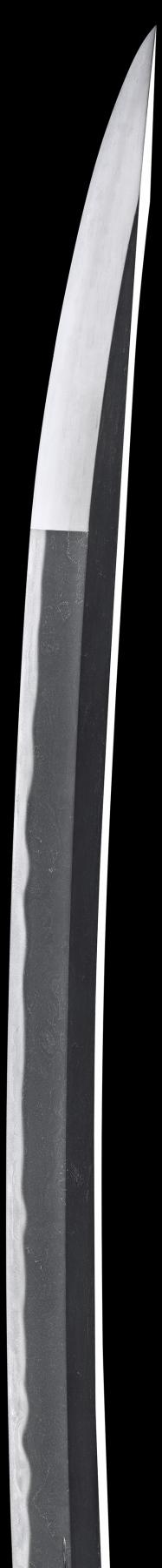

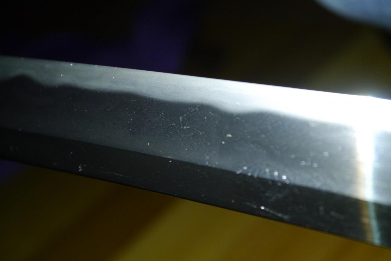

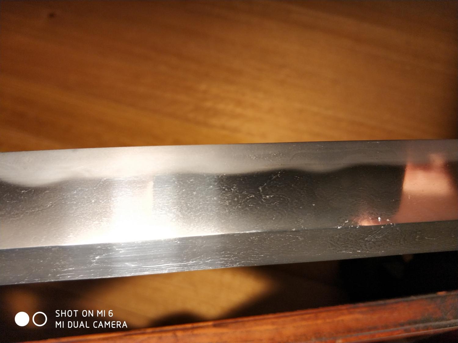

mywei Posted June 29, 2018 Report Posted June 29, 2018 Hi guys, I've attached some photos of a recent acquisition. Please feel free to kantei! Naginata-naoshi katana O-suriage mumei O-kissaki, boshi midarekomi Nagasa 71.3cm Sori 1.6cm I apologise for the crappy photos by the way. Answer released in 5 days 3 Quote

tokashikibob Posted June 29, 2018 Report Posted June 29, 2018 What's that white blotch on the 3rd pic? Camera flash? Quote

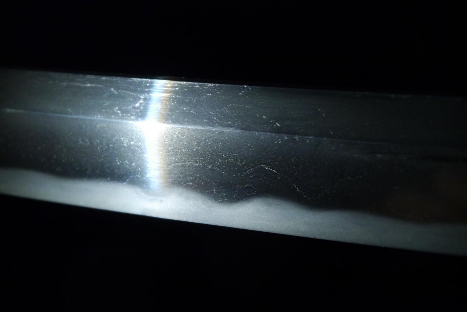

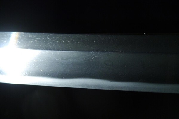

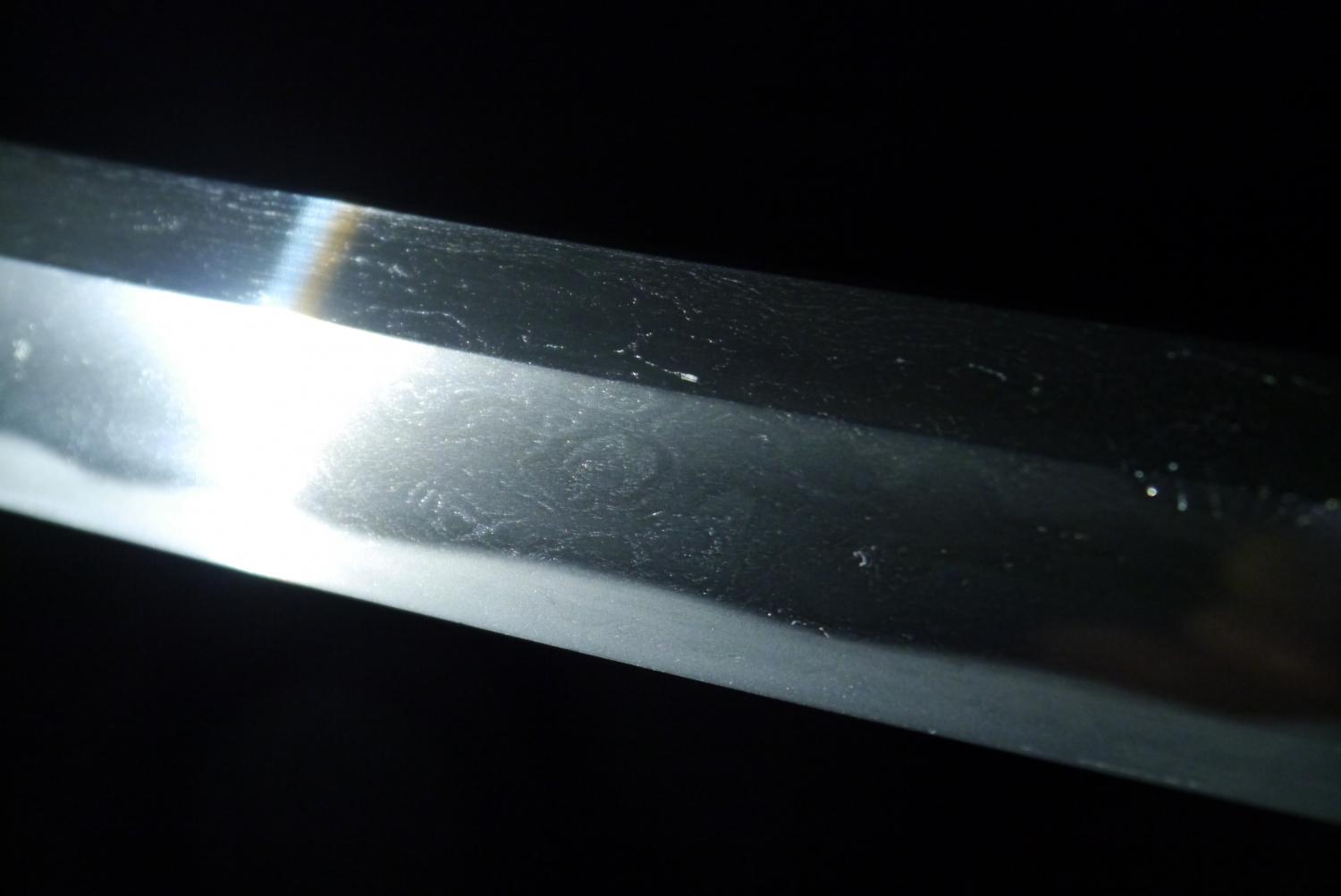

mywei Posted June 30, 2018 Author Report Posted June 30, 2018 Once again - sorry for my bad pics. Quite a wide range of guesses so far....likely due to my picture quality Here's hopefully some better pictures to take a more educated punt! Quote
Guest Rayhan Posted June 30, 2018 Report Posted June 30, 2018 Looking at the new shots, Hojoji is a better call than Naoe Shizu 1 Quote

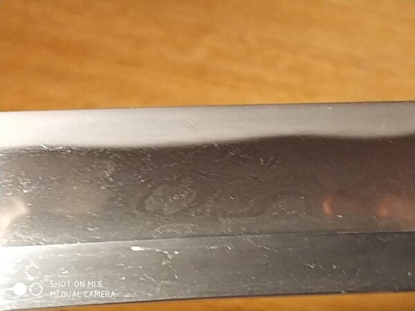

Marius Posted July 2, 2018 Report Posted July 2, 2018 Honestly, gentlemen. We are attempting kantei here with nothing else but a hint of a shape and out of focus pictures? Matt's only decent pics are not his (hey, that is not a reproach, just a fact) and they do not disclose much. The "kissaki" is just a polisher's work, the original shape was probably devoid of yokote. In Matt's pics you see the hadori not the hamon. In the two pics by the seller you see only parts of the hamon. Please let us not make all this a joke. I know we have limitations, but for goodness sake, let us try to do this fun game (because that is what a kantei game is) based on decent pictures. Otherwise it becomes a caricature. Now, I wait for the flak. 7 Quote

Jean Posted July 2, 2018 Report Posted July 2, 2018 I have just been able to upload these pictures because, as every year, I am in vacation/holidays in my countryside house in SW of France (between Cahors and Sarlat). Where Just for fun, I’ll say Soshu tradition, Uda Kunimune (has anyone noticed that when someones mentions UDA, at 99% iis always Kunimune Lol) 1 Quote
mywei Posted July 3, 2018 Author Report Posted July 3, 2018 I apologise for not meeting your expectations and wasting your time Marius. While this wasn't meant to be a joke, it was meant to be only a casual fun kantei, as no one else could hold the blade in hand, and I do not have the skill or access to a scanner or good camera. After seeing some recent kantei threads I thought it would be fun to share something similar, but perhaps it was foolish to do so? Nevertheless, consider me properly 'photo-shamed'. I will certainly curb my enthusiasm and refrain from posting similar content in future for fear for upsetting some of our august members here. Thanks to everyone for having a go. The answer is Kashu Sanekage. Ko-uda would have been the closest guess, as also Hokurido. Hojoji was an intelligent choice. It has many similarities as Tajima was just geographically down the coast from Kaga and this is a naginata naoshi. The ooitame hada and whirlpool hadatachi with chikei and jinie has Norishige influence (and Hokurido) but not quite matsukawa. The nie laden hamon with hataraki is Soshu but the gunome ko-midare again is different and doesn't have the indistinct border of Norishige. Anyways it is a heavy beefy blade and great to hold and look at. Tanobe sensei seemed to also have a positive impression of it on his sayagaki. 3 Quote

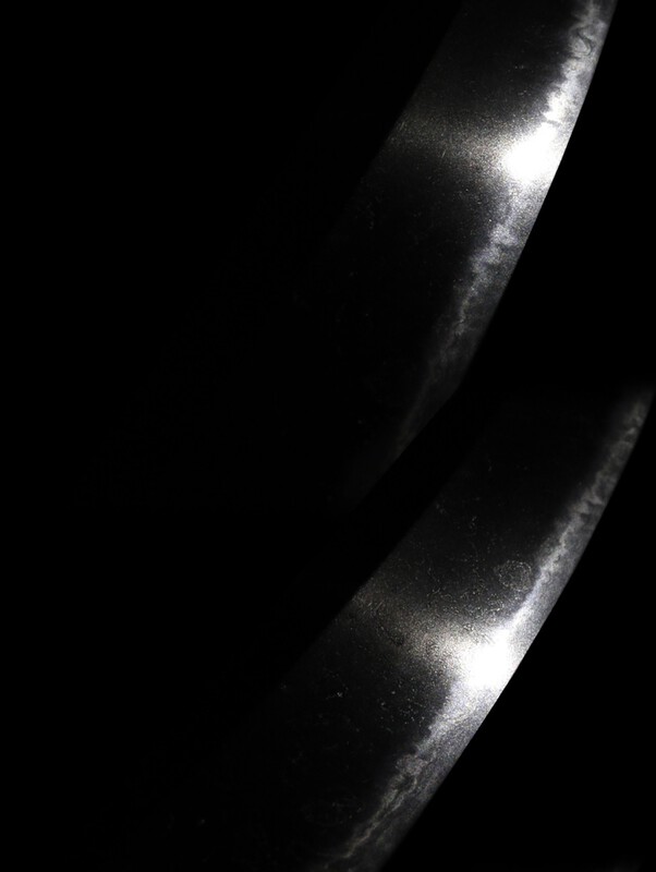

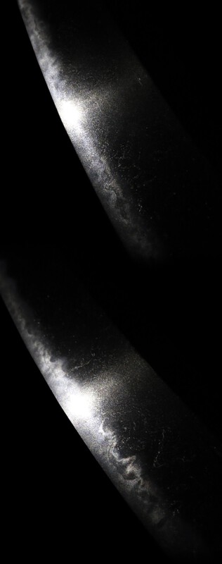

mywei Posted July 13, 2018 Author Report Posted July 13, 2018 I dusted off an old mirrorless digital camera to try to get some better pictures. Nihonto photography is definitely another whole learning curve in itself indeed! Hopefully these poor attempts give more of an idea of the jihada and black appearing jigane that contributed to the Sanekage attribution 1 Quote
