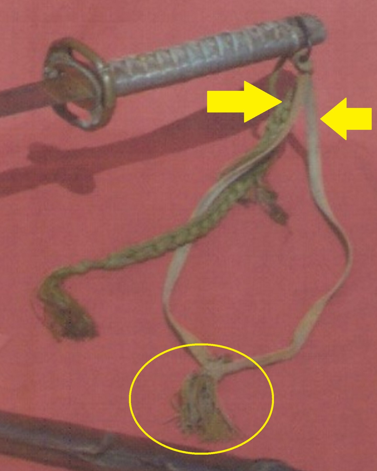

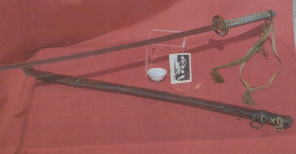

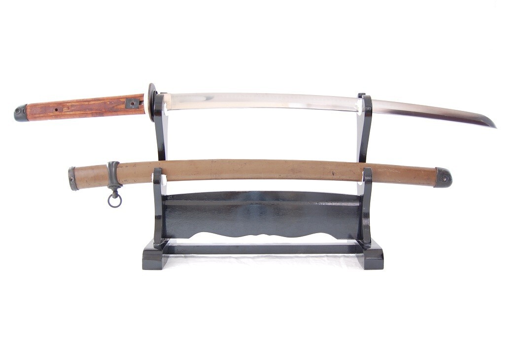

mdiddy Posted July 3, 2023 Report Posted July 3, 2023 4 hours ago, Bruce Pennington said: What say you? Hmm, that's a tough one. I have been looking for conclusive evidence on the tassel, both sides of the cord, and/or the edges of the cord. I zoomed in on this one and the edges may be a little bit of a different color but it's not conclusive. Also we can't see the tassel or both sides of the cord. So, it's a toss-up in my mind, your call. Quote

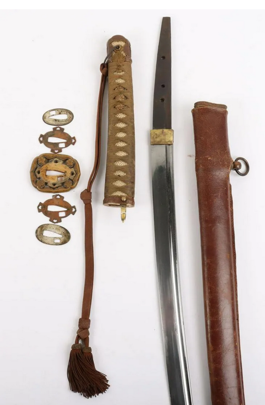

mdiddy Posted July 3, 2023 Report Posted July 3, 2023 @Bruce Pennington Here is one more from Dawson's 1 1 Quote
Bruce Pennington Posted July 3, 2023 Author Report Posted July 3, 2023 1 hour ago, mdiddy said: it's a toss-up in my mind, your call. Thanks for trying. It's the right year, a 1944 Masanori with Gifu and small Seki stamps, so, like the other one, I'll add. As raw data, I'd rather have them accounted for in case they prove useful than going the other way and some day saying "Dang, where was that so-and-so brown tassel we weren't sure about." Quote

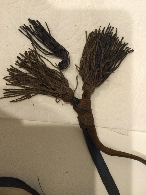

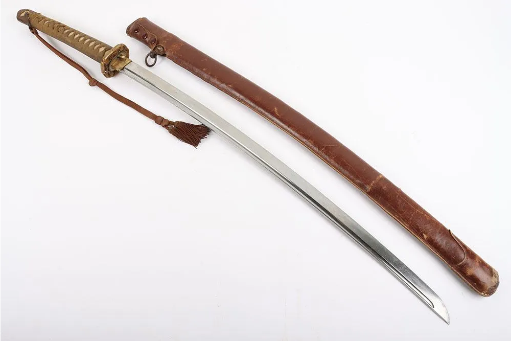

Bruce Pennington Posted July 3, 2023 Author Report Posted July 3, 2023 Just for comparison, here's a Type 95 with officer tassel, that I'd tilt on the side of very faded Company grade. Wanted to call it all brown, but I'm leaning Company grade. Quote
mdiddy Posted July 3, 2023 Report Posted July 3, 2023 14 hours ago, Bruce Pennington said: Wanted to call it all brown, but I'm leaning Company grade I agree - this one is more conclusively not an all brown tassel. We can see both sides of the cord and while faded they are different colors. Also we can see the different shades of tassels, faded blue vs. brown. 1 Quote

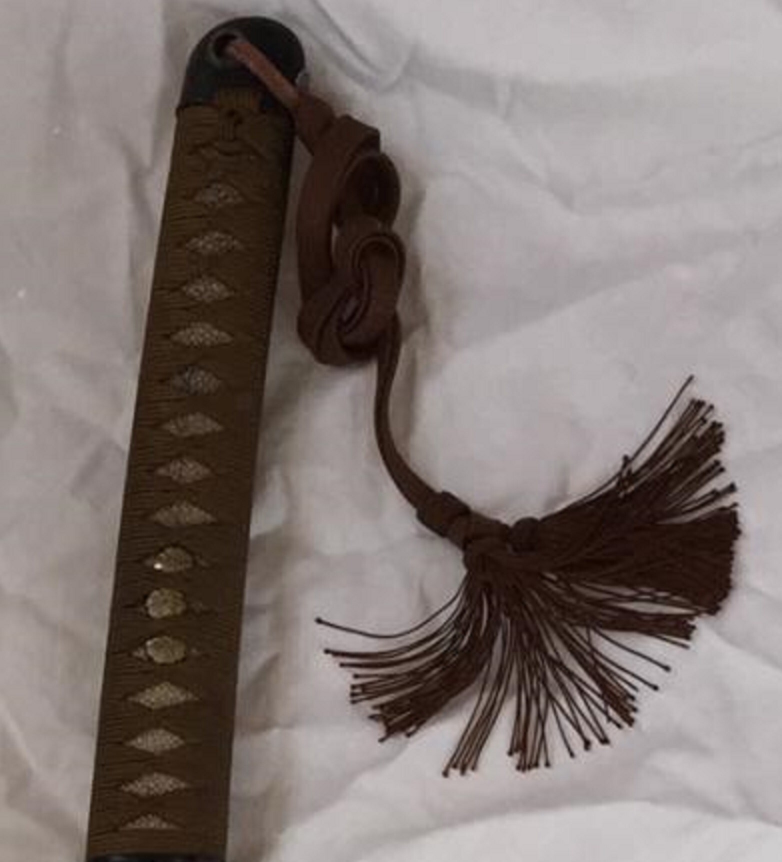

mdiddy Posted July 4, 2023 Report Posted July 4, 2023 @Bruce Pennington Here is another one 1 1 Quote

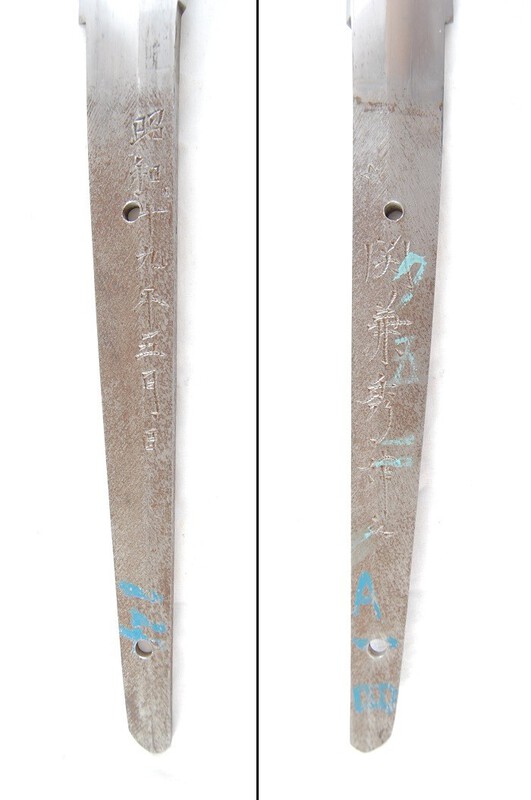

Bruce Pennington Posted July 6, 2023 Author Report Posted July 6, 2023 Another example of how difficult these can be. On an udated, showa-stamped Tofuji blade with the 5 measures hotstamp, found what appeared to be an all brown tassel. But then I found it posted again on another thread and the second photo shows the blue in 2 places: First thread Second 1 Quote

Swords Posted July 7, 2023 Report Posted July 7, 2023 Hi Bruce I’m not sure what your getting at about this brown tassel and what my sword posted has to do with any of this ? steve Quote
Swords Posted July 7, 2023 Report Posted July 7, 2023 I forgot to mention about the hada on my sword post here The hada almost looks like flames Is that unusual for a older sword? And dose anyone have an ideal what period it was made Quote
Bruce Pennington Posted July 7, 2023 Author Report Posted July 7, 2023 54 minutes ago, Swords said: Hi Bruce I’m not sure what your getting at about this brown tassel and what my sword posted has to do with any of this ? steve Steve, We are using this thread to track swords with the all-brown tassel. Yours has one. You'd have to go back to page 1 of the thread to see the debate, but in short, for years, the brown tassel has been called an IJA late war tassel (meaning for active military), but in recent times, Nick Komiya at Warrelics discovered a 1940 Uniform reg change that assigned the brown tassel to Gunzoku, civil branch of the military. I have been charting swords with such tassels in hopes of pinning down a date-range of their use and existance. Quote

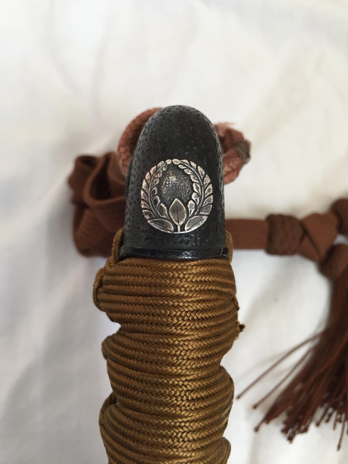

jeep44 Posted July 10, 2023 Report Posted July 10, 2023 Here's a 98 that I've had for many years, that came to me with this brown tassel on it. unusual that the actual "tassels" are missing-apparently cut off. The sword was stored poorly, and the blade is in poor condition-the name on the handle is barely visible through the heavy rust. 1 1 Quote
PNSSHOGUN Posted July 11, 2023 Report Posted July 11, 2023 You do see the tassels ends cut off on surrendered swords now and again. Not quite sure of the significance, perhaps it's the same wheelhouse of defacing Kamon, Chrysanthemum's or family names from various items. 2 Quote

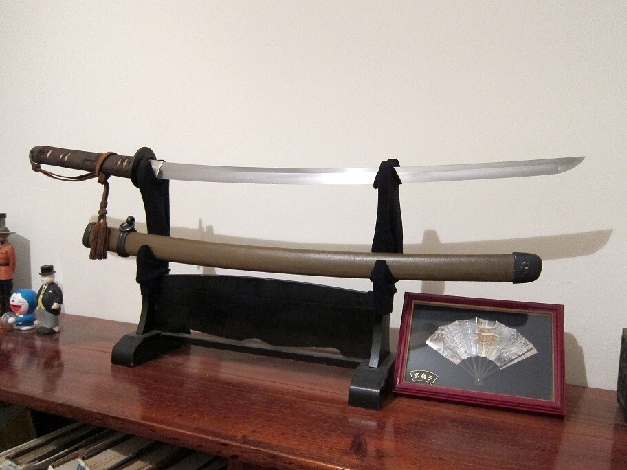

george trotter Posted July 18, 2023 Report Posted July 18, 2023 On 7/13/2023 at 10:23 AM, mdiddy said: @Bruce Pennington Here is another one Just in the interests of accuracy on sword fittings/tassels...I have to say that this sword had no tassel when I got it... I just put one on (briefly) for a photo. Sorry. BTW the balde is a star stamped example by Nakata Kanehide of Seki dated 1944...VERY good smith. I am just wondering out loud but probably? a gunzoku would not be able to buy a RJT blade from an Army Kokeisha store?...probably sales were limited to Army officers and not permitted to "attached" civilian type gunzoku officers (doctors, engineers, admin guys etc)....one for Bruce to investigate? Regards (sorry again I put a tassel on a sword without knowing what tassel it should be). 1 1 Quote
