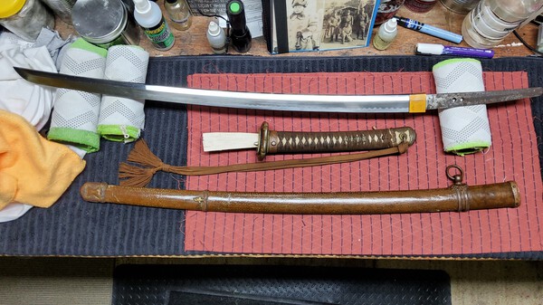

One of my 98's, came from auction with brown tassel (54 cm). Blade and seppa had what I believe was cosmoline so a period touch.
Mumei...oil quenched. Two ana and nice habaki & seppa.
Unusually, it sports a brown samagawa (ray) covered saya (nice) and I have always believed the original tassel was matched to the sword post war...but who knows.
Another for your thoughts.
Rob

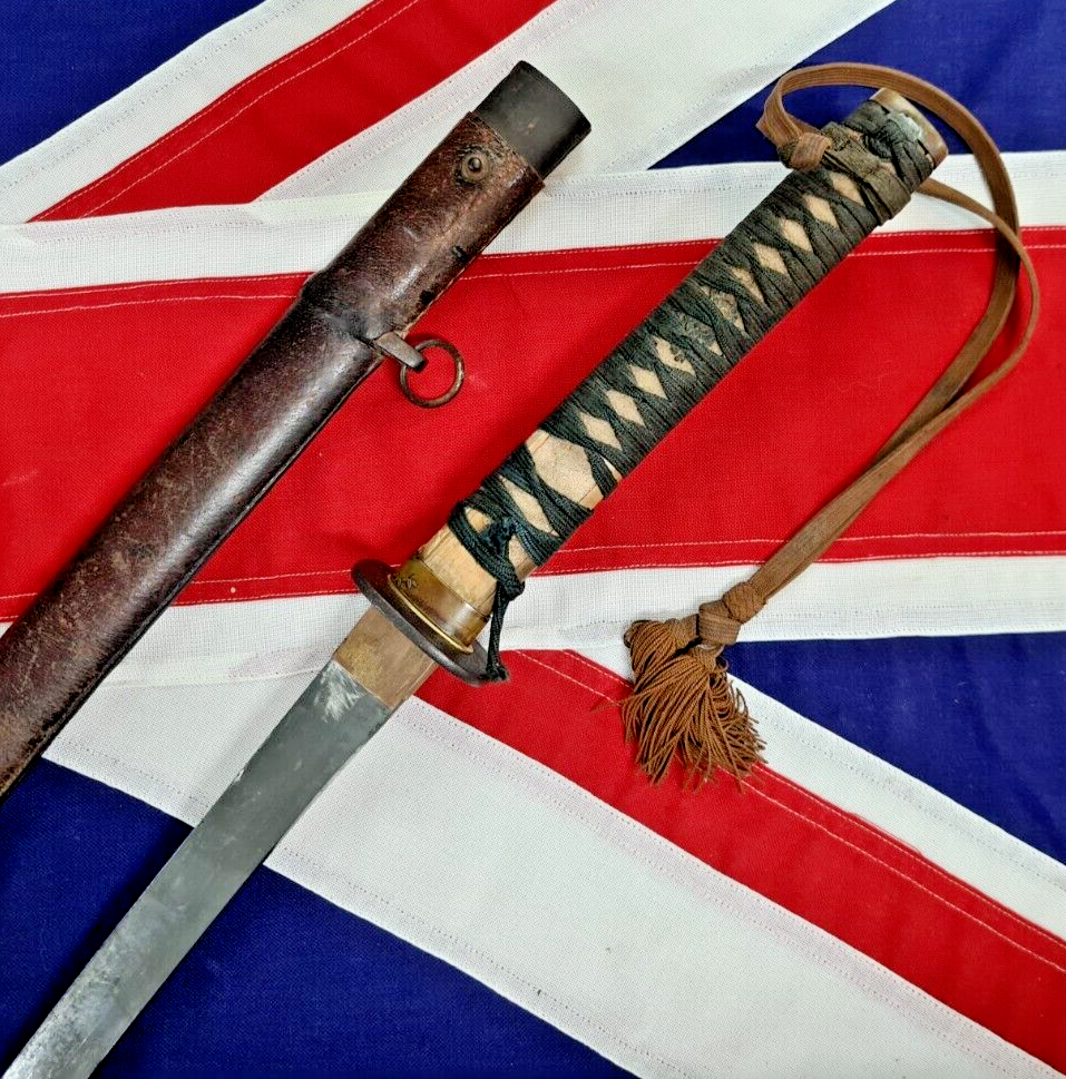

FY Interest, brown tassel on civilian (late war) sword .....more pics on Ebay Australia at moment.
1930s IJA Japanese Officers Army sword with tiger pommel & brown tassel knot | eBay
Description includes "Overall sword measures 95cm (not including scabbard) and has a Japanese officers, brown Showa 9 shin-gunto late war Type 94 tassel sword knot for all officers ranks. Checkout my other militaria as i do combine shipping."

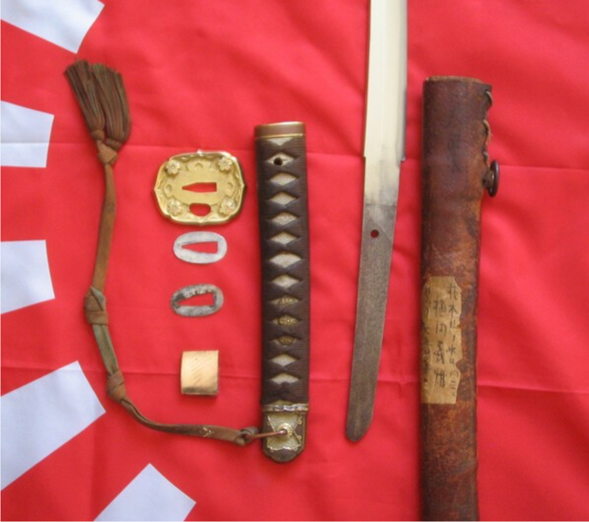

Just came across this one, John.  Justin, @Mortis posted with this explanation, HERE.
"Here’s one. All of the other fitting numbers match, so I can’t imagine the tassel isn’t original as well. This sword was found wrapped in a blanket in the rafters of a barn in Pennsylvania. Those that I obtained it from weren’t collectors. With that in mind, I highly doubt it was added at a later time."
