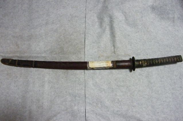

bigjohnshea Posted June 18, 2018 Report Posted June 18, 2018 Dear Fellow Collectors, Hope you are all good. Hoping to get some advice from you all about cleaning up a blade myself. https://www.ebay.com/itm/Japanese-samurai-sword-katana-with-koshirae-tsuka-tsuba-/123183169971?nma=true&si=RKKWZP2A9GTVpzekT9%252BbWeIMNak%253D&orig_cvip=true&rt=nc&_trksid=p2047675.l2557 I’ve been collecting nihonto, and nihonto books for a good long while, and I have employed professionals to do restoration work in the past numerous times, but I would very much like to try and clean (just clean, not restore, not polish) this sword and koshirae myself. I envision the following goals, and would gladly take advice from anyone who has knowledge of how to achieve these: Clean as much of the rust off of the blade as possible without damaging the jacket steel. —In my mind, sandpaper, wire brushes, steel wool, etc. are NOT options. Those options would certainly be quick, but they would potentially compromise the jacket steel and disfigure the blade. —I am hoping to find some advice about specific chemicals, oils or electrolytic processes, etc. that can be used in combination with “elbow grease”, to slowly work away the rust on the blade and fittings. Ideally these would be chemicals and oils that will not end up “acid etching” the blade in the process. —Electrolysis to remove the rust may not be possible because I don’t want to remove the rust from the nakago, and submerging the entire blade in order to remove the rust on the blade via electrolysis would probably result in that. Submerging it in part could be possible...? I will likely end up leaving the saya the way it is with the exception of cleaning up the kojiri as described above, and the koiguchi as described below. —Do you think I need to remove the kojiri to do this? It seems I would need to given the amount of rust it has picked up, but perhaps not. —I would appreciate any advice about removing the kojiri and reapplying it after cleaning, if people think that is necessary. I will likely keep the tsuka wrapped the way it is. I like the old worn look that it has, and I don’t want to try and do much with that. It looks like it is still tight and was well made at the time. Cleaning the menuki a bit would be nice but if they’re impossible to get out then I’m not going to fuss with it. I would appreciate any advice people would offer about cleaning up the tsuba. I don’t need it to sparkle or be shinsa worthy, but it would be nice if the details of it were a little less obscured. I suspect in this case that just a little bit of cleaning with the right polishing product and an appropriately thick rag would get me to the goal, but I have never really done anything like this myself so I don’t know what the best approach is. The habaki, koiguchi, fuchi, and kashira I think similarly to as the tsuba. I do not have any interest in trying to remove the kashira to clean it. As a point of clarity: I do not think of this blade as a project for the purposes of fixing it up and getting it ready for shinsa. I already have a Nidai Muramasa tanto (passed NTHK-NPO by Miyano, now in line for NBTHK shinsa) and a Ko-Gassan tachi (again, passed NTHK-NPO by Miyano, now being polished by Usuki sensei) so I have enough projects, and I know the difference between a Juyo candidate and a nice old blade that deserve to remain a nice old blade. From what I can see in the photos the seller provided, this is not a gem of a blade anyhow but it is nihonto. It is not a premium length, certainly made later than Shinto, maybe even Edo and maybe in the original koshirae, though I can’t quite tell if the tsuka has two holes in it or just some damage next to the mekugi. I can see a hint of notare in what little is visible of the hamon, obviously mumei, maybe a little bit of machi-okure, has been polished a few times in the past given the declining notch at the hamachi. The end goal here is to make the sword into a respectable but NOT mint condition, NOT shinsa worthy, example of an old working blade. I don’t want to make it into a museum piece here folks, I just want to honor it by getting it back into appreciable condition, preserve it further, and not have to spend thousands of dollars doing it. Any advice you might have to help me achieve this goal would be appreciated. Thank you! John A. Shea, MD Quote

bigjohnshea Posted June 18, 2018 Author Report Posted June 18, 2018 I don’t have them right now. Just the ones the seller offered on ebay. Will post some in a few weeks when the blade arrives. Probably will be 3 weeks though... Any thoughts on non-abrasive methods to get rust off a blade? Quote
Brian Posted June 18, 2018 Report Posted June 18, 2018 There aren't any John. If there were, we would all be doing it.Oil and wipe...repeatedly.Over a long time. And uchiko (only on very out of polish blades) over many months. That's about it. 2 Quote
bigjohnshea Posted June 18, 2018 Author Report Posted June 18, 2018 Ok. Thank you Brian. Has anyone ever tried CLR? Or is that too acidic? Quote
bigjohnshea Posted June 18, 2018 Author Report Posted June 18, 2018 https://www.mystonecare.com/Lithofin-Rust-EX-p/lith-rust-ex.htm I may try this on another rusted steel before hand. Seems like it could be a good option...?? Quote

ROKUJURO Posted June 18, 2018 Report Posted June 18, 2018 As Brian wrote: There are no products on the market that an amateur could use without damaging the blade. There are of course chemicals to transform rust into something less aggressive, but they are good for garden tools, cars, iron bridges and towers a.s.o..Take a moment to think about what rust is: Rust is iron (element Fe) that has turned into a chemical compound (rust = Fe2O3) together with oxygen (element O). Rust is not something that covers the clean iron/steel like a layer of dirt - the iron surface itself has partly turned into something else. If you could remove the rust completely, the surface would be coarse and look probably like a natural stone, depending on how deep the rust has worked itself into the steel. Or you could say: How deep the oxygen had been allowed to attack the steel, chewing up Fe molecules and turning them into rust. Bringing a rusted blade back to a state where you could see the HATARAKI and HADA will always mean that you have to remove some of the steel surface until you have a clean, level and very even metal surface. THEN - and only then - you can start to restore the blade. Not easily done and nothing for non-trained people. 1 Quote
DanielGJ Posted June 18, 2018 Report Posted June 18, 2018 Hello John, another option is not to spend more money on pieces that have no arrangement and save it for when you can buy a piece in good condition, I say it as a tip because that katana without a polishing will look bad, I have restored some piece in better state than that and neither the hamon nor the fairy is appreciated, it will simply look like an old katana. A greeting to all Daniel. Quote
SAS Posted June 18, 2018 Report Posted June 18, 2018 What Jean said above is correct. The reason there are so many out of polish blades on the market is that it is not economically feasible to have them professionally restored. Trying to restore them nonprofessionally is just contributing further to their demise. Don't do it. Quote
PNSSHOGUN Posted June 18, 2018 Report Posted June 18, 2018 Save your time and money for something more rewarding. Quote
Ken-Hawaii Posted June 18, 2018 Report Posted June 18, 2018 Looking at those photos, John, I have to agree with everyone else. Don't do it, & get your money back if at all possible. Quote
