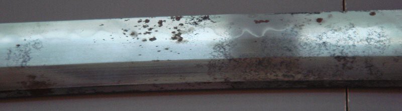

Bobcat Posted June 9, 2008 Author Report Posted June 9, 2008 I was reading some of the sword care threads. Some of them mentioned using isopropyl alcohol for removing old oil. What effect would that have on rust spots like the following? Is there anything else that could be used on these spots to remove the rust or improve the appearance of the sword? A bit of trivia: The Japanese masters wouldn't have used isopropyl alcohol on their swords. Isopropyl alcohol was developed commercially in Linden, New Jersey, in 1920, and was the world's first commercial petrochemical. I don't think isopropyl alcohol exists in nature. Quote
Gabriel L Posted June 9, 2008 Report Posted June 9, 2008 Isopropanol (isopropyl alcohol) is a very good solvent for oils without affecting steel directly. Be sure it is >99% as you want as little water content as possible. The isopropanol proper will evaporate extraordinarily quickly, but even strong (70-90%) solutions will leave water streaks. On that note, if you order/buy it and it comes in a plastic bottle, transfer to glass if you can for longer-term storage. It will instantly suck water out of the atmosphere if you leave it exposed, so it's always diluting itself; I'm pretty sure it can manage this trick through plastic somehow as well. Most importantly, be aware it is a fire hazard and I'd wear gloves as it is absorbed through the skin (and converted by the liver into acetone). It's also volatile, so work in a well-ventilated area and don't deliberately gulp down the fumes. Not trying to be scary. It's great stuff, I have a bottle for cleaning as I think it's better for a brand new polish than an amateurish application of uchiko (if you insist, then use only really nice uchiko, and that very gently). Just be aware. On to your actual question: isopropanol will, in theory, dissolve some amounts of iron oxide (including red rust, Fe(2)O(3) where the parentheses indicate subscripts). It's not magic and it won't replace a true professional polish, but it's technically better than nothing. So I'd go ahead and try it. I've heard an account or two of surprisingly good results. But again, its true purpose in this field is as a solvent for oil, not for removing rust. Oh, and of course do NOT get it on the nakago. Quote
