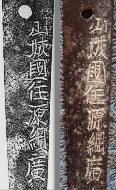

Bobcat Posted May 14, 2008 Report Posted May 14, 2008 My father died recently, and I have a sword he brought back from Japan in WWII. I posted these pics on another board, and it was identified by someone there as mei Yamashiro-no-kuni Ju Minamoto-no-Tsunahiro, being made circa 1673-1688. The length of the blade is approx 29". It's also in a cloth sheath, which I'm told is authentic. That other message board is for Japanese firearms, not swords. I found you guys, so I hope I can get more information here. I'd like to know more about the sword. Specifically: Can someone give me a rough idea of how much it's worth? Basically a guess? Does anyone know a local expert I can take it to for inspection/appraisal? I'm in New Jersey (USA). I don't intend to sell the sword, but would consider having it polished if it would help preserve it. Also, please be gentle with me, as the terminology is completely new to me. Quote
huntershooter Posted May 14, 2008 Report Posted May 14, 2008 I'd contact Moses Bacerra in NYC re. polish. He may provide you with some insight as to blades worth as well. Quote
Gabriel L Posted May 14, 2008 Report Posted May 14, 2008 Hi Bob, First of all, congratulations on what looks to be a nice authentic nihonto in reasonably good condition (for a WWII bringback). I have just one question: what's with the color of the mei (signature)? Has it been enhanced with some talcum powder (ok), or is the patina actually stripped (bad)? Before you do anything else at all, Please check out Dr. Stein's Japanese Sword Guide (http://home.earthlink.net/~steinrl/nihonto.htm) specifically the articles on DOs/DON'Ts (http://home.earthlink.net/~steinrl/care.htm) and more in-depth maintenance (http://home.earthlink.net/~steinrl/care/handling.htm). THE MOST IMPORTANT RULE: don't try to polish or "fix" the blade yourself as you *will* ruin it, probably permanently. It would be far better to maintain it as it is now than to attempt an amateur "polish." Other than that, just keep it clean, don't try using it, avoid touching it with bare skin (bad for the blade, possibly bad for you ), etc. I confirm the signature as Yamashiro Kuni ju Minamoto Tsunahiro. This essentially means Tsunahiro of Yamashiro province made the blade (Minamoto is a surname). Hawley's "Japanese Swordsmiths" lists this smith as signing with a variety of signatures, including this precise one; he is placed at 1673-88. Hawley's rates him at 15 points which is somewhat meaningless since he rates a lot of smiths around that level. There is a single note of "wide suguba" meaning that the hamon (hard white edge steel pattern from differential hardening) is straight(-ish) and wide. Hawley's also states that he is the "same as Ise Yoshihiro," which is a little interesting as Ise Yoshihiro (2nd gen) is listed to have worked around 1716. So apparently the smith moved from Yamashiro to Ise? Assuming this information is valid. This doesn't mean a great deal about the quality of your particular blade, but is a good context at least. From the single photo you gave of the blade itself, and the measurements, it looks good; 29" is a long katana blade, which will enhance the value as many of that length have since been cut down somewhat. And the early Edo period is not a bad one for quality (better in general than the preceding Muromachi period for sure). We will definitely need a wider variety of much more detailed photos before anyone can really comment on the quality however. Closeup photos of the point, the overall nakago (tang, from top to bottom including the notches where the blade starts), some closeups of the hada (grain in the steel surface) and hamon (white edge steel), overall pics of the blade from both sides (bare, and as un-distorted as possible), etc. Try to make sure there is enough light to bring out all the details; I like late afternoon light coming in from a window to make things pop. That is a very primitive photography strategy and we don't expect you to be an overnight expert in revealing every subtle nuance, but try your best anyway. Do NOT use a flash, use a tripod if you have one. Do not shrink the resultant photos down to tiny thumbnails if you can help it; medium-sized photos (about the size you posted) with links to higher-res photos are a great bet. At any rate I think from the photo you have that it should be restorable; however, such can be very costly, around $80-100 USD per inch of blade edge. Still, that would be the only way to fully appreciate the artistry of the steel and best preserve it for the future. But do look into bringing it in person to a Japanese sword club or polisher (Moses would absolutely qualify on that front). They will be able to tell you more than photos could. And depending on the state of any rust, it could be enjoyed and maintained as-is without a brand new art polish. And welcome to NMB! Quote
Guest reinhard Posted May 14, 2008 Report Posted May 14, 2008 There were many generations of smiths signing "TSUNAHIRO" between early 15th and later 19th century. This particular signature might be a match with a TSUNAHIRO most active during Genroku-period (1688-1703). The signature of your sword is not too far from the only comparable mei I found by quick research. Here it is for comparison. Other members might come up with additional infos. reinhard Quote

Jacques Posted May 14, 2008 Report Posted May 14, 2008 Hi, Toko Taikan lists one who signed also Omi no kami fujiwara Tsunahiro; he worked in Enpo Era (1673-1681). Rated 2 millions yen. Quote

Brian Posted May 14, 2008 Report Posted May 14, 2008 Hi Bob, We all wish No..the yen ranking system is just a rating system used in the books. Basically it gives an indication comparatively vs other smiths. It isn't a literal value. I also don't think this is your smith. Yours might be gimei (a false signature often used to make a sword seem more desirable) but it could be from one of the other Tsunahiro smiths. All in all, I think the mentioned value of around $2K is a fair one, unless there is a problem that reduces it. Regards, Brian Quote
Jacques Posted May 14, 2008 Report Posted May 14, 2008 Hi, Quote Jacques, 2 million yen is US$19,000. Are you saying my sword could be worth that much? Perhaps if in perfect condition... Don't dream Bob, Toko taikan applies a yen value as others attribute points; it is purely virtual, this smith is not highkly ranked in regard of Tomonari (35 million). Quote

Jacques Posted May 14, 2008 Report Posted May 14, 2008 Hi, Fujishiro also lists this smith and wonders if he can be from the Soshu line. About the mei, i don't think it is gimei, the way of engraving looks very similar, atari match and it is not a big name. Quote
Bobcat Posted May 14, 2008 Author Report Posted May 14, 2008 I see that Moses Becerra is Vice President of the New York Metropolitan Japanese Sword Club. Do you know if he'd be able to look at it if I brought it to one of their meetings, or should I just take it out to Long Island? Also, I really don't understand the mei: Yamashiro-no-kuni Ju Minamoto-no-Tsunahiro What do the various words mean? One is a location? Does one identify a particular individual, or is it the name of group of swordsmiths? Quote
Jacques Posted May 14, 2008 Report Posted May 14, 2008 Hi, Yamashiro no kuni = Yamashiro province Ju = living in Minamoto = family or clan Tsunahiro = swordsmith art name should be read like this; Minamoto Tsunahiro living in Yamashiro. Quote
Brian Posted May 14, 2008 Report Posted May 14, 2008 Bob, By all means, drop him an email and ask his recommendation. I would think they would be happy to have you bring it in to one of the meetings. He is a decent and well known guy. He might even know someone closer to you. Regards, Brian Quote
Brian Posted May 14, 2008 Report Posted May 14, 2008 I agree with Jacques, it is a close match, and looks shoshin (genuine signature) to me. Brian Quote

Guest reinhard Posted May 14, 2008 Report Posted May 14, 2008 Brian said: I agree with Jacques, it is a close match, and looks shoshin (genuine signature) to me. The mei in the Toko Taikan shown by Jacques (which can also be seen in Fujishiro's "Nihon Toko Jiten") is so very similar to this one, it's almost scary. - Anyway the sword should definitely be shown to an expert. There was a minor confusion about biographical infos. Fuijishiro and Iimura give the same informations: He was originally from the Tsunahiro-school in Sagami, lived and worked basically in Kyoto, but also resided in Ise province. His most active time was Enpo era (1673-1680). Fujishiro mentions the title "Omi-no-Kami". Iimura does not in vol.1, but in vol.2 the Shinto Meikan lists one of his signatures as "Omi-no-Kami Minamoto Tsunahiro" and gives Genroku (1688-1703) as his most active period. He also signed "Ise Yoshihiro". My guess: He was an offspring of 5th mainline generation Tsunahiro (Ise-Daijo Tsunahiro), who died Genroku 11. Since he wasn't the heir of the Tsunahiro tradition, he exiled to Kyoto (and Ise) reinhard Quote
Brian Posted May 15, 2008 Report Posted May 15, 2008 Thanks for the additional info Reinhard. I think you and Jacques have this one locked down. This is one of the few mei that I have seen where I can honestly say it is almost a perfect match. I would be surprised if it wasn't shoshin to this smith. I think we finally found a shoshin mei! :lol: :D Nice work guys. Odd..since we are supposed to be famous for not assisting newbies all that much. :lol: Brian Quote
