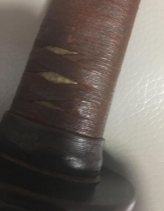

dwmc Posted July 27, 2020 Report Posted July 27, 2020 On 7/25/2020 at 7:58 PM, Bruce Pennington said: Dave, Actually, the "type 3" or Contingency model (Rinji-seishiki), was designed with the lower ana being filled with a screw. They have a thin metal plate on the other side for the screw to attach to. The upper ana takes a mekugi. I'd say 80% of these are lost through time, so people replace them with mekugi. I usually see them for sale with a mekugi in the lower ana and the upper ana empty (likely because someone has removed the upper one to replace the missing screw. Here is one with the ito and same' gone, showing the square where the metal plate fits (missing on this one. A Bubba had put a bolt and nut in it, along with naugahayde for handle wrap!) Hey Bruce...when exactly is snipe season in Colorado...maybe I can join you for a hunt one day!! Dave M. Quote
Bruce Pennington Posted July 27, 2020 Report Posted July 27, 2020 On 7/27/2020 at 4:48 PM, dwmc said: Hey Bruce...when exactly is snipe season in Colorado...maybe I can join you for a hunt one day!! Dave M. I've tried, and tried, but I can't figure out the joke, Dave. I know a snipe hunt is a joke guys play on rookies, but I'm lost with the reference, here. Quote

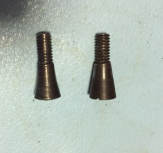

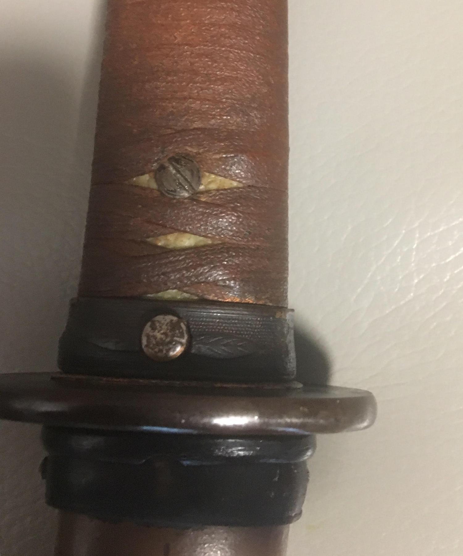

Bruce Pennington Posted July 28, 2020 Report Posted July 28, 2020 Ok, this is what you are seeing in my Rinji. It's an original WWII screw made for the Rinji tsuka. Mine was missing the screw, and I got one from Neil. The Bubba-bolt was on another Rinji. 2 Quote
Bruce Pennington Posted July 28, 2020 Report Posted July 28, 2020 On 7/28/2020 at 2:29 AM, lambo35 said: I am a bit confused, is the lower mekugi ana the one closer to the nakago giri or the tsuba? Are not all references to upper/lower made with the blade up as one would hold it if reading the signiture? Thanx for the clarification. Sorry Chuck, I knew I was going to cause confusion when I chose those words! The screw goes in the ana closest to the tsuba. Mekugi is closest to the kabutogane. 2 Quote
george trotter Posted July 28, 2020 Report Posted July 28, 2020 I have seen rinji with A...2 screws, each entering from the opposite side. B...1 screw / 1 peg types C.. 2 peg types. Screw types always have a 'threadless nut' as a rest for the screw head at the screw head end and a threaded nut at the threaded end (usually hidden by the same/binding)...this is so the screw (if over-tightened) will not crush the wooden hilt. Hope this helps, 4 Quote
IJASWORDS Posted July 28, 2020 Report Posted July 28, 2020 This is a typical lower screw design, screw head one side, no corresponding hole the other. 4 Quote
