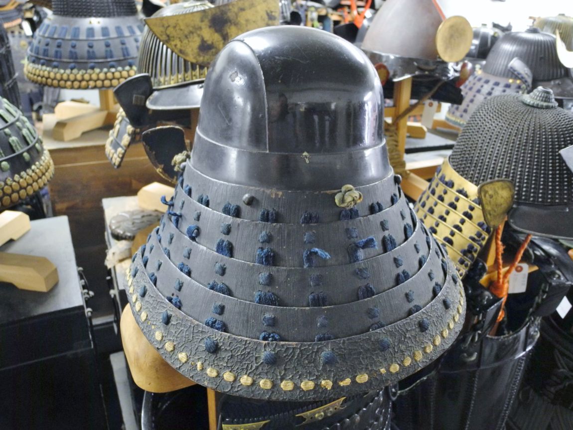

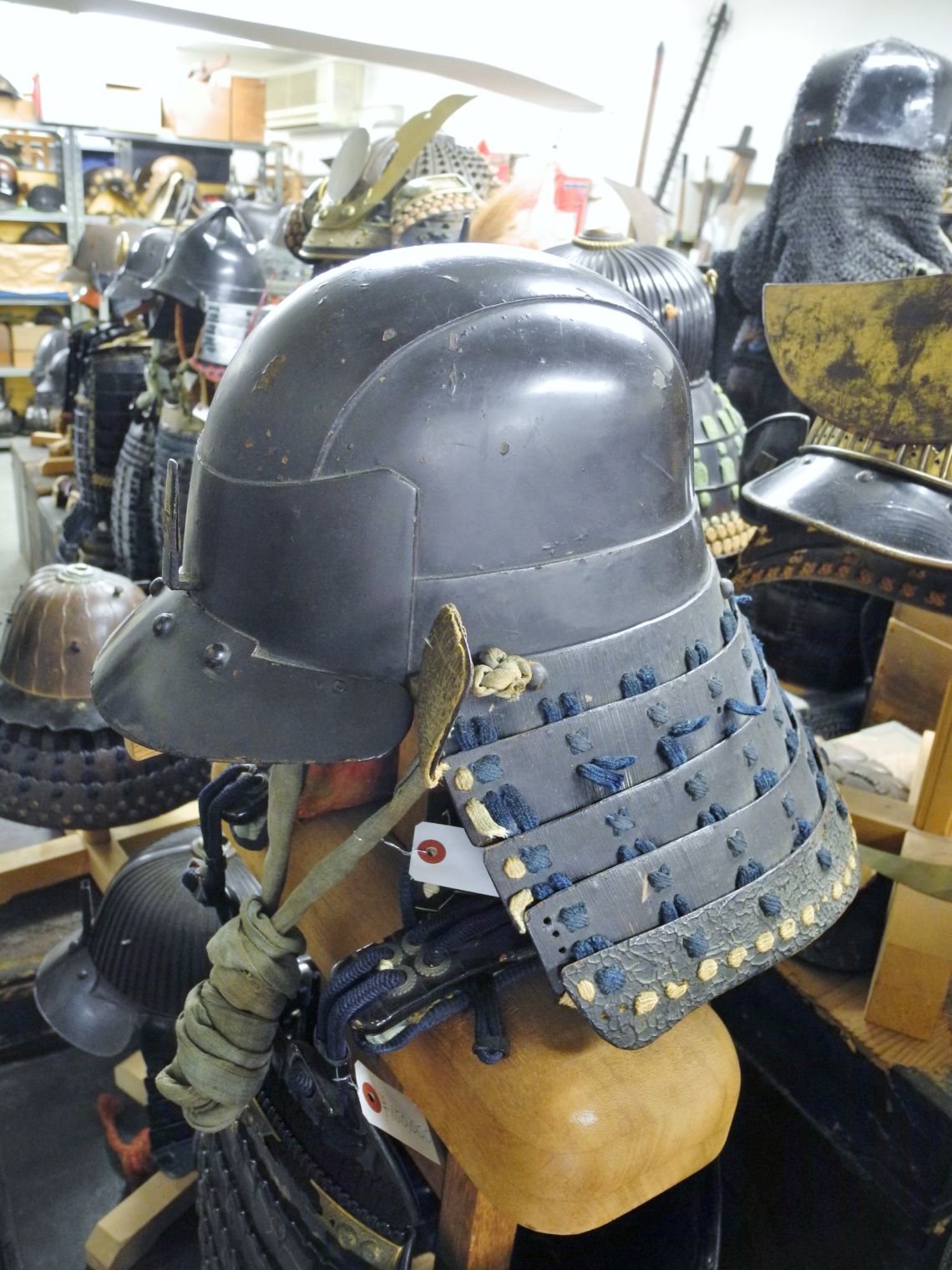

Gilles Posted May 26, 2018 Report Posted May 26, 2018 Dear all, Like Javier in his last topic, I could not resist to acquire a zunari. I think that this one can be qualified as HINENO-ZUNARI. It is signed Hirata Kaneyuki. Please note the modification of the visor (mabizashi) which is quite prominent. Also like Javier, I would like to hear any further explanation from experienced members of the forum about the shape of this helmet and about this armor maker. Kaneyuki seems to be only referenced in the Chappelear book (pages 220, 221). I would also need some explanations about the shape of the shikoro which is of the Hineno type. Can someone explain to me what are the features of the Hineno type shikoro ? I believe that this shikoro is original to this kabuto, is that right ? As you see, I have a lot of questions and I need you to help me. I am aware that it is not a high quality kabuto but I like its spartan shape. 5 Quote
Shogun8 Posted May 26, 2018 Report Posted May 26, 2018 Hi Gilles, I owned the brother of this kabuto, except mine was signed by Asai Tomoyuki. I did quite a bit of research on my kabuto and found the references that you've found in the Chappelear. I also know that there is another example in a European collection but I'm not sure if it's signed and by whom. The kabuto is actually extremely robust and well-made and has several small details which indicate quality to me, such as the cut corners of the front plate and the tsuke mabezashi/front plate in one piece. To answer your question about the shikoro, what makes it a hineno-jikoro is the fact that it is close-fitting (i.e. drops down from the more vertical koshimaki) and it curves to fit around the shoulder. Other shikoro like o-manju are straight edge and flare out from the kabuto itself due to the koshimaki being more horizontal (with varying degrees based on type). 3 Quote

Shogun8 Posted May 26, 2018 Report Posted May 26, 2018 On 5/26/2018 at 1:48 PM, uwe said: John beaten me ..... The similarities to "Asai Tomoyuki" are obvious. Or, is it the other way around, Uwe? I have found no reference to Asai Tomoyuki, only for Hirata Kaneyuki. Another interesting note - if I remember correctly, it is said in the Chappelear that there are only one or two makers who made zunari with tsuke mabezashi. Quote
DaveT Posted May 26, 2018 Report Posted May 26, 2018 A lot of similarities are shared between these two Kabuto.What I like is the slight variation in the dan of the shikoro. From the hachi-tsuke-ita to the Yon-no-ita having almost identical sabi-nuri relief. But the difference (personal taste of the original owner) with the Kata-zuri-no-ita, Gilles having uname-ito just gives it that extra touch of quality.Both are splendid examples of zunari with the Tsuke-mabezashi / sanko-no-byo adaption. Quote

Shogun8 Posted May 26, 2018 Report Posted May 26, 2018 Now that I look at Gilles' pictures more closely, there are some quite noticeable differences: Gilles' kabuto has a more typical mabezashi that is separate from the front plate, while the Asai kabuto has the mabezashi and front plate in one piece. The Asai kabuto also has a very straight top edge for the front plate, while the one on Gilles' seems to dip down. Quote

Shogun8 Posted May 27, 2018 Report Posted May 27, 2018 Gilles, I forgot to post a picture of the area I mention above (tsuke mabezashi made in one piece with the front plate and straight top edge of front plate), which I now do here: Also, going back to your original question about the shikoro on your kabuto, it only seems to have a very slight curvature on the lowermost lame and in some of the pictures it looks almost straight. If it is straight then it would not be classified as a hineno jikoro. The shikoro on the Asai kabuto is of the hineno variety as can be clearly seen in the second picture. Quote
