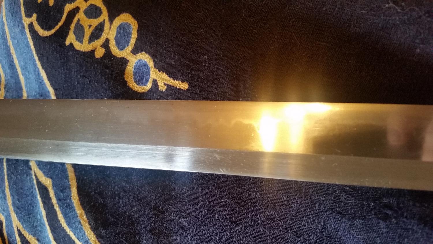

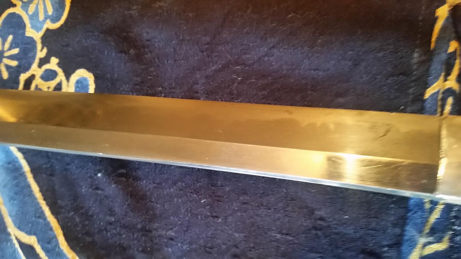

I'm trying to figure out the style of this Hamon, the closest I have seen is Koshi-No-Hiraita but I have found very few examples to compare.
Anyone with examples or which schools/smiths are known for this Hamon would be greatly appreciated.
Koshi-no-hiraita is associated with the oei bizen school. Iirc it was copied by sue bizen such as sukesada and probably some edo smiths.
On the sho-shin website there's a good example by morimitsu I believe.
Variation of Sanbonsugi seems about right then, the blade has Kanbun Sugata which ties in. Thank you everyone. Did anyone have a reference for a sword with a similar variation?
