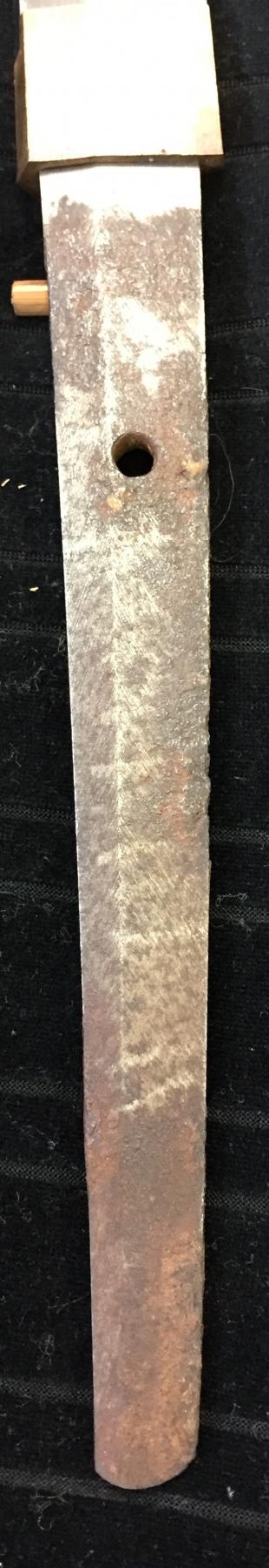

Navymate Posted April 26, 2018 Report Posted April 26, 2018 Post All, I was so impressed with the generosity of knowledge and the abundance of such with my first post (in which I asked for translation help on a late WW2 production blade) that I have a unique situation that I’m hoping I can get some advice and translation help. The previous sword I mentioned is not mine but that of a friend who has a retail store close to where I live. He knew that I had some interest in Japanese blades so he asked if I would be interested in doing some research. Being my first opportunity to appreciate a Japanese sword (arguably so due to its non-traditional method of manufacture), of course I jumped at it. Clearly, I’m a novice at best but nonetheless it has been fascinating and educational. The friend who has a retail store apparently had someone who brought in 4 swords as trade or as an estate sale. Normally he doesn’t deal with any swords, so he’s asked me to help him. I explained the protocol to him about making a donation in appreciation of the help and knowledge received so if/when he sells them he or I will make sure the donation is made. He knows that my knowledge is limited at best and that the information on the previous HIROMICHI sword came from this generous forum, so thank you again. The first of the 3 remaining blades will be included in this post and the others will be in subsequent posts. It is in WW2 Army mounts. The date seems to have worn off as there are faint traces of what appear to be white paint/lacquer. The mei has been difficult for me to decipher and was hoping for some assistance. I have some possibilities for each kanji with the exception of the first one. The last 2 kanji are somewhat obscured so I’ve tried to show different angles on the pictures. It appears to me that there are 8 kanji present. Please forgive any obvious errors. [1. ???, 2. katsu, 3. Seki, 4. Ju, 5. Gen or Moto (maybe Minamoto), 6. San, Kuni, Mi, Mitsu, etc., 7. Yoshi or Yori (but I think it might be Kuni or Hou in certain light), 8. Saku; Nari or Suke; or a variant of San, etc.)]. To save space I will just post pictures of the nakago. If more pictures are needed I will gladly provide them. Thank you Quote

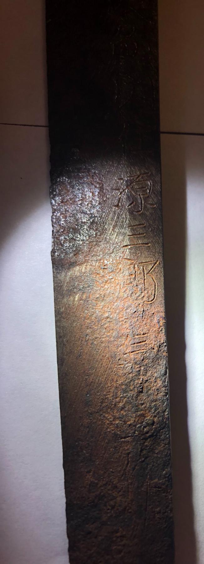

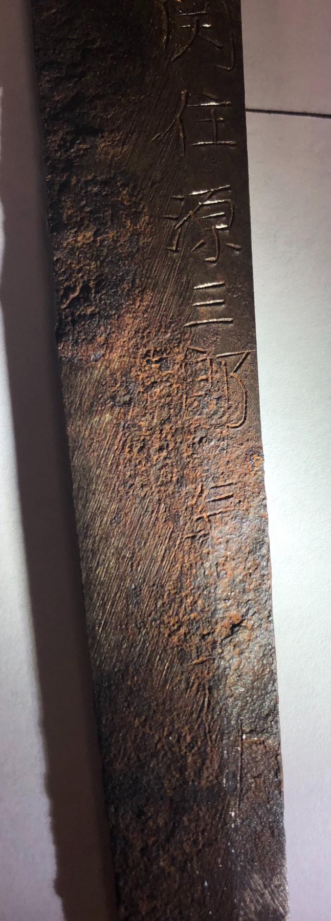

John A Stuart Posted April 26, 2018 Report Posted April 26, 2018 I see Noshu Seki ju Minamoto Mi...... John 1 Quote
Ray Singer Posted April 26, 2018 Report Posted April 26, 2018 Noshu Seki ju Minamoto Saburo Kane something. Maybe Kaneuji. Can you take a clearer photo of the bottom of the mei? 1 Quote

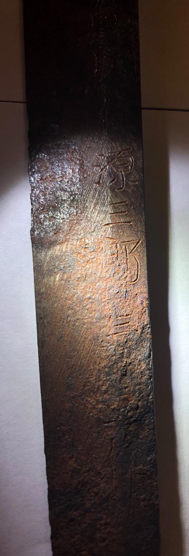

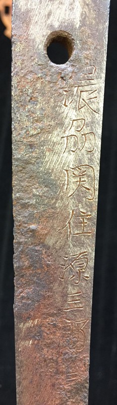

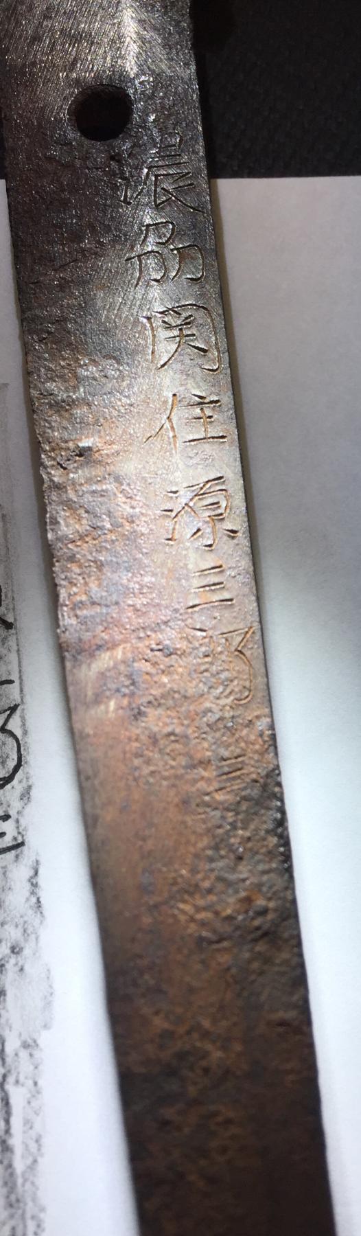

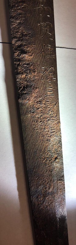

Navymate Posted April 27, 2018 Author Report Posted April 27, 2018 I’m sorry it took so long to respond back, my 2 year old son is sick and I needed to spend time with him last night. Here are some more pictures of the last symbol. Thank you both, Mr. Stuart and Mr. Singer, for being so generous with your knowledge. I have drooled over many of the items on your website Mr. Singer, incredible collection. I’d be glad to post any and all pictures needed. Thank you again. Mark Quote
John A Stuart Posted April 27, 2018 Report Posted April 27, 2018 I can see the Saburo now, 三郎 Not much else. John Quote
Ray Singer Posted April 27, 2018 Report Posted April 27, 2018 Thanks Mark, and for the kind words. Unfortunately the last two kanji before 'saku' are very difficult to make out. Quote

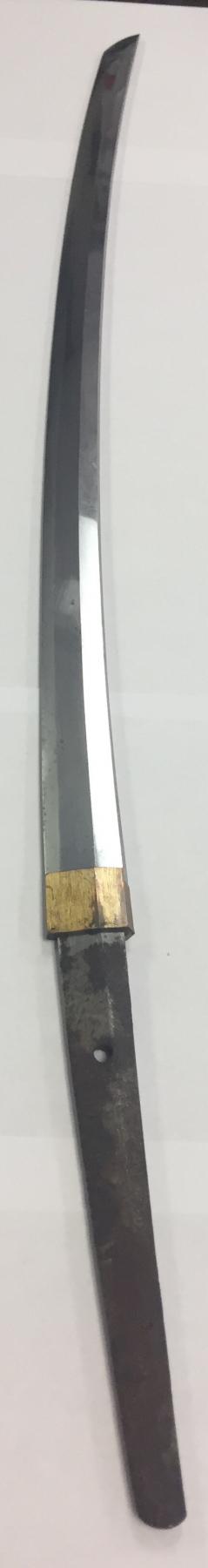

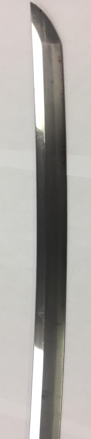

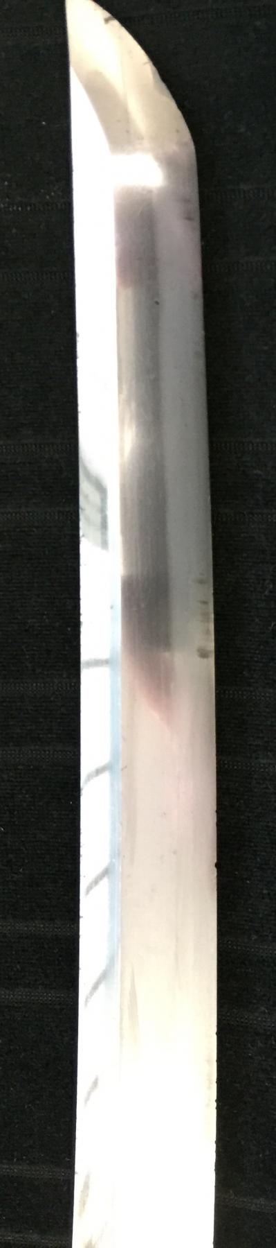

Navymate Posted April 27, 2018 Author Report Posted April 27, 2018 Thank you gentlemen, the help is greatly appreciated. Even though this sword isn’t in museum condition the Hamon is “bright” and visible compared to the other 3 swords. The Army mounts are all matching numbers and seem to be in good condition. Overall I think it’s a beautiful sword. The pics aren’t great but here are some pictures. I will post pictures of the other 2 swords later today when I have some more free time. Thank you again for all the help. Mark Quote
george trotter Posted April 28, 2018 Report Posted April 28, 2018 Hi, I think I can help...(sort of). I once had a sword signed this way. It was NOSHU SEKI JU GENSABURO KANETAKA (Hawley 1981 KAN2382) but can also be read as KANEUE (Kapp & Yoshihara Mod. Jap. Swords & S/smiths p.212) and also as KANEKAMI (oshi above in the "Japanese Sword Index" Showa oshigata). The oshigata shown in the above link is the sword I owned and it is signed the same as yours...unfortunately the oshi is hard to read. The kanji "Minamoto" is in this case read as "Gen". I don't know anything about him other than to say I THINK (from memory) my blade was a gendaito. From Jinsoo Kim's list of Seki Swordsmiths he is listed as KANEKAMI (or UE or TAKA), family name KOKETSU Gensaburo. Registered as a Seki swordsmith July 25 1940. That's all I have, sorry. Hope it helps, 4 Quote
uwe Posted April 28, 2018 Report Posted April 28, 2018 "Gen" instead of "Minamoto" reading.... Thanks George! Quote
george trotter Posted April 28, 2018 Report Posted April 28, 2018 Hi Mark (and Uwe), I found a reference to him in Homma & Ishii "Nihonto Meikan" p.148 (I'd scan it for you but my scanner is playing up...ah, working again). Translated it says: KANETAKA. and his details are as follows (assuming my translating is correct): Koketsu Gensaburo. Seki shi (city), Takami machi (town). Seki Token Kabushiki Kaisha Senzoku (Seki Sword Forging Company affiliate/attached to). He was 41 in 1943. He was Rikugun Jumei Tosho (RJT). He is classified as Showa, Gifu, Army smith. Japanese Sword Index (by Jinsoo Kim) lists him under its RJT smiths "known from literature sources" as Koketsu Kanetaka. So, some of his swords must have a "star" stamp on them. That's about the best I can find. Regards, George 4 Quote
george trotter Posted April 28, 2018 Report Posted April 28, 2018 Gosh, I wish I hadn't started this now...found a reference on-line in Markus Sesko's listing. He says: KANETAKA, GIFU, Showa. Student of Watanabe Kanenaga and RJT. But Markus' source says Kanetaka's personal name was HANABUSA GENSABURO. AGAIN...I checked in the "Nihon Gendaito Shoshi" by Uchiyama Chapter IV pp.7 and 8 (printed in Token Bijutsu Journal #149, June 1969) and this confirms Markus' listing. It says a Hanabusa Gensaburo Kanetaka was the 8th student of Watanabe Kanenaga of Gifu. The problem here is that HANABUSA and KOKETSU are different kanji. One set of reputable books says KOKETSU and another pair of reputable books says HANABUSA. Only one is correct? or are there two Kanetaka smiths? I'm afraid it's over to you guys now.... Regards, 3 Quote
