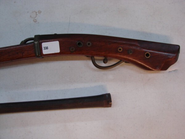

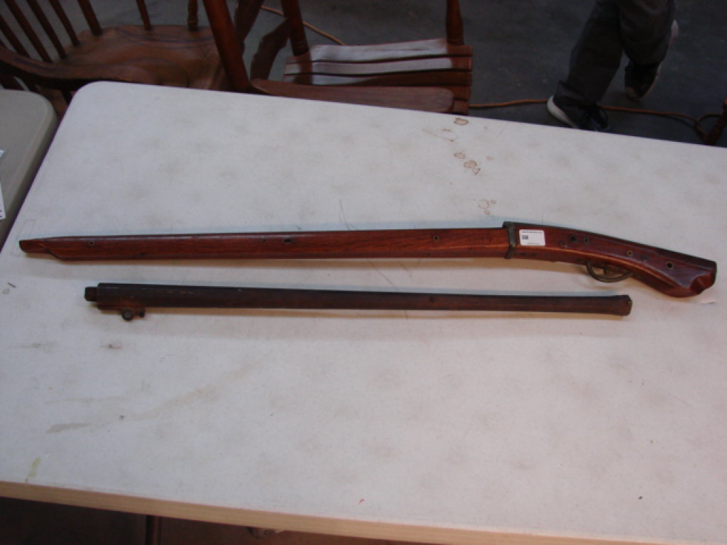

Hello. I recently purchased an old matchlock in an auction. I frequent the CMP forums, and it was suggested there that I ask questions here. Apparently they're not very common in the US. Apologies for the pictures, they're the ones taken by the auction company. Once I have the gun in hand I'll be able to take better quality photos.
I have a few questions if the experts don't mind.
1) I know that it's at least missing the flash pan cover (Hibuta?), barrel protector (Amaoi?), and pins (Mekugi?). I'm certain that I can fashion reproductions of the brass parts in order to have a complete, if not correct, rifle... or is that frowned upon? What about the pins, I've read that smoked bamboo is the preferred material for this. Is that just green bamboo shaved into shape and tempered over a fire?

Hi Drew, welcome here. You have found out quite a bit already in advance and your information is good! :thumbsup:
The gun's proportions with shortish fattish swamped barrel suggest a 軍用筒 (pron. 'goon-yo-zutsu') ie a proper gun made for warfare, and apart from the missing bits, in generally good condition, but presumably you have no measurements yet. The flash pan seems to have been reworked or relined, perhaps from heavy use. Hard to see in that shot. There is a middle sight and a foresight, but... no back sight?
The name is interesting as I have not run across it before. The father of this line (your smith Takakura Jinroku) seems to have been a Sakai (Osaka) smith, and his two sons or disciples of the same family name must have first worked in Osaka, and then moved to Himeji Han in Banshu (Harima no Kuni). (Himeji of the World Heritage Himeji Castle fame.) Unfortunately I cannot find a date for him, but one of these later Takakura smiths above, Takakura Jinroku Shigemasa, is dated for Kanei 10, a pistol in Itsukushima Jinja (Miyajima) in Hiroshima. This will give you something to work with if you can find out any more about them.
What we can probably say is that Takakura Jinroku (with no further name underneath), must have lived and worked in Settsu in the early years of the 1600s. I cannot see why someone might have faked that signature.
Further photographs of your gun may help us to further confirm such a dating.

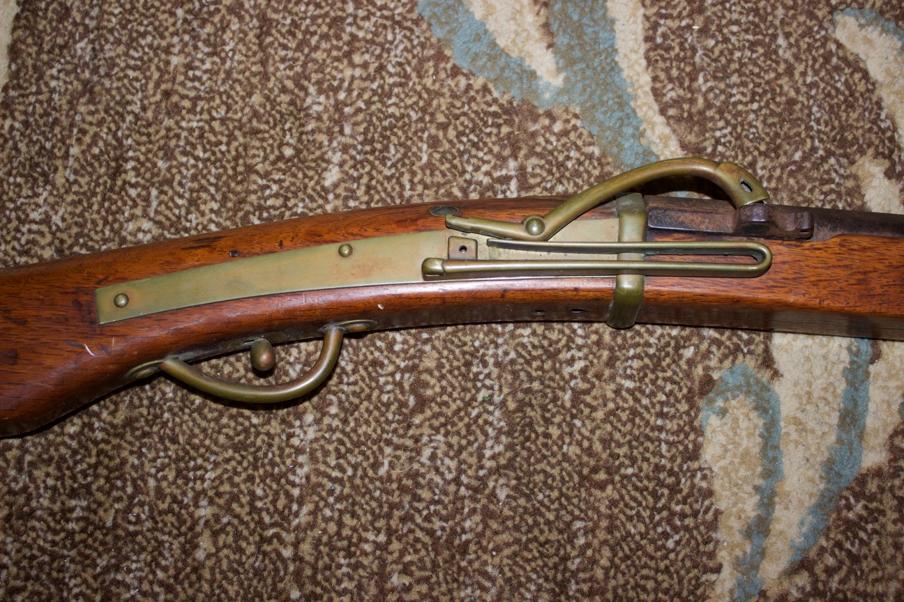

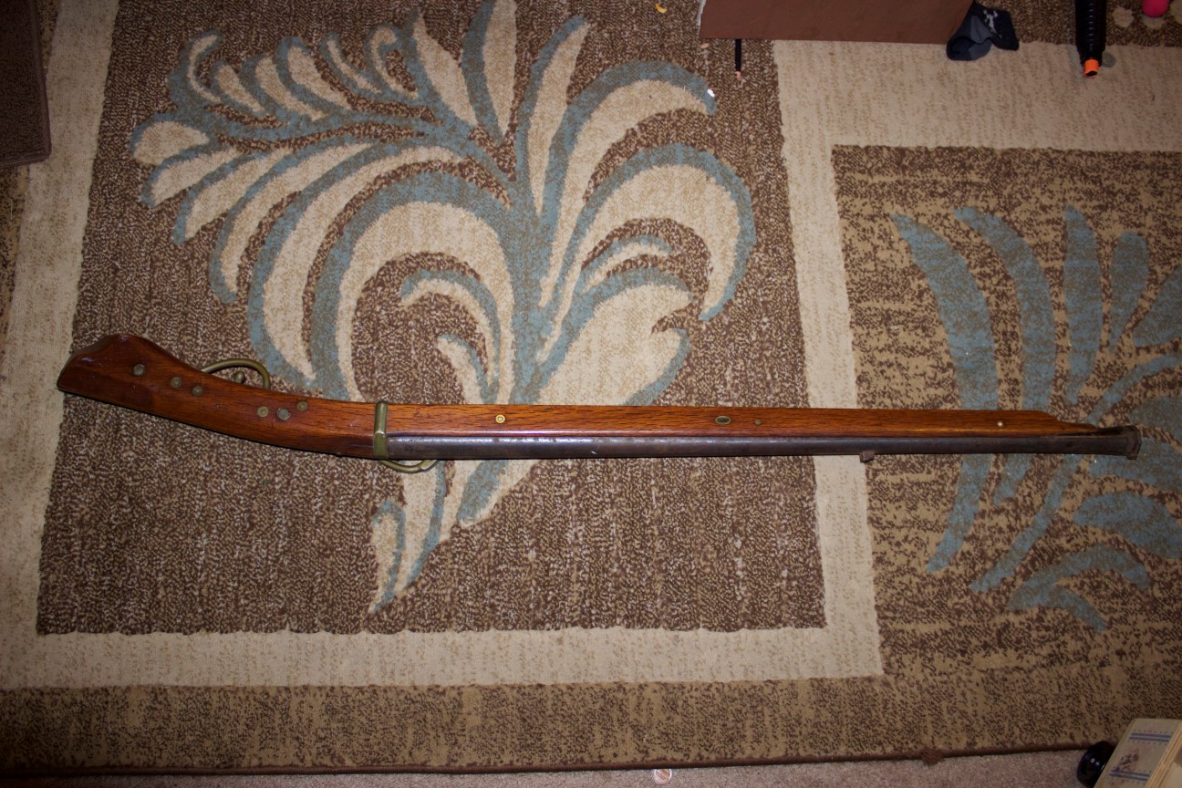

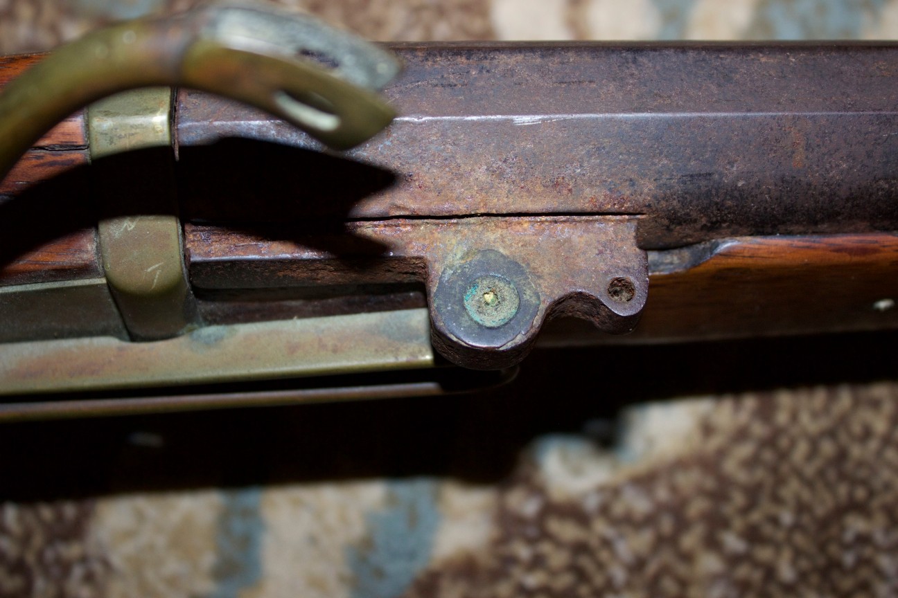

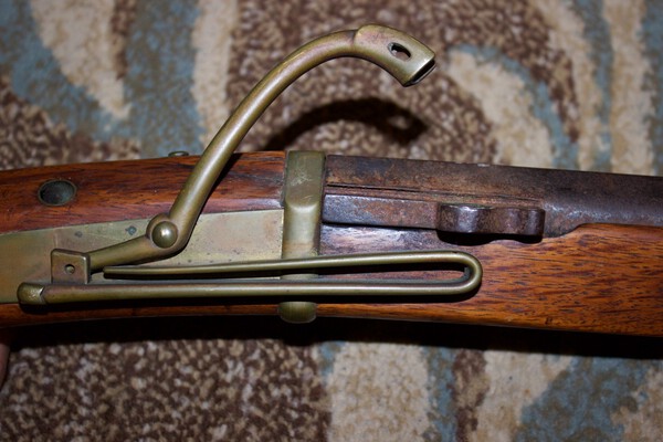

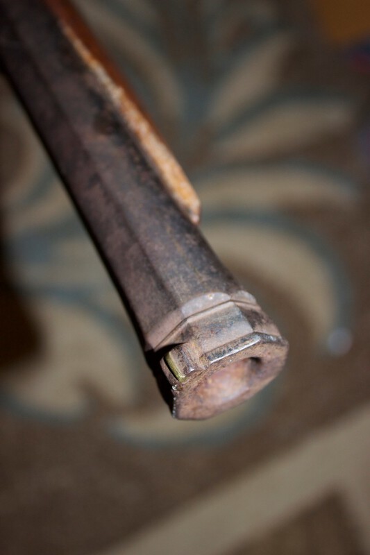

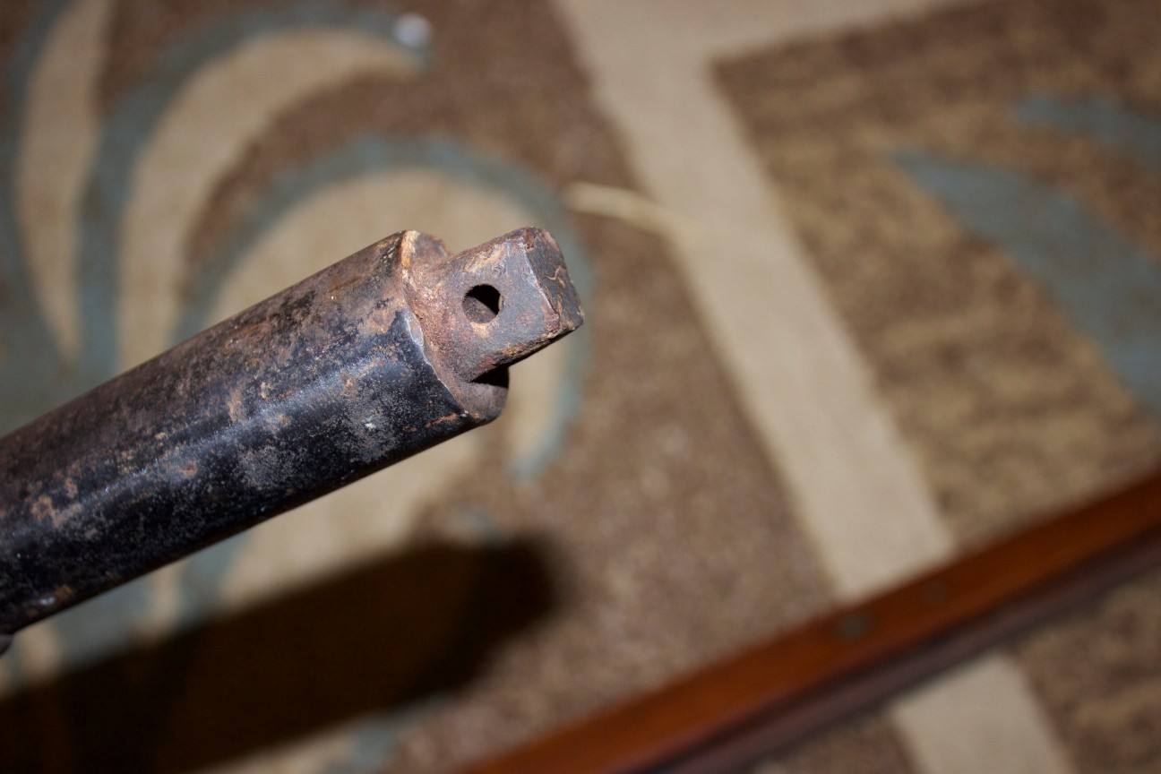

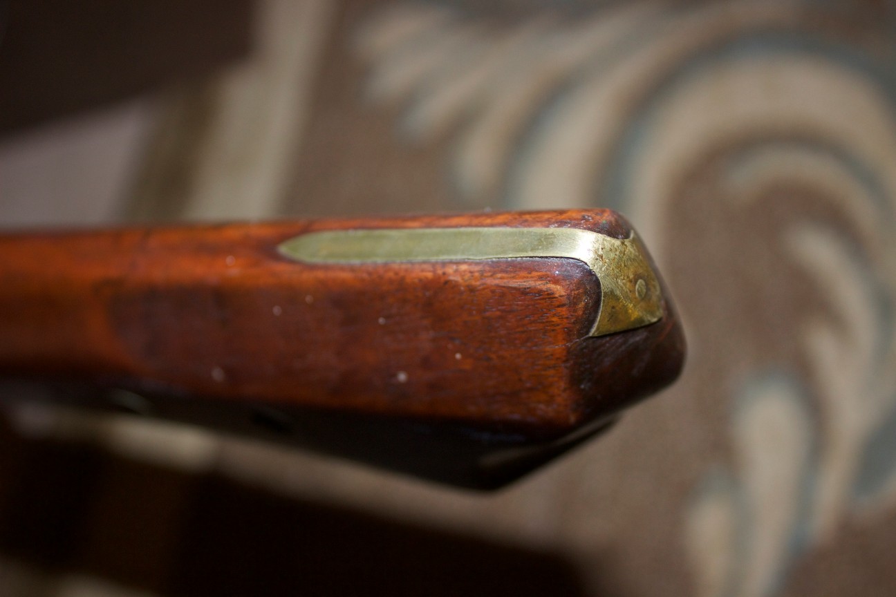

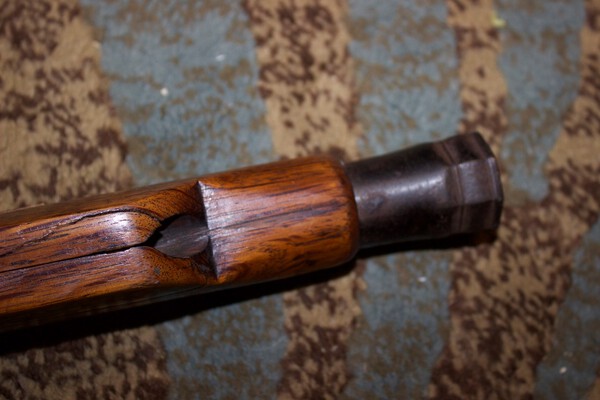

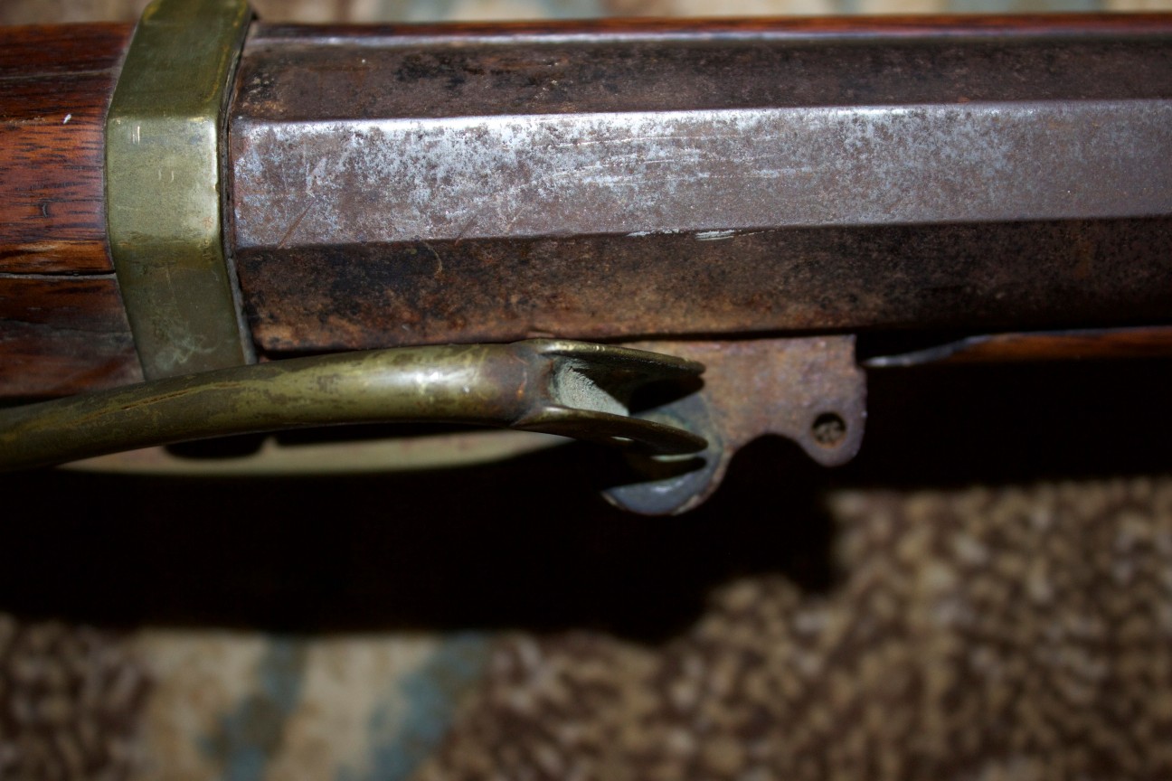

Hi Drew, much better and more informative shots. Thanks! I once bought a gun (visiting Ako with Brian) with the back sight in a similar unusual position, and no marks further back on the barrel to suggest that there had ever been another. It looks as though an attempt to remove the Bisen has failed? You have not mentioned the bore, the muzzle's internal diameter. Looking like it could be over 1.6 cm, at a rough guess. Much good in your gun, and worth restoring sympathetically.
From your links it looks as though the 'Takakura Jinroku' name was used through several generations, the three-barreled gun being right at the end of Edo. Perhaps relatives moved to Himeji? The other longer barrelled gun is in many ways quite different from yours, not least the muzzle shape and positioning of the rear sight.
Thanks Piers. I don't see any evidence of another sight having ever been present.
The Bisun doesn't appear to have any recent damage. The corners are a bit rounded, but if this was done in an attempt to remove it, it was a long time ago.
The flash pan does appear to be either lined or reworked, again at some point in the distant past.
As far as the muzzle diameter, I'll need to measure it and get back to you, but I would guess it to be right around 1.6 cm.
Another thing I found out upon examination is that it appears to be loaded. I'll have to find my ball puller and see if I can get that out.
 -Drew

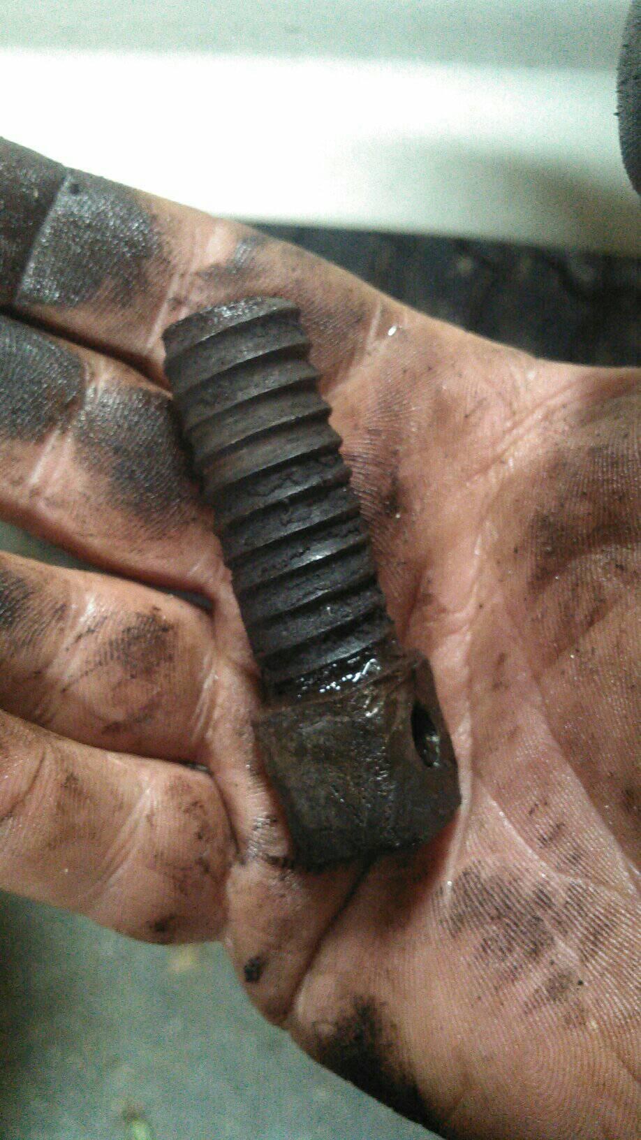

Success! I finally got the Bisen out. I've been soaking it in penetrating oil since my last post and trying it once a month or so. It finally decided to move. The bore turned out not to be plugged with lead, rather something gritty that soaked up the oil and broke apart, it almost looked like clay or cement. I've got the bisen in the ultrasonic cleaner now, it appears to have a very old hairline crack down the middle but it's functional. Now to get the touch hole and bore cleaned out.

Looks like a bisen in good condition. As Piers, I’m also currently trying to dislodge a bisen from an old Satsuma-style matchlock. Been going at it since December. I wouldn’t call it a war but there is def ”an absence of peace” between me and that darn screw. But after reading this post, I will continue tapping the metal and adding some new anti-corrosion oil. Hopefully one day...
Jan
The "penetrating oil" that I used to break mine loose is a home brew that a 90 year old machinist/mechanic showed me years ago. Equal parts acetone and automatic transmission fluid. It has to be the old non-synthetic fluid, Dexron 2/ Ford type F or earlier. It outperforms anything I've seen off the shelf.
Pure wintergreen oil is also an excellent penetrant if the non-synthetic transmission fluid isn't available where you live. It's expensive but it works great.

This is true. My Bisen does have a partial fracture down the middle, which I noticed on the head when I first cleaned it up to attempt removal. The fracture doesn't appear to affect the functionality of the bisen, and it appears to be quite old because it was packed with crud and doesn't show any shiny metal when viewed under magnification. My guess would be that someone made a heavy handed attempt at removal using the hole in the bisen for leverage.
I clamped the bisen head in a padded parallel machinist's vise and used a strap wrench to turn the barrel. A strap wrench, when used properly, never puts anything metallic in contact with the barrel. The nylon strap wraps around the barrel and the leverage of the wrench tightens and rotates the strap at the same time. The best ones have straps that are rubber coated for gripping power.
