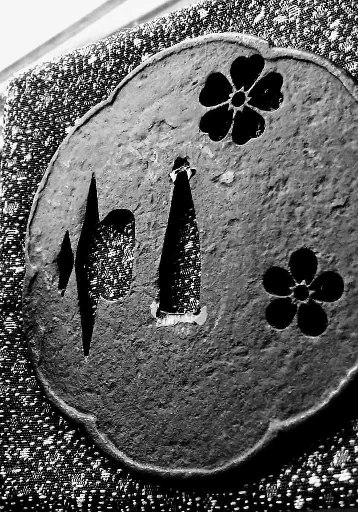

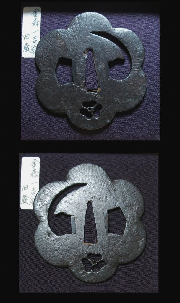

I am starting my topic in the same manner as at http://www.militaria.co.za/nmb/topic/19632-a-lot-of-questions-on-a-yamakichibei-tsuba/:

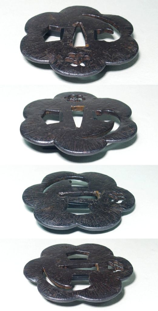

I recently acquired two tsuba on eBay from a decent seller, allegedly made by some 'Yamakichubei', and bearing a signature: yama () kichi (吉).
Then, I bought another one, with the same yama () kichi (吉) signature and similar design, but decorated with gold inlay of paulownia with tendrils.
Size of the first tsuba: 85.2 x 79.1 x 3.5 mm (seppa-dai)
Size of the second tsuba:83.6 x 77.2 x 3.6 mm (seppa-dai)
Frankly, I did not (and do not) think that these are a real Yamakichubei pieces, but they were cheap enough to buy for research purpose.

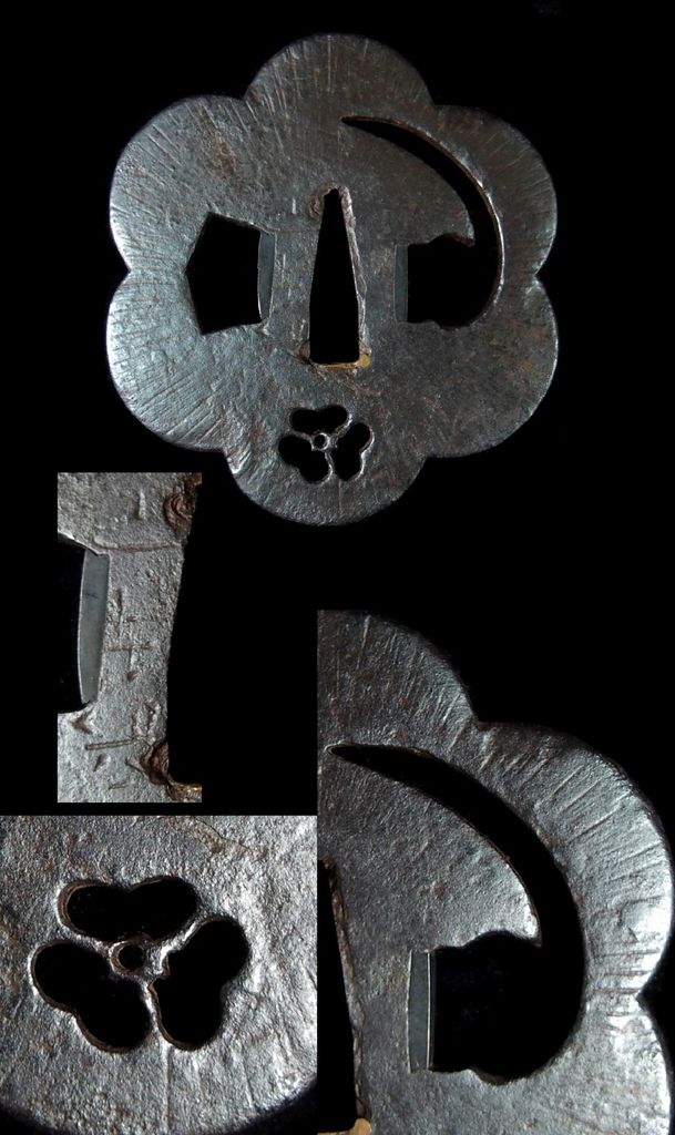

How puzzled I was when in a few days I found the third specimen, almost identical to the ones before, but this time with a paper: https://www.ebay.com/itm/AMIDA-TSUBA-by-YAMAKICHIBEI-w-KICHO-Judgment-of-KATANA-sword-MOMOYAMA-3-3/123080838655?ssPageName=STRK%3AMEBIDX%3AIT&_trksid=p2055119.m1438.l2649
Seems like they are producing them en mass!
Anyway, I would like to know what you think regarding these tsuba and Yamakichubei tsuba altogether. It seems to be a fascinating theme for research beyond what we know from 'Tsuba. An aesthetic study'.

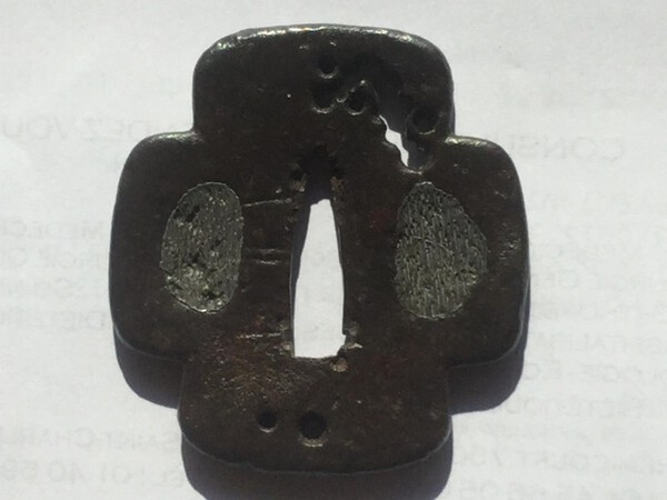

First Generations were very good and produced very good iron. Then as time passed, they were mass produced, copied...
A good one is worth more than 1000$.
Here are two from my collection, the colour is deep chocolate brown
Sergei,
These tsuba you have presented here really have nothing to do with the actual Yamakichibei works of the Momoyama and earliest Edo Periods.  They are "homage" pieces, if you will, but are only a hollow facsimile of the real thing.  The inscription is "Yamakichi," as opposed to "Yamakichibei," and they always appear with those odd little holes (between 4 and 6) and carved lines in the vicinity of the hitsu-ana.  Many of these were made in the 19th century, all with little variation, some 250 years after the actual Yamakichibei men were working.
As for opinions on Yamakichibei tsuba overall, well, there is probably a range of viewpoints.  Many here know mine, as I consider true, early Yamakichibei tsuba to be among the very best iron sword guards ever made.  At their best, they are second to none, including Nobuiye and Kaneie.  Their mastery of certain features/processes such as tsuchime, yakite, and tekkotsu, especially in combination, reached heights never to be surpassed, and rarely equaled, resulting in tsuba with great haki, or power.  If one's taste is for sword guards with this sort of expressiveness, Yamakichibei works are at the top of the mountain.
Of course, for many, such aesthetics hold less appeal.  Yamakichibei tsuba are deeply connected with the aesthetics and culture of Buke Tea that was dominant in the Momoyama Period.  The aesthetic principles informing cha no yu then---its ceramics and other articles, as well as the architecture and interior design---were of major importance to the leading figures (and thus their vassals) of the time.  My belief is that one cannot properly appreciate or understand Yamakichibei guards unless one also studies the culture of Tea in the late-16th and early-17th centuries.  If one cannot grasp what makes an Iga hanaire or Bizen mizushashi of that time a masterwork in ceramics, one may not be able to fully "get" Yamakichibei.
There is much, MUCH more to be said about Yamakichibei, than can be adequately presented here.  Perhaps a formal article is in order... ;-)

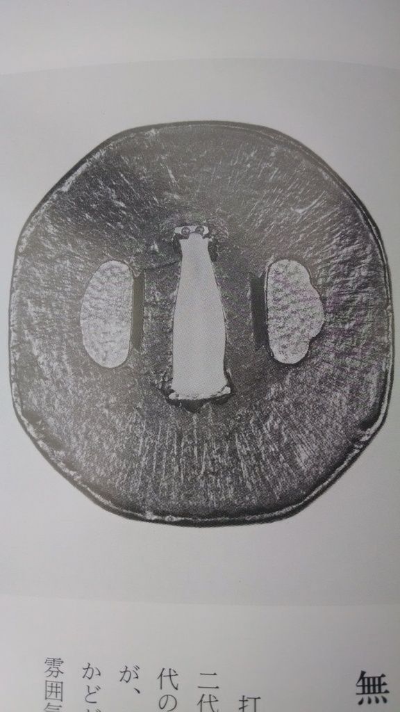

SV: Evan, please tell about this tsuba. Do I understand correctly that it is 2nd (Nidai) Yamakichibei? Please provide dimensions.

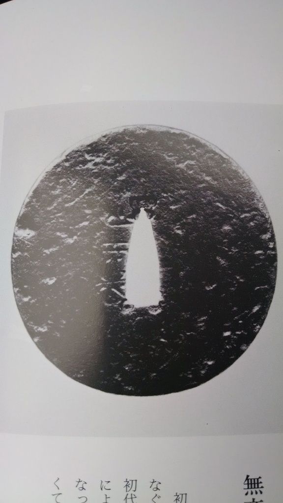

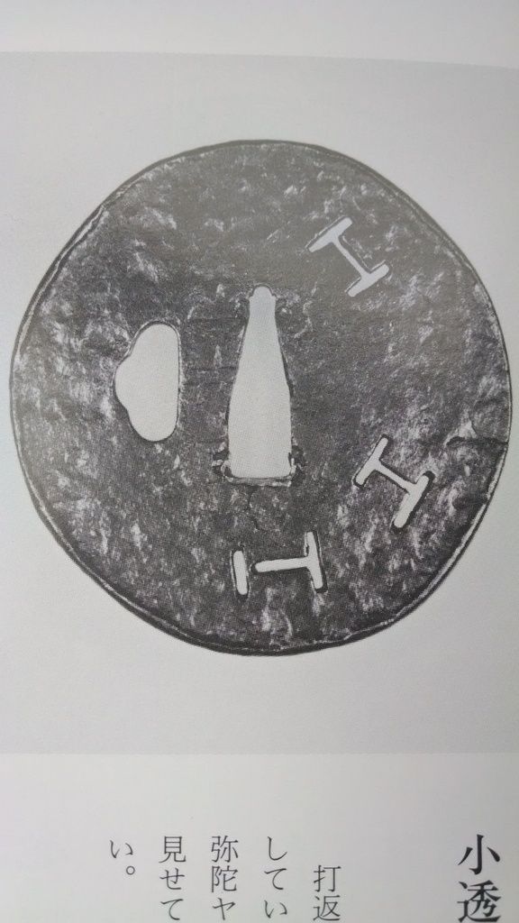

More Nidai:
Oxalis%20Yasuri%20Nidai%20YKB_zpsc5zuuhx
SV: Please provide citation for the photos below. Where are they from?
I think I can answer for Evan, Sergei.
The color photos are of a nidai Yamakichibei offered in an auction last year.  I don't know the exact dimensions on this guard (I don't think Evan does either, since I sent him the photos originally... :glee: ).  This tsuba has Tokubetsu Hozon papers and is, in my view, a masterwork.  The color of this piece, in particular, is fantastic, being of that "yohkan" hue that is so highly prized (the oblique images, as usual, show the color of the guard best).
The black and white photos are all taken from Owari to Mikawa No Tanko.
Jean, if you would like your pieces to be cited, provide hi-res photos (~1MB) with short description: signature, generation, dimensions. Thanks. And yes, your last name, please!
Cheers,
Steve
Thanks Steve. I was thinking that the photos are from there. Very good! Can you tell which tsuba on the photos are which generation Yamakichibei?
All of those black and white images are of nidai Yamakichibei tsuba, Sergei.  :)
