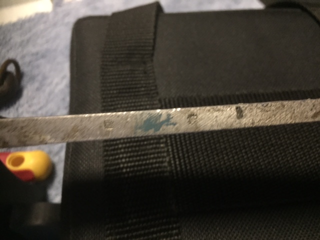

IJASWORDS Posted April 17, 2018 Report Posted April 17, 2018 As requested Hamfish, photos attached photos of my MURAYAMA KANETOSHI. It has a star stamp, and small stamps on MUNE. This is a nice GENDAITO, which in fact David has seen, and highly recomends a professional polish. Hope this settles the confusion. 2 Quote

IJASWORDS Posted April 17, 2018 Report Posted April 17, 2018 Again Hamfish, reading and rereading your attached link, only reinforces my view that RJT made blades with a star stamp, are traditionally made from traditional materials. And agree with David and Brian that MUNE stamps indicate the supply chain through which they traveled. 1 Quote

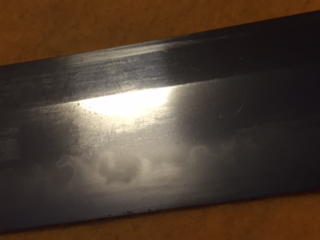

Bruce Pennington Posted April 17, 2018 Report Posted April 17, 2018 Hamfish, I like your theory. And while I agree the RJT smiths were to use tamahagane and traditional methods, it doesn't explain your observation of the blades with a Star and no arsenal inspector stamp. Theory - what if they were for a custom order, and didn't go through the arsenal? Another question is why are there small and large Seki, but only small Na for Nagoya? Anyway, Here's some shots of the blade on my Star/small-Seki stamped Kunitoshi, in Type 3 fittings. I don't know nihonto, so maybe you guys can tell if it's gendai or not. Quote
reeder Posted April 17, 2018 Report Posted April 17, 2018 If you didn't meet the requirements, you didn't get a star stamp. If it has a star stamp, it's a gendaito regardless whether or not it has an arsenal stamp. That is unless it's a fake star stamp. Although if a sword by an RJT smith lacks a start stamp, it doesn't necessarily mean it's not a gendaito. I thought all of this was clarified & settled years ago. 2 Quote
