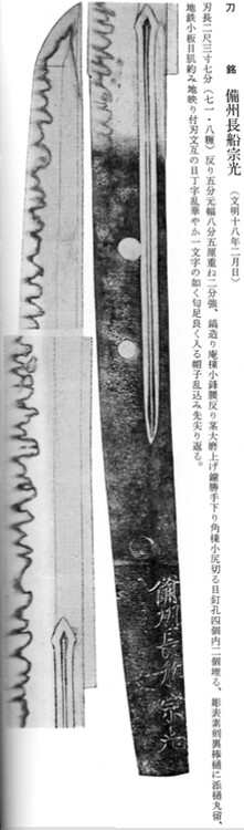

Guest reinhard Posted May 7, 2008 Report Posted May 7, 2008 ...but i've not found an oshigata with Bishu Osafune Munemitsu, but you certainly know this kind of mei is synonymous of kazu-uchi-mono. I wish he certainly does not know. "Bishu Osafune + name" is NOT SYNONYMOUS with kazu-uchi mono. Here's an oshigata (Bishu Osafune MUNEMITSU!) dated Bunmei 18th year (1487), which definitely NOT belongs to a Kazu-uchi mono. We have discussed this topic before and constantly repeating the "Bishu Osafune = kazu-uchi mono" sermon does not make it true. There is a statistic relevance to it, but it is far from being a reliable rule. On the contrary it is misleading beginners. reinhard Quote
Jean Posted May 7, 2008 Report Posted May 7, 2008 As I originated the Kazu Uchi mono post, I have to answer Reinhard remark : I wish he certainly does not know. "Bishu Osafune + name" is NOT SYNONYMOUS with kazu-uchi mono. Here's an oshigata (Bishu Osafune MUNEMITSU!) dated Bunmei 18th year (1487), which definitely NOT belongs to a Kazu-uchi mono. Reinhard is absolutely right. Suspicion about the mei "Bishu Osafune ..." being kazu uchi mono depends on the date the sword was forge, taking as example Blades forged during the 15th century or before and beginning with "Bishu Osafune ..." you will find very few kazu uchi mono. I think these kind of swords appear at the very end of 15th century and boomed during the 16th century. Nevertheless, Reinhard example is biaised because there are always exceptions to the rule. Remember the Kanenori post and the Kiritsuke mei, I was saying that the kanenori kaji line was not outstanding and Jacques shows us a Juyo Kanenori blade. Darcy answered that a Juyo blade does not make a Kaji line exceptionnal. In fact, I have never seen books or pictures dedicated to kazu uchi mono swords, I think there is a market there :D :D :D The only thing I will never do is to buy a "Bishu Osafune ..." mei sword forged during the Sengoku period without having the possibility to examine it "in hand". Even High resolution pictures can be misleading Statistics are there even if there are exceptions .... That was Guido's remark too. Do not discard anything but be very cautious, Nihonto is full of booby traps Quote

pcfarrar Posted May 8, 2008 Report Posted May 8, 2008 On a sidenote is the date 1486 on the oshigata Reinhard posted? My Bishu Osafune Munemitsu katana has an almost identical hamon to that example. Quote
Jean Posted May 8, 2008 Report Posted May 8, 2008 On a sidenote is the date 1486 on the oshigata Reinhard posted? My Bishu Osafune Munemitsu katana has an almost identical hamon to that example. Few chance to be a Kazu uxhi mono :D :D :D Quote
