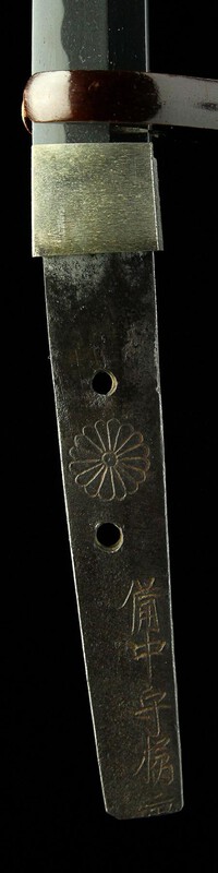

lanceoa Posted April 5, 2018 Report Posted April 5, 2018 Noob here, just found this forum and like the content already. I have no idea what I’m looking at. Approx wakizashi length , i’ll measure it when I get home. Thx Quote
Ray Singer Posted April 5, 2018 Report Posted April 5, 2018 Can we see the entire nakago? What can be seen may be 'kami Tachibana Yasu'. A likely candidate may be [Kikumon] Bitchu (no) kami Tachibana Yasuhiro. 備中 守橘康 廣 1 Quote
lanceoa Posted April 5, 2018 Author Report Posted April 5, 2018 I didn’t get any good pictures laid out (toddlers in my house), I’ll do that this afternoon. Thx for the ref- def some resemblance Quote

SteveM Posted April 5, 2018 Report Posted April 5, 2018 or ??守播磨?? something no-kami Harima something Harima is a location name. Kami is an official title, usually translated as "governor", only its just a title. It isn't meant to infer political authority. Harima-no-kami (Governor/Lord of Harima) is a common thing to find on swords, but the opposite construction is weird, so I could be off target with this one. Quote
Ray Singer Posted April 5, 2018 Report Posted April 5, 2018 That was my thought before bidding for Yasuhiro, however my reasoning was that Harima would typically appear before '(no) kami' and I was not able to find a smith whose mei contained Harima and additionally used that kiku-mon. Quote
Vermithrax16 Posted April 5, 2018 Report Posted April 5, 2018 I thought the Yasuhiro mei would be on the omote side and the kiku mon would be on the ura side. Quote
lanceoa Posted April 5, 2018 Author Report Posted April 5, 2018 Thanks for attempting this riddle. Here are a few more pics Quote

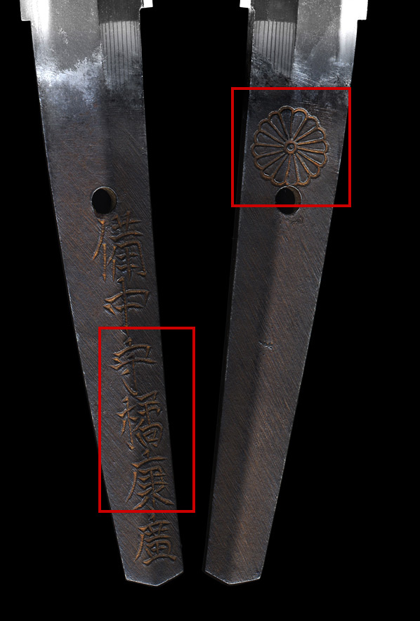

Ray Singer Posted April 6, 2018 Report Posted April 6, 2018 That is not always the case. Please see attached for a couple of reference examples. On 4/5/2018 at 11:20 PM, Vermithrax16 said: I thought the Yasuhiro mei would be on the omote side and the kiku mon would be on the ura side. 2 Quote
Vermithrax16 Posted April 6, 2018 Report Posted April 6, 2018 As a huge fan of Ishido school, will take this offline, but what gen Yasuhiro is that? Have seen some mishina blades with kiku mon on the omote. Interesting. 1 Quote
Ray Singer Posted April 6, 2018 Report Posted April 6, 2018 Uncertain of the generation. These were both offered by a Japan dealer. 1 Quote
lanceoa Posted April 12, 2018 Author Report Posted April 12, 2018 Thanks Sir Ray - really enjoying following the Tachibana Yasuhiro lead. Hopefully headed to the local sword club to share and learn Quote
Jacques Posted April 12, 2018 Report Posted April 12, 2018 If shoshin, not the shodai according examples shared by Ray (specially the ji 守) 1 Quote

TheGermanBastard Posted April 12, 2018 Report Posted April 12, 2018 jacques meant that it is not a good match for the 1st generation. 1 Quote

Jacques Posted April 13, 2018 Report Posted April 13, 2018 Humm http://www.e-sword.jp/sale/2015/1510_1012syousai.htm Quote
