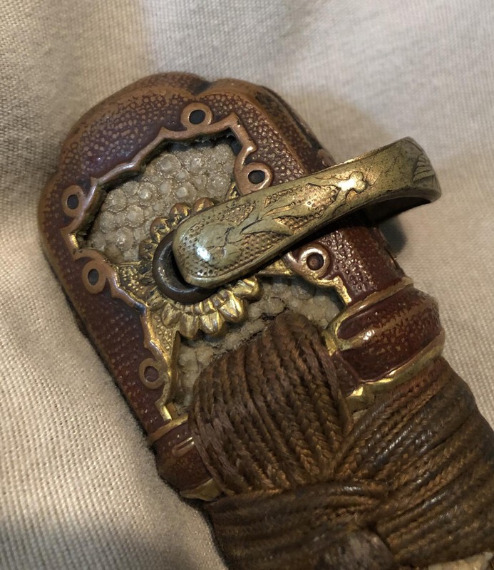

Bruce Pennington Posted April 10, 2020 Report Posted April 10, 2020 Got one! Came on a ‘39 Mantetsu in combat saya! Looks old and worn fitting the wear on the entire piece. Sarute isn’t painted like the rest of the fittings, which says to me that it was made by a different shop and added by the koshirae shop or the officer after purchase. 1 Quote

Kai-Gunto Posted April 10, 2020 Report Posted April 10, 2020 Got one! Came on a ‘39 Mantetsu in combat saya! Looks old and worn fitting the wear on the entire piece. Sarute isn’t painted like the rest of the fittings, which says to me that it was made by a different shop and added by the koshirae shop or the officer after purchase. 237EA680-D1DE-468F-9A08-0D03D7F831D7.jpegDA20C037-D5B4-4FBC-92B4-37B17BDF43C9.jpeg25C0C77F-7959-46DA-91F8-E12FEF562D2F.jpeg Looks like the Mon was removed. 1 Quote

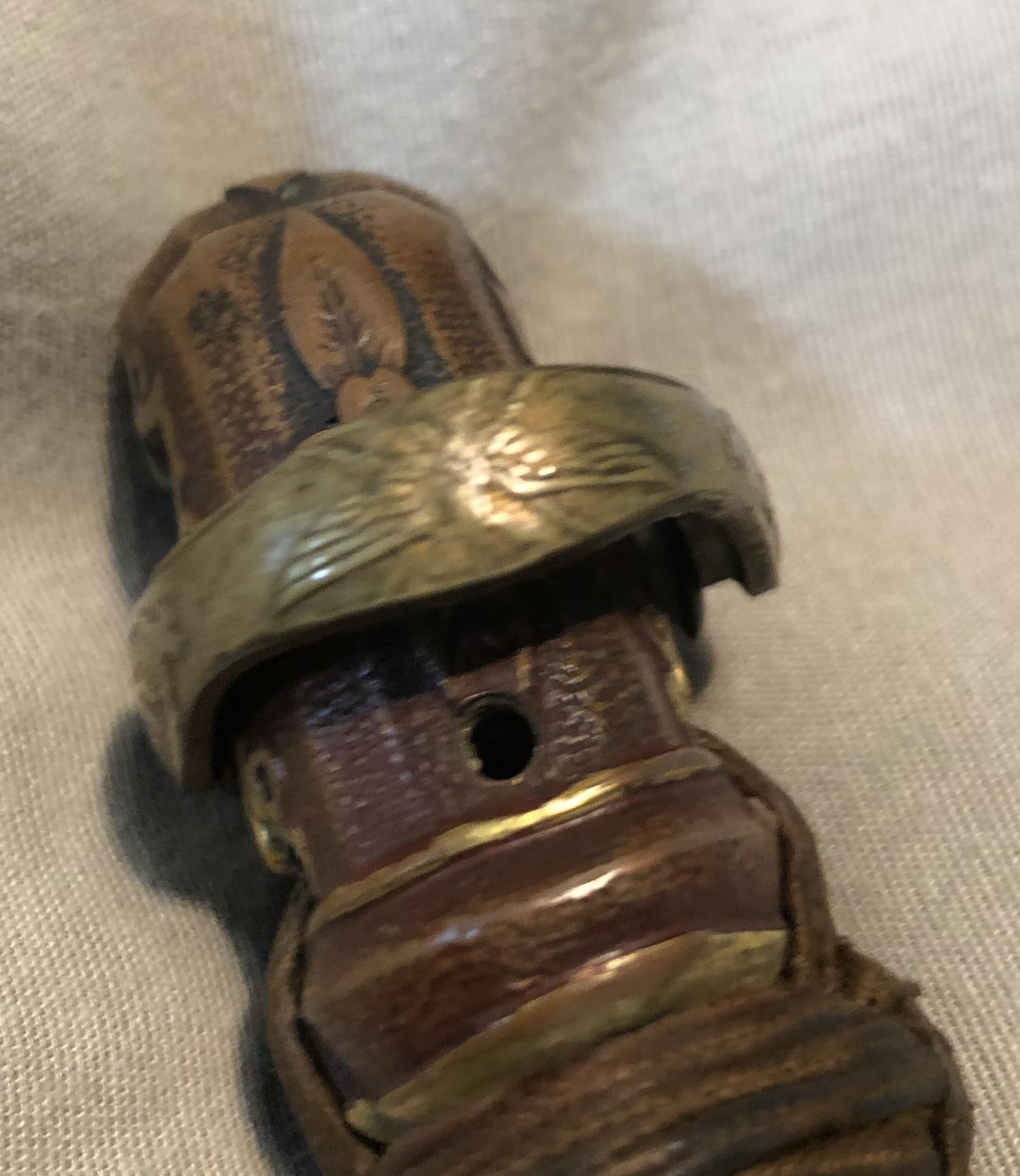

Bruce Pennington Posted April 10, 2020 Report Posted April 10, 2020 Looks like the Mon was removed.I have heard/read that some guys did that before turning their swords in at the end of the war, and it was my first thought too, but the hole is on BOTH sides of the kabutogane. Neil - I know I've seen this before. Is it you that has a similar kabuto with holes? Quote

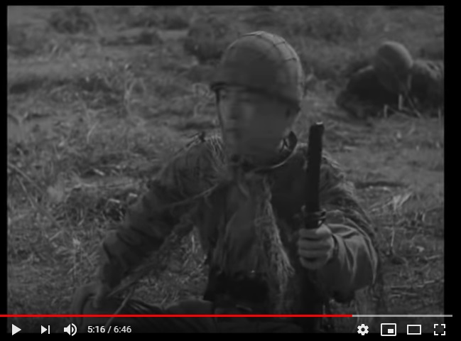

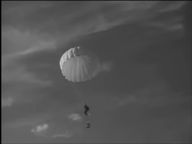

Dave R Posted April 10, 2020 Report Posted April 10, 2020 Just saw these replies about paratroopers jumping out of planes wearing a sword...well...who'da beleived it...we live and learn...good research guys. Propaganda film, but wartime in date... https://www.youtube.com/watch?v=XqbOSmM9LCY Quote
PNSSHOGUN Posted April 11, 2020 Report Posted April 11, 2020 I have heard/read that some guys did that before turning their swords in at the end of the war, and it was my first thought too, but the hole is on BOTH sides of the kabutogane. Neil - I know I've seen this before. Is it you that has a similar kabuto with holes? image3.jpegimage1.jpeg It's definitely where a Mon used to be, they were attached with a pin through the Kabutogane like you see on yours then brazed/peened on the inside before assembly. Quote

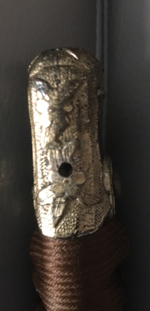

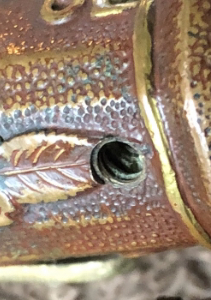

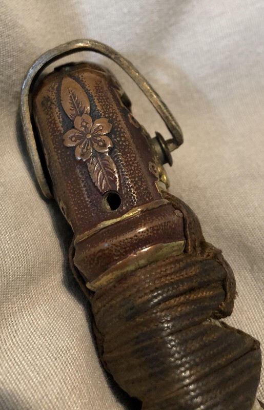

Bruce Pennington Posted April 11, 2020 Report Posted April 11, 2020 Sorry, I meant to post a close-up: Quote

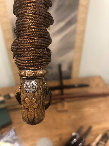

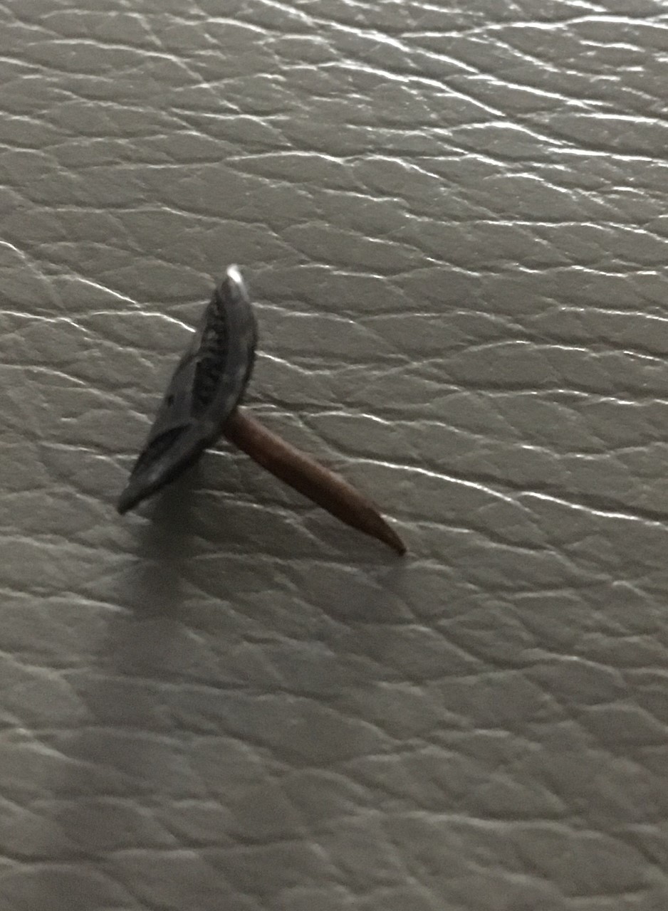

IJASWORDS Posted April 11, 2020 Report Posted April 11, 2020 Ok Bruce, at great expense, I investigated a mon for you by pulling one apart. For comparison...... Compared to yours. Your hole is much lower than a mon hole. Your hole is much bigger than my hole. My securing pin is the size of a thumb tack. Yours was never soldered in place. That's why I am comparing it to a push fit type. But saying all that, different makers could do different things. Now I gotta repair my sword, things I do for the NMB! 5 Quote
Bruce Pennington Posted April 11, 2020 Report Posted April 11, 2020 "No greater love..." Neil, "than a guy who lays down his Kai for his friends"! I think I read that verse somewhere? I scanned the Mon thread and there are some with mon much lower than yours. But it still doesn't make sense that the holes are on both sides. I'm sure I haven't seen a kabutogane with mon on both sides, have you? {but I fear we're side-tracking this great thread} 1 Quote

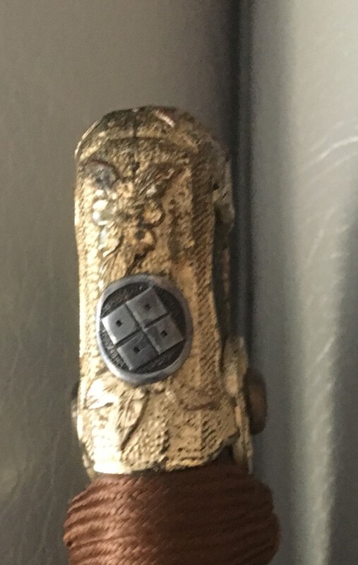

Guest Posted April 11, 2020 Report Posted April 11, 2020 Just looking at the hole position on Bruce's Kabutogane: Could it be for a 2 kanji name tag as shown in this one of Neil's from the Mon thread? Quote
IJASWORDS Posted April 11, 2020 Report Posted April 11, 2020 Malcolm, there is a difference. In Bruce's example, the leaves below the cherry blossom have not been removed for a mon to sit flat. In the example you compare it to, the leaf has been cut away to fit a mon. 2 Quote
Bruce Pennington Posted April 11, 2020 Report Posted April 11, 2020 They weren't cut away in Thomas' example, though. Differences with Thomas' and mine - his was punched in for the "pin" where mine looks drilled (though Neil's looks drilled, too). Differences in methods are easily explained by different shops, different techniques. But my key problem is the holes are on both sides of the kabutogane. Quote
Ontario_Archaeology Posted April 11, 2020 Report Posted April 11, 2020 On this example it doesn't look like the bottom blossom has been replaced. As for a hole on both sides, is there any examples of Gunto with more than 1 type of mon on it? I do recall examples with multiple mons on it, but I can't remember if they were all the same or not. In a previous thread I think I remember seeing them in some unique places. Hopefully this helps. Thanks Matt Quote
Bruce Pennington Posted April 11, 2020 Report Posted April 11, 2020 EAA084D4-09A6-4997-9FCE-8F4A04B0C312_1586527338779.jpg On this example it doesn't look like the bottom blossom has been replaced. As for a hole on both sides, is there any examples of Gunto with more than 1 type of mon on it? I do recall examples with multiple mons on it, but I can't remember if they were all the same or not. In a previous thread I think I remember seeing them in some unique places. Hopefully this helps. Thanks Matt Matt! That’s exactly in the right place as the one I have. Quote

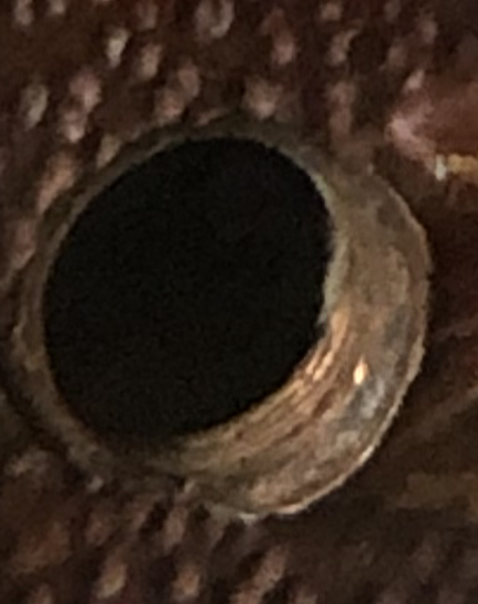

IJASWORDS Posted April 11, 2020 Report Posted April 11, 2020 Bruce I forgot to ask, are the holes threaded? Quote
Bruce Pennington Posted April 12, 2020 Report Posted April 12, 2020 Bruce I forgot to ask, are the holes threaded? I can't tell, Neil. Even magnified, I can't tell if I'm seeing threads or just two layers of something in the hole. My gut says it's threaded. Quote
george trotter Posted April 12, 2020 Report Posted April 12, 2020 Propaganda film, but wartime in date... https://www.youtube.com/watch?v=XqbOSmM9LCY Propaganda movie/pics...you might be right Dave..could this be another example of us westerners 'inventing' things (Type O, 3, 44 etc)...I think we need proof that they jumped out of planes wearing swords....Nick? Quote

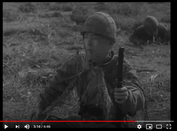

Dave R Posted April 12, 2020 Report Posted April 12, 2020 Propaganda movie/pics...you might be right Dave..could this be another example of us westerners 'inventing' things (Type O, 3, 44 etc)...I think we need proof that they jumped out of planes wearing swords....Nick? The point of the film, is that the Japanese audience believed that Para's jumped with swords, and the Japanese authorities wanted the audience to believe. Personally, I think they did, but that does not mean they all had a bespoke sarute or a special sword. Quote

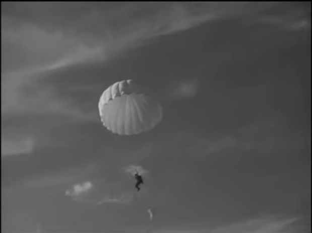

Jareth Posted April 12, 2020 Report Posted April 12, 2020 I agree with the propaganda aspect of the film plus the culture of the sword. I had read at least two references that once pilots entered their planes & photos were over the pilots handed their swords back to mechanics etc. I believe paratroopers, based on the patriotic film footage had their swords with them but uncertain if they actually jumped with them lose, or where they secured in drop leg bag or in mass inside a drop container Quote
Dave R Posted April 12, 2020 Report Posted April 12, 2020 If you watch the film carefully, you will see drop bags and swords in use. Quote
Jareth Posted April 12, 2020 Report Posted April 12, 2020 That's a very well known, famous patriotic propaganda film. Don't know how accurate it was to actual airborne combat drop. Leg bags were also used for rifles etc. They also used drop containers Quote
PNSSHOGUN Posted April 12, 2020 Report Posted April 12, 2020 Well whatever was filmed appears to have been a full Paratroop exercise so at least all of that footage is 100% "correct". 1 Quote
Jareth Posted April 12, 2020 Report Posted April 12, 2020 It's as inconclusive as the opening subject. Unless new info surfaces we will never know if sarute design was just another private purchase motif or an indication of airborne 1 Quote

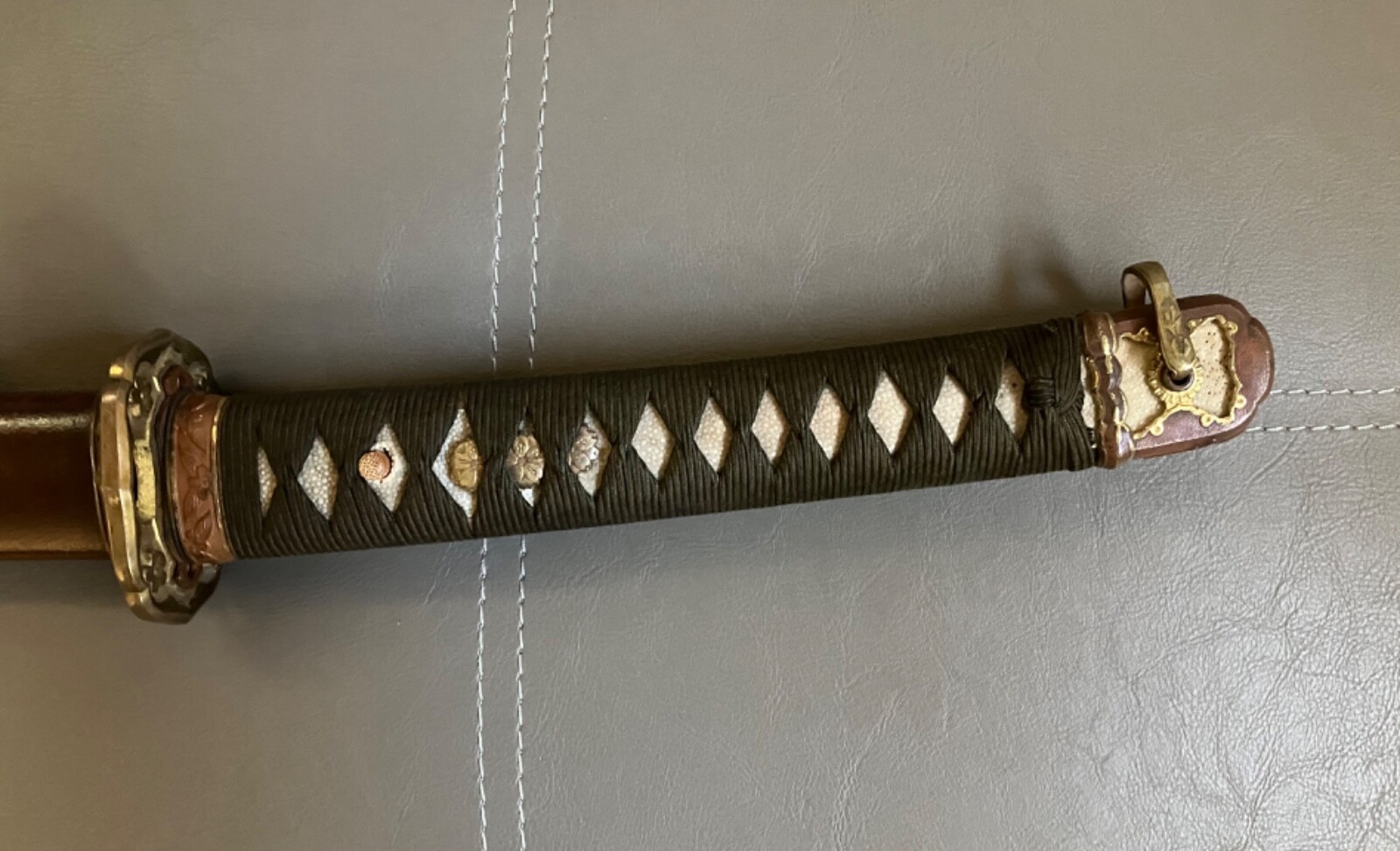

Bruce Pennington Posted October 25, 2023 Report Posted October 25, 2023 Came across another one of these sarute on this ebay sale. On a seperate note, look at this odd sakura leaf: An odd thing about this rig, is the tsuka looks to be brand new, like a recent creation, vs the saya that is very worn. Quote
PNSSHOGUN Posted October 25, 2023 Report Posted October 25, 2023 The Saya doesn't appear to be original and is a prewar style while the handle/Tsuba is from later in the war. 1 Quote
