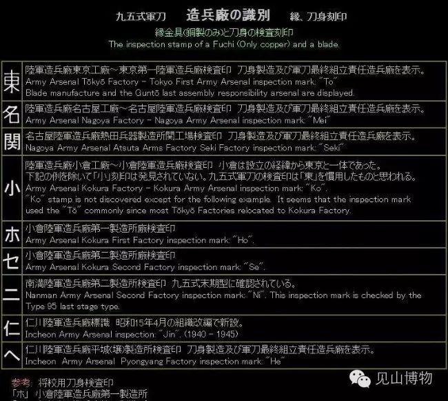

Take in the table the column M, then scroll down to line 9 and you have Stephen kanji « ko » translated just under, M9=ko.
It is the Ko meaning small as opposed to Chu (medium) and Dai or Ô meaning (big).

Chris,
From the Ohmura website, they are both Kokura insp
 "Army Arsenal Kokura Factory - Kokura Army Arsenal inspection mark: "Ko".
 "Ko" stamp is not discovered except for the following example. It seems that the inspection mark
 used the "To" commonly since most Tokyo Factories relocated to Kokura Factory.
 "Army Arsenal Kokura First Factory inspection mark: "Ho"."
Thanks Bruce, i tought so. KO stands for Kokura and HO for first Inspektion.
