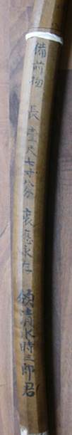

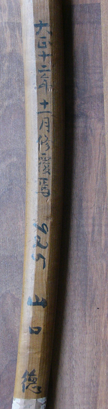

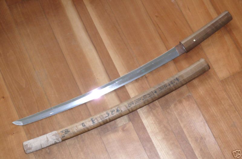

very interesting Sayagaki on both sides of saya.

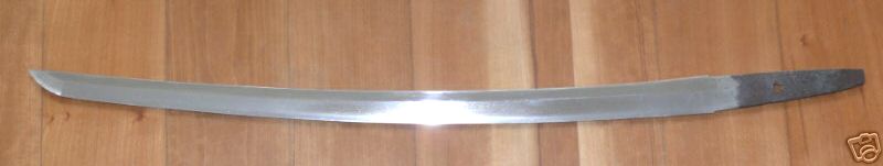

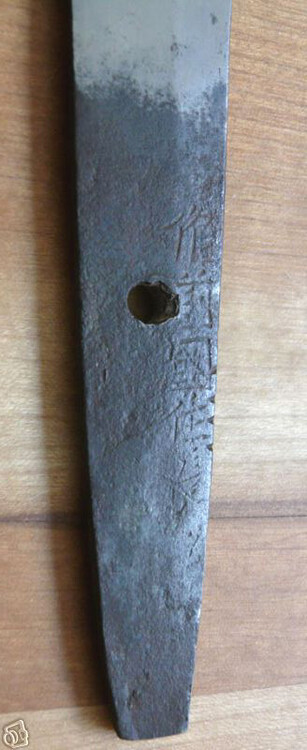

there is a date 1923 and a name Yamaguchi Toku, . This sword is from Bizen province,from what i can maake out. The original owner's name was Tokisaburou Simizu (1394-1428). Tang is signed on both sides. this information was obtained from the previous owner could any body fill in the gaps .. i have been checking some of the kanji on the very useful meiboku site. have more pics

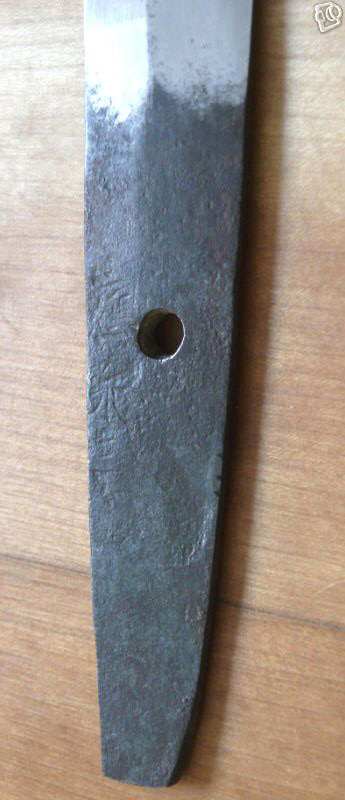

One gap is the nengo mentionned on the saya-gaki. On the sashi-ura of the blade can be read:
Oei san (Oei period three...). This could be third year or san-ju.... (30th year or later). Oei-period lasted for 35 years. This is the dating of the sword and does not refer to the name Shimizu Tokisaburo.
reinhard

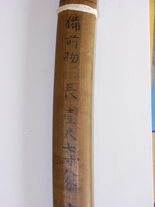

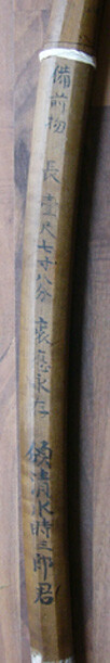

Whole sayagaki;
備前物 (Bizen mono) a product of Bizen
長壹尺七寸八分 (Nagasa ichi shaku shichi sun hachi bu) – Length: 1 shaku 7 sun 8 bu
裏應永在 (Ura Oei ari) – There is “Oei” on the Ura side.
領清水時三郎君 (Ryo Shimizu Tokisaburo kun) received from (?) Mr. Shimizu Tokisaburo
大正十二年十一月修覆焉 (Taisho ju-ni nen ju-ichi gatsu Shufuku (en)) Nov. 11th 1923, Restoration
925
山口徳 (Yamaguchi Toku??? (too many other readings))

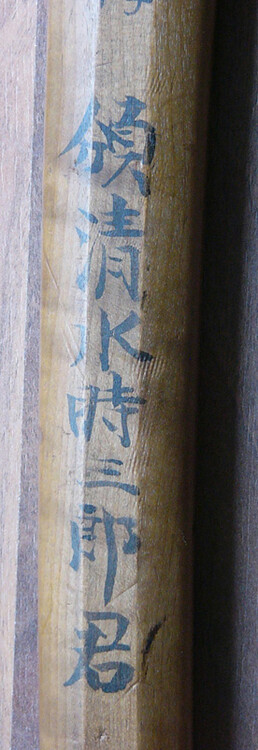

Whole sayagaki;
頒清水時三郎君(wakeru Shimizu Tokisaburo kun) Give or Gift to Mr. Shimizu Tokisaburo
Guest reinhard
You got it right. "Mono" just means "thing/object/ware".
reinhard
I have never thought of the question until reading your post. I think the usage is common as well as Soshu-mono, Mino-mono, and so on.
As my personal opinion, I think that when you say Bizen-mono (備前物), it must be of Bizen tradition AND must be made in Bizen, while Bizen-den (備前伝) does not necessarily mean made in Bizen :idea:
