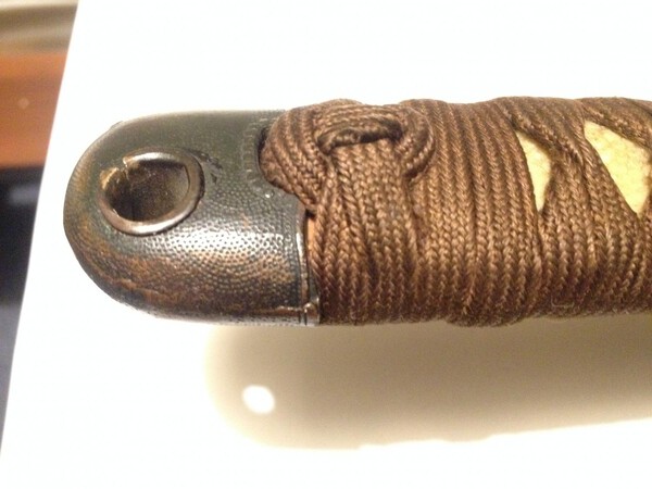

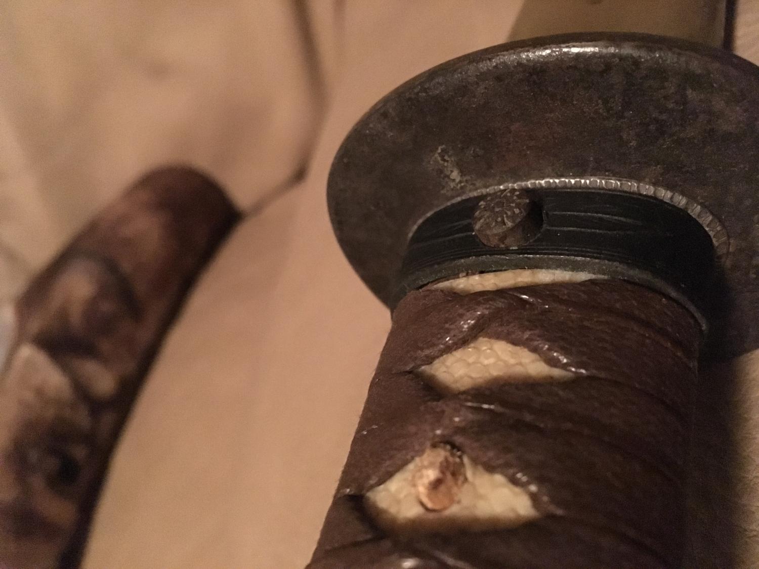

Bruce Pennington Posted February 4, 2018 Report Posted February 4, 2018 Kyle, yours looks like one I have so I checked, and mine has the same copper color. I haven’t tried to test it to see if it’s actually copper. Mine has the same plastic same’ and saya color. Quote

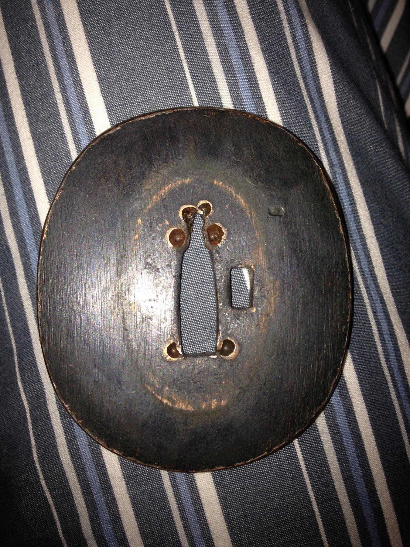

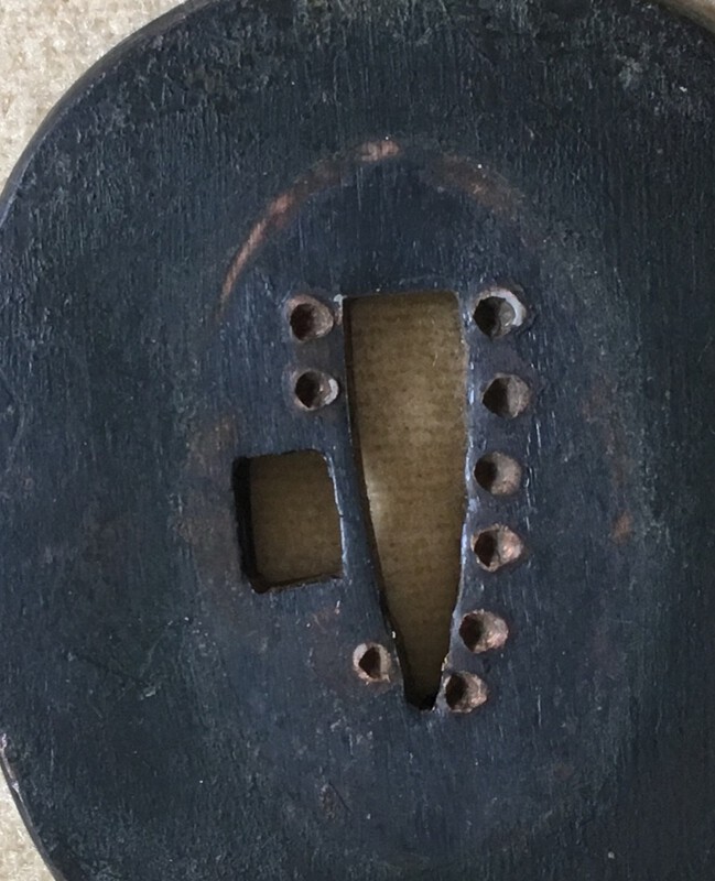

Bruce Pennington Posted February 4, 2018 Report Posted February 4, 2018 This is an old pic of the tsuba. When I get time, I'll take a file to the nakago ana and see what I find. Quote
IJASWORDS Posted February 4, 2018 Report Posted February 4, 2018 Guys I tested all my copper looking pattern 3 copper "looking" fittings with a fridge magnet, all were attracted. So copper plated and painted iron. Don't use a file!!! 3 Quote

vajo Posted February 4, 2018 Report Posted February 4, 2018 I tested now (magnet) all my 5 Type 3 Gendaito (4 Star Stamp, one Nagamitsu). Fittings and Tsuba are all iron no copper. Maybe it has to do something with the quality of blades and fittings? What blades you have? @ Bruce you have no plastic same. It is celluloid made from "guncotton" and camphor. Quote

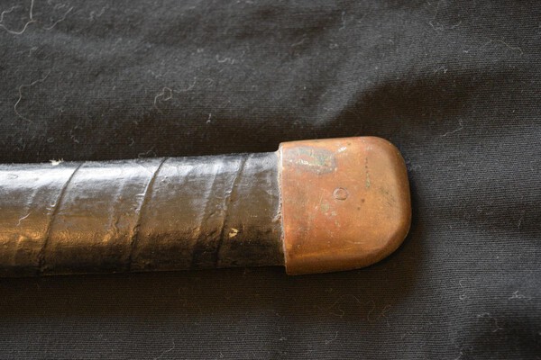

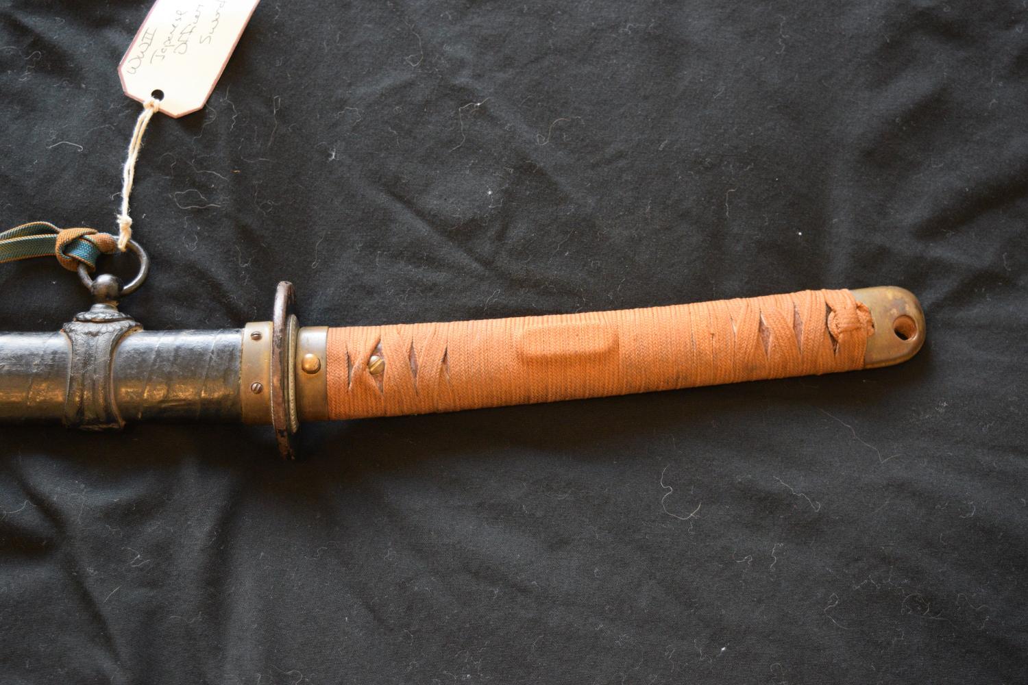

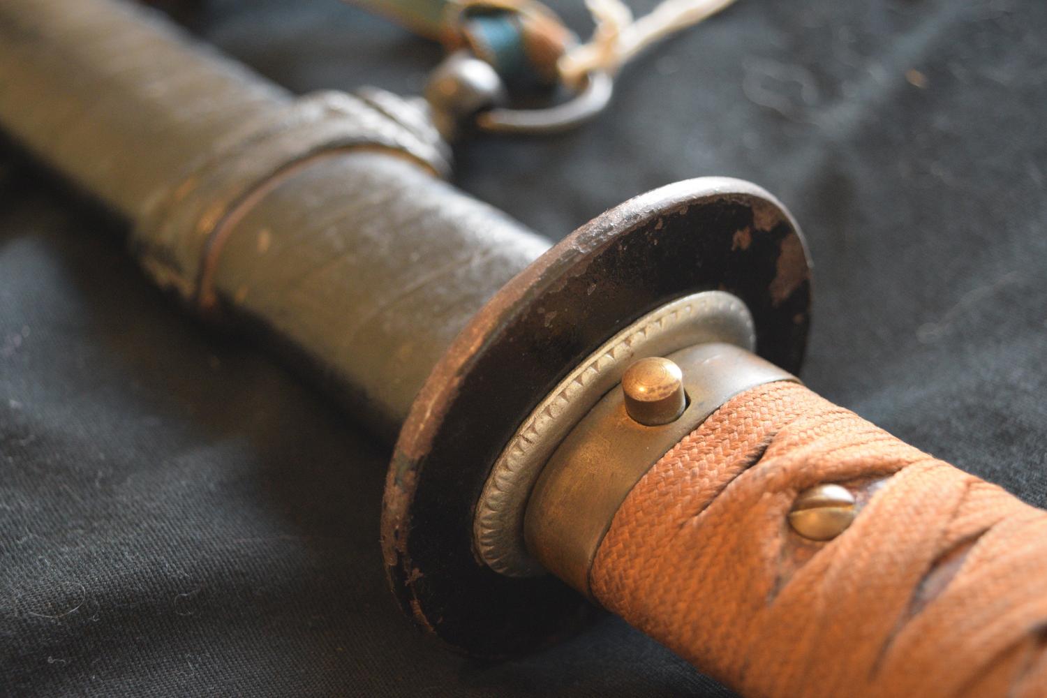

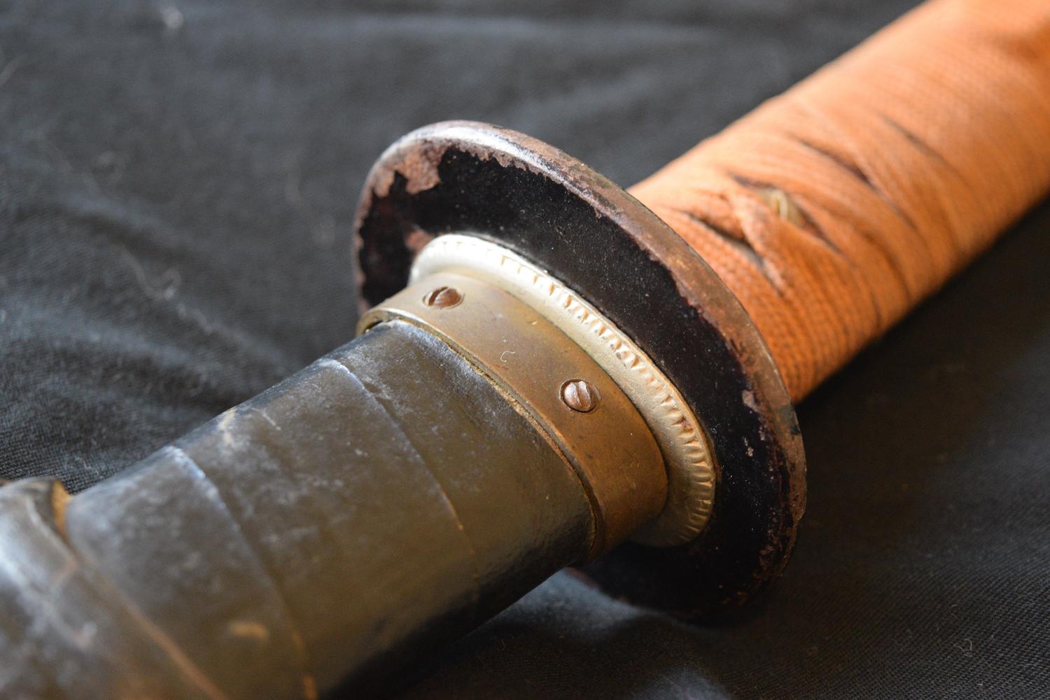

reeder Posted February 4, 2018 Report Posted February 4, 2018 This is the copper fitting variation referenced by Fuller & Gregory. There’s also pictures of one in Dawson’s book. Edit: Added higher res pictures 1 Quote
Bruce Pennington Posted February 4, 2018 Report Posted February 4, 2018 On 2/4/2018 at 11:23 AM, vajo said: @ Bruce you have no plastic same. It is celluloid made from "guncotton" and camphor. That's interesting Chris! I had never heard what it's made of, thanks! On 2/4/2018 at 2:14 PM, reeder said: This is the copper fitting variation referenced by Fuller & Gregory. There’s also pictures of one in Dawson’s book. Edit: Added higher res pictures Thanks for the pics Brandon. So my stuff looks like the steel tsuba, coated with other stuff then, because they clearly don't look like the coopper in those pics. I'll try the magnet later today, but I suspect it will work out like Chris' experience. Thanks guys! Interesting discussion and discovery. 1 Quote

reeder Posted February 4, 2018 Report Posted February 4, 2018 Fuller & Gregory and Dawson list the mounts as potential prototype mounts, not last stage. Mine has a 1943 star stamped blade. The authors do not list the date/maker of their pictured swords so we're stuck with one data point for now, unless someone has or has seen another. Quote

reeder Posted February 5, 2018 Report Posted February 5, 2018 On 2/4/2018 at 9:07 PM, vajo said: For me Ohmura sans work is important in that case. He says last stage. Ohmura has 3 listed, 2 star stamped dated 1943 & 1944, and the third dated 1943. Maybe last stage, maybe not. Most examples have mid-war gendai, doesn’t sound too much like last stage to me. But what do I know? On 2/5/2018 at 2:28 AM, J Reid said: Guys... never do irreparable damage to your swords just to "confirm" something. Find another way... As found condition and/or restoration only, right? not sure what you’re referencing, replied to wrong thread? Quote
J Reid Posted February 5, 2018 Report Posted February 5, 2018 On 2/4/2018 at 3:08 AM, Bruce Pennington said: This is an old pic of the tsuba. When I get time, I'll take a file to the nakago ana and see what I find. ^^ 1 Quote
Bruce Pennington Posted February 5, 2018 Report Posted February 5, 2018 Ok, I checked - the tsuba is steel! Quote
