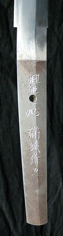

obiwanknabbe Posted January 26, 2018 Report Posted January 26, 2018 34.5 inches overall length... 23.75 inch nagasa...So i think i'm 99.99% correct in thinking that this is a cut down Mantetsu (which honestly i dont think i have ever seen before)... The placement of the mei in relation to the mekugi ana, in conjunction with the yasuri mei variations, seems to indicate it was a katana cut to wakizashi size ... but... i'm .01% curious.. is there an off chance this is a factory wak? Quote
PNSSHOGUN Posted January 26, 2018 Report Posted January 26, 2018 Compare to this one Ed had: http://www.militaria.co.za/nmb/topic/23002-mantetsu-wakizashi/ Reckon you're right, suriage. Is it still in Shin Gunto mountings? They were popular Tameshigiri swords for some time so it would be consistent with shortening to suit them. Quote

Dave R Posted January 26, 2018 Report Posted January 26, 2018 34.5 inches overall length... 23.75 inch nagasa...So i think i'm 99.99% correct in thinking that this is a cut down Mantetsu (which honestly i dont think i have ever seen before)... The placement of the mei in relation to the mekugi ana, in conjunction with the yasuri mei variations, seems to indicate it was a katana cut to wakizashi size ... but... i'm .01% curious.. is there an off chance this is a factory wak? Likely, indeed almost certainly a suraige blade, but still within regulation length, and a little long for "crew mounts". I have read elsewhere that Gunto no Soho put some emphasis of speed of draw, so my guess is it was shortened to facilitate that. It was in field mounts rather than formal ones after all. An online conversation about Gunto no Soho here. http://www.e-budo.com/archive/index.php/t-14638.html 2 Quote

Ed Posted January 26, 2018 Report Posted January 26, 2018 Suriage. The last several characters of the mei are missing. Quote

Bruce Pennington Posted May 3, 2019 Report Posted May 3, 2019 34.5 inches overall length... 23.75 inch nagasa...So i think i'm 99.99% correct in thinking that this is a cut down Mantetsu (which honestly i dont think i have ever seen before)... is there an off chance this is a factory wak? I was reviewing this discussion and noticed the hamon carries around the curve of the kissaki, meaning the tip wasn't shortened, so for the nagasa to be shorter than standard, someone had to move the hamachi and munemachi. This is not hard, I guess for a professional. Anyone know if there is a way to tell? I agree with Kurt that the mei is correctly placed around the mekugi-ana. Is there a standard distance from the ana to the machi? If the machi were moved, this might show in the measurement? Quote
PNSSHOGUN Posted May 4, 2019 Report Posted May 4, 2019 On a new Suriage there would be a large gap from the filemarks to the Machi one would imagine. Quote
