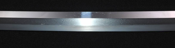

Hey guys,
so this time for real a blade that I like. There's also a very nice koshirae with it but I know a lot more about tosogu than on nihonto themselves.
My thought is of course for the signature, also the to me strange seeming file marks on the nakago. Sadly the blade has the green paper virus.
Any help and opinion is highly welcome,
Marco

Hello Marco,
if you do not mind the hadaware in the hamon, go for it if you like it and the price is ok for you. The name is a "big name" in Osafune, so consider it gimei, when judging the price.
Concerning "strange file marks": it is hard to make out, since the pics do not show the full length of the nakago, but observed in the full blade pic. I guess I can see a "machiokuri-job" e.g. the machi moved up and therefore new horizontal filemarks added to the otherwise older looking nakago surface.
Maybe it is a matter of the (black and white?) fotos, but the kanji look "sharp" considering the overal weathering of the nakago. Needs futher study ;-)
Greetings
Andreas
