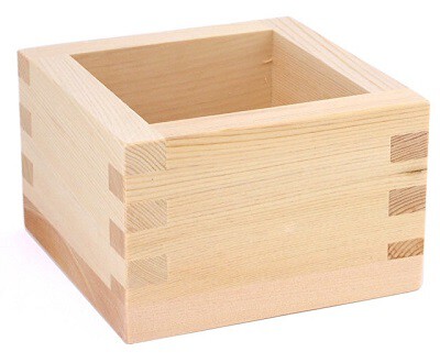

Robin Posted January 16, 2018 Report Posted January 16, 2018 I use a hinoki masu saké cup for that. With a sharp X-acto hobby knife...shave off some veneer thin strips and you're ready to go (don't cut your fingers...these knives are evil). You only need 5mm x 15mm or so, because it's advised to only apply a strip on the mune or ha side (ha side is easiest). Better not apply on the ura and omote sides of the saya....it's not needed and tension there can split a saya. Use PVA glue. I have to do this once every 2 or 3 months, because I practise iaido almost daily. Robin
Greg F Posted January 19, 2018 Author Report Posted January 19, 2018 Hi guys thanks very much for the replies and thanks for moving this to the wanted section. In the past ive used 5 mil wide shavings of pine on the ha or mune ends of China made martial arts swords but this time its for a Nihonto blade so thought it best i use hinoki to be a little more traditional. I have gone with the hinoki saki cup for around ten bucks on ebay. All the best. Greg
