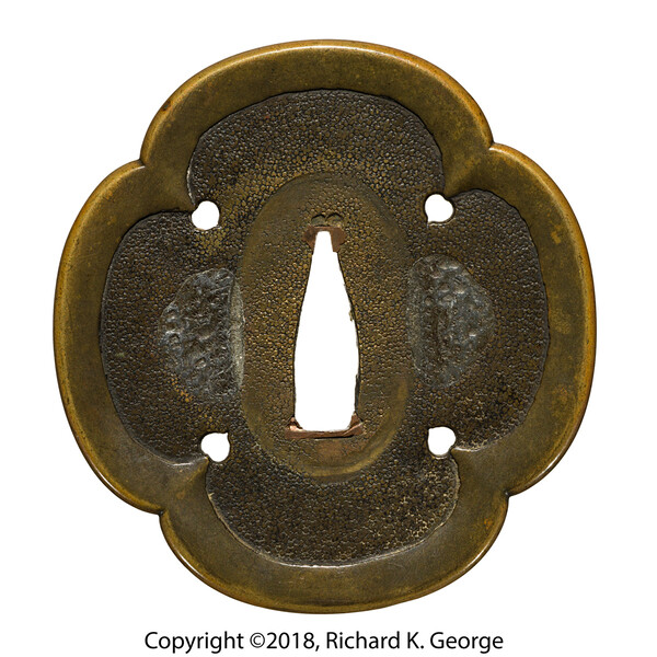

rkg Posted January 12, 2018 Report Posted January 12, 2018 Hi, I've been busy (re) shooting stuff, and here's another new piece you might find interesting. the piece is made from brass (obviously), and measures 78.5mm (H) X 74.3mm (W) X 3.68mm (T, web, measured at nakago ana), 5.59mm (T, max). The surface treatment on the web appears to be irregular sized nananko. The piece has old T.K. papers to tachishi, though I still don't have a good feeling for what the actual distinction is between the tachi-shi bin and the tachi-kanagu-shi bin - the books say the tachishi guy did the prep work for the tachi-kanagu-shi tsuba maker, but both also just made pieces - whaaaaat?....... Anyway, I'd guess its Momoyama to early edo period work, but what do I know.... Enjoy, rkg (Richard George) 4 Quote

John A Stuart Posted January 12, 2018 Report Posted January 12, 2018 Do not the hitsu preclude this being a tsuba for a tachi? Tachishi and Kanaguchishi. I must confess, I see no distinction. John Quote
Iekatsu Posted January 12, 2018 Report Posted January 12, 2018 The Hitsu ana could be later additions, they cut through the Nananko, at least cut after the plate was decorated. A nice piece, id say Momoyama/early Edo. Quote
christianmalterre Posted January 12, 2018 Report Posted January 12, 2018 not early..... rather mid to latter Edo - but! well! done! me Quote
nagamaki - Franco Posted January 13, 2018 Report Posted January 13, 2018 Hello, Please forgive my lack of understanding, but I'm a bit confused by the use of the term nanako vs ishimei to describe the surface treatment of this tsuba. What am I missing? Thank you. Quote
rkg Posted January 13, 2018 Author Report Posted January 13, 2018 Franco, that's a fair question I think -it could well be some ishime variant, I just don't recall one that looks like this/it just doesn't look stone like to me really... Anybody out there know what it -really should be called? thx, rkg (Richard George) On 1/13/2018 at 6:42 AM, nagamaki - Franco said: Hello, Please forgive my lack of understanding, but I'm a bit confused by the use of the term nanako vs ishimei to describe the surface treatment of this tsuba. What am I missing? Thank you. Quote

Iekatsu Posted January 13, 2018 Report Posted January 13, 2018 On 1/12/2018 at 11:40 PM, christianmalterre said: not early..... rather mid to latter Edo - but! well! done! me What makes you think Mid-late Edo? Quote
Alan Morton Posted January 13, 2018 Report Posted January 13, 2018 Christian Do you think Norisuke family? Quote

rkg Posted January 16, 2018 Author Report Posted January 16, 2018 Christian, I have to disagree on the age. Its older than that (the brass corrosion deposits in the inome holes are original and really thick - The more I study it, the more I wonder if its even as late as Momoyama). And yeah, the hitsu/plugs were added later. Best, rkg (Richard George) On 1/13/2018 at 10:11 AM, Hitori Iekatsu said: What makes you think Mid-late Edo? Quote
Iekatsu Posted January 19, 2018 Report Posted January 19, 2018 Its unlikely to date before Momoyama/early Edo, Shinchu was an expensive material (mostly imported from china), before Momoyama it is generally only seen in Fukurin and Zogan. Quote
