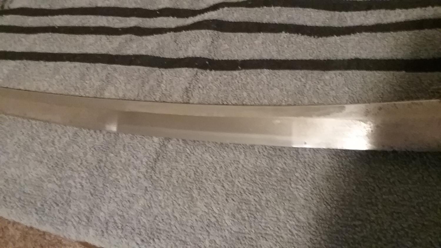

dwmc Posted December 28, 2017 Report Posted December 28, 2017 Hello Members, I decided to post this as more of a "Show and Tell" for those of us who have a few of the Showa Era non-traditional forged swords, non-tamahagane swords, etc... I purchased a mumei sword many years ago (very reasonably) after noticing, even in a very out of polished state, it had a prominent hada. Almost an Hadatatsu/Hadamono type. The sword was what I thought appeared to be a high Shinogi Yamato appearing Koto blade. However the Nakago simply didn't bear this (hopeful) opinion out...just didn't have older Koto look. Shin-shinto era copy maybe??? Anyway, I eventually took it to the San Francisco sword show in 2012. Showed it to many of the sword dealers, upon looking at the sword, most had the look of someone who had just taken a large shot of extremely high proof alcohol... Eventually, I ended up at the booth of Mr. Bob Hughes who had invited Mr. Nagamasa Ikeda, a well known Togishi to offer some minor sword repair work during the sword show. I immediately jumped at the opportunity to have window polished in the sword. Mr. Ikeda looked at the sword for just a very short period of time and said...Mantetsu. Mr. Hughes spoke with him briefly and returned to me and said my sword was forged using Manchurian steel. He said it was a Showa era forged sword, hince the lack of a older looking Nakago. As I mentioned earlier, the sword is unsigned, and was unsure how Mr. Ikeda had come to this conclusion so quickly, but even after he opened the window, he still maintained it was forged with Mantetsu using traditional methods. Part of his reasoning was do to the hardness of the steel. I've read a couple of articles which mention Manchurian steel was highly prized by Japanese Sword Smiths. I assume meaning for forging swords by traditional methods, although using Manchurian steel. (Not the Koa Isshin forged swords) Are these swords forged by traditional methods during the Showa era but using Manchurian steel simply a rare anomaly. I can find very little concerning the type of sword??? Dave 2 Quote

Jon MB Posted December 28, 2017 Report Posted December 28, 2017 regarding this blade, not sure I see the Mantetsu connection. 2 Quote

dwmc Posted December 28, 2017 Author Report Posted December 28, 2017 regarding this blade, not sure I see the Mantetsu connection. Hi Jon, The Mantetsu connection is based entirely off the Togishi's opinion. Dave Quote
Brian Posted December 28, 2017 Report Posted December 28, 2017 Sorry, but I'm not buying the Mantetsu attribution. Showa yes. Made by adding foreign steel..yes.But Mantetsu? Nope...not imho, sorry.I think sometimes Westerners have more experience with Showato and Gunto than many in Japan. Just my opinion of course. 3 Quote
Stephen Posted December 28, 2017 Report Posted December 28, 2017 Maybe the togi just meant Chinese made??? Quote

dwmc Posted December 28, 2017 Author Report Posted December 28, 2017 Sorry, but I'm not buying the Mantetsu attribution. Showa yes. Made by adding foreign steel..yes. But Mantetsu? Nope...not imho, sorry. I think sometimes Westerners have more experience with Showato and Gunto than many in Japan. Just my opinion of course. Brian, Honestly, I was stunned also by the Mantetsu attribution. But my understanding at the time was it was not a Koa Isshin related sword, but simply a blade using Mantetsu steel with traditional forging methods. Stephen, I know, the sword looks pretty weird, but seriously, definitely not modern Chinese.. Dave Quote
Dave R Posted December 28, 2017 Report Posted December 28, 2017 Railway steel! Mantetsu was primarily a Railway Company, Minamimanshū Tetsudō Kabushikigaisha; Nánmǎnzhōu Tiědào Zhūshìhuìshè, which then expanded into all sorts of other activities. (Mantetsu also had a presence in Japan, not just in Manchuria and Korea.) Back in the day (Fuller and Gregory) it was assumed that Mantetsu swords were in fact made out of old rail track, whereas we now know a lot more about them, especially the Koa-Isshin blades. I think our Togoshi was possibly just meaning that he thought it was rail track steel, Mantetsu would be the maker that would then spring to mind. This would also account for it being a very hard steel, with a grain, but also not worth signing at the time. A Seki special. Btw, it should be one hell of a cutter, being a high carbon manganese steel 1 Quote
David Flynn Posted December 28, 2017 Report Posted December 28, 2017 interesting, there isn't a defined Nioi Guchi. 1 Quote
dwmc Posted December 28, 2017 Author Report Posted December 28, 2017 Railway steel! Mantetsu was primarily a Railway Company, Minamimanshū Tetsudō Kabushikigaisha; Nánmǎnzhōu Tiědào Zhūshìhuìshè, which then expanded into all sorts of other activities. (Mantetsu also had a presence in Japan, not just in Manchuria and Korea.) Back in the day (Fuller and Gregory) it was assumed that Mantetsu swords were in fact made out of old rail track, whereas we now know a lot more about them, especially the Koa-Isshin blades. I think our Togoshi was possibly just meaning that he thought it was rail track steel, Mantetsu would be the maker that would then spring to mind. This would also account for it being a very hard steel, with a grain, but also not worth signing at the time. A Seki special. Btw, it should be one hell of a cutter, being a high carbon manganese steel Thank You Dave...Your explanation makes perfect sense, and yes I'm sure it would be a excellent cutter. Thanks again, Dave Quote

Brian Posted December 29, 2017 Report Posted December 29, 2017 Namban-tetsu, that's where I would have put it. Japanese steel mixed with imported foreign steel, giving the high contrasting hada that we sometimes see in Showa era.Either way, a very striking sword and far more interesting than most Showato and even many Gendaito. 3 Quote

lonely panet Posted December 29, 2017 Report Posted December 29, 2017 I'm abit on the fence guys, something is odd about the hada/"Dimaschq". whys does the hada stop above the hamon looking HA. Mr Flynn has pointed it out too, no noi-guchi, no nothing, just a white area 2 Quote
Stephen Posted December 29, 2017 Report Posted December 29, 2017 I think what's throwing me off is the polish....to heavy with the acid. 2 Quote
Dave R Posted December 29, 2017 Report Posted December 29, 2017 I doubt very much that the Japanese togoshi used any acid on the window polish, though I look forward to a confirmation from Dave that no acid treatment was used later. What I took away from this is that it has a "window polish", as in, not the full blade. I have in fact seen something similar at one of the Northern To-Ken Society UK meetings, and if I remember rightly it had the same sort of issue with the hamon. 1 Quote
Stephen Posted December 29, 2017 Report Posted December 29, 2017 Well i respectfully agree to disagree. But i wasn't standing there for each moment of his work. So what do i know? Quote
Brian Posted December 29, 2017 Report Posted December 29, 2017 I wouldn't be surprised at all to find out that quick window polishes at shows use water with an additive to show as much as possible. Using mild acid with a quick window polish would show as much as possible as fast as possible, and a polisher would know how to completely neutralize it. Not saying it was done...but I am saying it is not counted out.We do know that some modern polishers do use some form in some way. But they know what they are doing with it. 1 Quote
