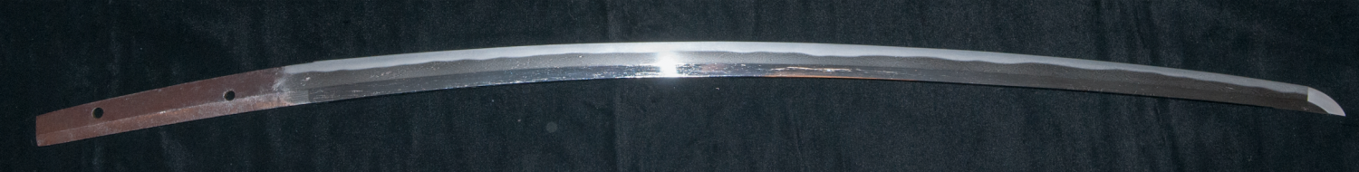

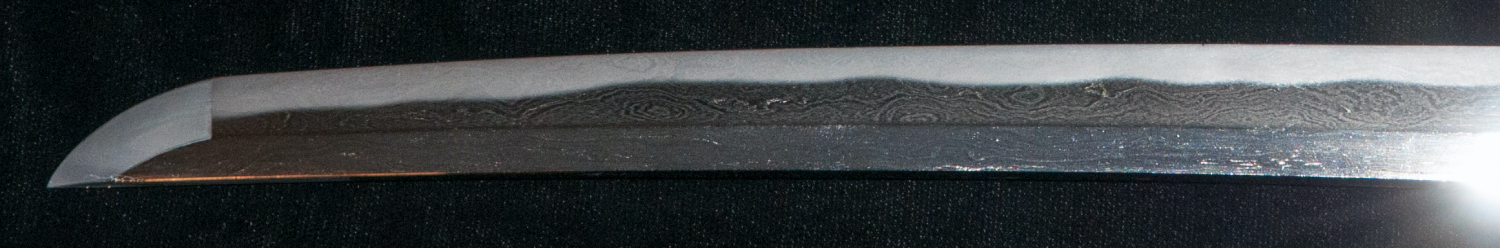

Haven't sent it to shinsa yet.  We had a bit of a debate at the show before I sent it.  Most thought it was a kamakura period sword and many thought it was Yamato.  But this mokume is really prominent, so I'm not at all sure - maybe late kamakura Yamashiro?  This could be wishful thinking.  There is lots of hataraki in the hamon.  Would love to hear what the NMB board experts think.  We shall see!
I kinda jumped in there with both feet with the Gassan, when I saw the Hada that was my first thought, although first thoughts are often wrong.
Looks good, I bet you cant wait to see it in hand. :)
Robert
What leads you towards Yamashiro?
I would go with Ray on Uda but not Ko-Uda. There are a number of other possibilities such as Namnohira or Kongo-Byoe which I would look at as well
All of these have Yamnato influence but the strong differences seen in the colour of the steel looks something  more rural or northern province.
I have asked Mishina San's opinion and am waiting to hear.  I will put up a couple more photos when I get home, but most are like this one.
It seems that there is a consensus. My modest opinion is that the sword is strongly influenced by Norishige, so I will go to Nambokucho, either Uda or Tametsugu, Shitahara is also a good call due to its origin, difficult to say without other pictures. Nice sword.
  • Like 4
Mishina San agrees with you Jean (though I don't think he reads the NMB!).  His opinion was Etchu Norishige from Nanbokucho or early Muromachi.

From the examples I have seen, the Norishige den call seems better than shitahara, based on the hamon.  I have a blade that has been kantei'd as shitahara and the hamon is very different than this one, which is wild like the examples that are available of Norishige school hamon.  An example is one in the link below, very similar to what is on my blade.  Hamon on mine is like that on the fourth blade down, which simply says Etchu Norishige.

 I hope you are right in your expectations Bob, however I would be cautious about inferring too much from the hamon, which is after all a secondary kantei consideration after jihada. The illustrated jihada you refer to seems quite different, with a less flowing nagare pattern and with the mokune or itame smaller.

I like Jeans guess above. Mumei swords are to me extremely difficult to judge. Here are 3 examples and Norishige - Tametsugu - Ko-Uda are different tiers
Here is a tanto that got TH to den Tametsugu: http://www.aoijapan.com/img/sword/2015/15856-2.jpg
And for comparison jūyō Norishige: http://www.aoijapan.com/img/sword/2016/16443-2.jpg
Here is Ko-Uda blade which is polished in style that seems to bring out jihada: http://www.aoijapan.com/img/sword/2012/12552-2.jpg
Arnold, I am always prepared for the worst and hopeful for better if not best!  Jussi, those are great examples and the Norishige is the closest to my eye.  Since Jean and Mishina San both point that way, I think that it's a good guess!  I'm uncertain about the era call.  Other than some masame in the shinogi ji (which I'm not sure that it is masame or continuation of mokume), what other attributes point to later in nanbokucho or early muromachi?  Cheers, Bob

I also thought Norishige but probably later generation. I trust Mishina san's opinion since he has polished many national treasures.

I think one consistency in the majority of opinions is that it is northern province work as demonstrated by the great variation in the steel colour and definition(by colour I am referring to the variation rather than absolute.)
with regard to age the presence of masame in the shinogi ji  Is a critical factor. Putting that to one side I don't think this blade is as early as kamakura, I cant tell you why it just doesn't look that old. My guess would be Nambokucho at the earliest but likely to be later.
