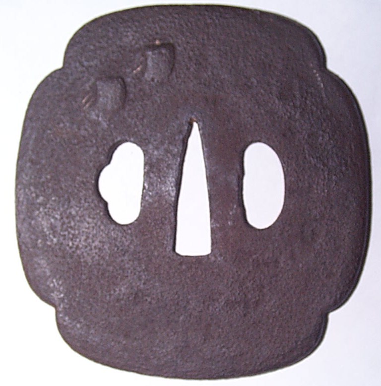

Guest nickn Posted April 16, 2008 Report Posted April 16, 2008 i have a large iron tsuba that someone has put rust remover on so its mainly a dull silver colour can any one tell me how to re-patinate it? i thought of using a gun browning solution Quote

Guest nickn Posted April 16, 2008 Report Posted April 16, 2008 thanks for the information i have used iodine to repatinate nakago but the finish is quite red even after boneing down i wonder what could be done to make the finish more like that found on old tsuba? Quote
Guest nickn Posted April 17, 2008 Report Posted April 17, 2008 i have applied iodine ,as i would for a nakago, and the rust is forming very quickly so the tsuba steel must have a high carbon content ,it does ring like a bell, i tried iodine on a piece of cast iron i had but hasnt worked very well the rust being very patchy due to the low carbon?? Quote

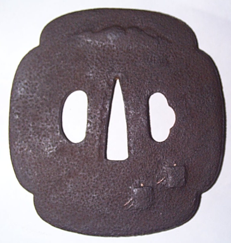

Guest nickn Posted April 24, 2008 Report Posted April 24, 2008 well i put iodine on the tsuba several times a day and have now started boneing the rust off with a piece of ivory and rubbing on a nylon carpet remember it was a grey/silver colour when i started ,i wish i had taken before photos, it least i can now see the bridge which before just looked like raised squares. the plate is well forged any thoughts on age school? Quote

remzy Posted April 25, 2008 Report Posted April 25, 2008 Looks kind of rusty and redish, which isnt a good sign at all. Quote
Guest nickn Posted April 25, 2008 Report Posted April 25, 2008 you must remeber this tsuba had been dipped in rust remover so was a grey silver colour ,i should have taken photos, and from the pitting must have been very rusty it will get better with boneing and rubbing on a piece of carpet .as you can see i have not ruined a national treasure! as for advice i was only told it was very hard to do and not to use iodine Quote
Guido Posted April 25, 2008 Report Posted April 25, 2008 it least i can now see the bridge which before just looked like raised squares.Kind of a Rorschach test, isn't it? I see sails of boats on the background of ugly red rust. Or maybe naked Swedish nuns hiding under soiled cardboard boxes. But that's just me. Quote
Bungo Posted April 25, 2008 Report Posted April 25, 2008 Is that the true color ? I see you have another dragon tsuba with the same purplish hue. milt Quote
Guest nickn Posted April 25, 2008 Report Posted April 25, 2008 at least i am getting replies to my posts! look this was a junk tsuba .i have not finished with it yet but even now it looks a hell of a lot better then it did i wish i could show you the state it was in how much do you think it would have cost to have repatinated? $100+ how much would it have been worth once done $80??? Quote
Guest nickn Posted April 25, 2008 Report Posted April 25, 2008 no its not my camera is very old the bridge tsuba is not red or purple-ish and the dragon one is perfect and has not been refinished Quote
