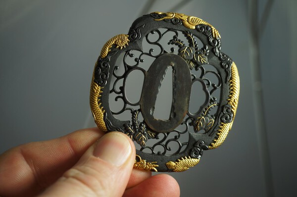

Bob, would you ind sharing some images with us please? I notice the Fuchi had been signed. Was the Tsuba also signed? I believed it to be made ensuite by one maker

Lots of interesting feedback on this one!  I am very happy with it so far.  As to juyo, I have submitted a few so far and no luck.  I have mentioned before my dream of finding a sword in the wild, getting it restored and having it go juyo.  I have three over there now in Mishina San's hands and hope springs eternal...  As to this one, in favor of it is he worked in early Oei, which, though technically muromachi (the hated term in koto it seems), it really has nanbokucho vibe.  It is signed tachi mei and has very nice horimono going for it.  I think that it's biggest attribute is that the Nobukuni mon did not make many katana or tachi at all.  They seemed to be focused on sunnobi tanto for some reason, and were very good at it.  The hada and hamon on this one are both outstanding, in my view, with the latter having a very strong "Rai" feel to it, as it should with Nobukuni emerging from Ryokai who was trained by Rai.  Anyway, if it papers in April, I will probably not be able to resist sending it to Japan for the whole dance.  I don't have any photos that were not on the website other than this one of the tsuba.  It's not world class but is very nice and all of the mounts grace the blade very well.  Cheers, Bob
Haha!  Luis, that is the auctioneer's thumb, not mine.  The tsuba is roughly 75mm in each direction. Jeremiah, some might call it courage, others stupidity.  If it doesn't paper, then I'm afraid it is the latter.  If it does paper, then maybe it's good luck.  Chris, I like that tsuba too, and since it is en suite with the F-K, it would be Yokoya work if the signature on the fuchi is good.  The mei on the fuchi is up on the site - I couldn't find a match in my brief search of Haynes and Wakayama, but the work is very good.  Cheers, Bob

I think you got a great find Robert. :thumbsup: I can't see the mei well enough in the auction pic but if I'd have to guess I too would go with Genzaemon and early 1400's. Would be really nice to see more of the sword :)
