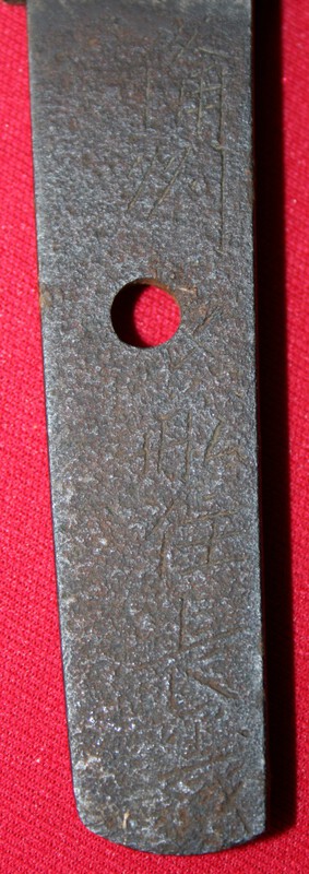

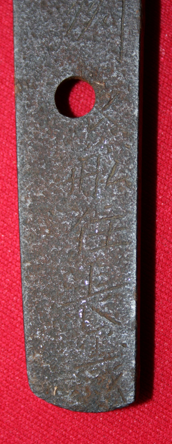

I try to read this mei. Hard to read but I think I see Bishu Osafune Ju Naga??? Can someone please confirm this and fill in the missing part. Thanks in advance!
Best regards,
Ed
John and Ray,
Thanks to both for your help. It’s highly appreciated!
So, it is Bishu Osafune ju Nagachogi.
Is it possible to find more about the smith without a date? The mei of the tanto only contains only a signature.
Best regards,
Ed
So as Ray and Stephen point out the mei can be read as either, "Bishu Osafune Nagayoshi", or "Bishu Osafune Chogi".   As to date you have to work at recognising the sugata and other features in the blade to arrive at a period and then start consulting the lists to see who was working at that time and signing in this way.
Or of course you could send it to shinsa.
Just to whet your appetite, http://www.sho-shin.com/chogi.htm bearing in mind the more famous a smith the more likely to be gime.
All the best.
Hi Geraint,
Thanks for your reply. It’s not an easy task to read the signature. I was happy about the fact that I could read most of it. So, it could be a famous name and if, so it is probably gimei. The cost for sending it to Shinsa is more than the cost of the tanto. Thanks for the link.
Regards,
Ed
