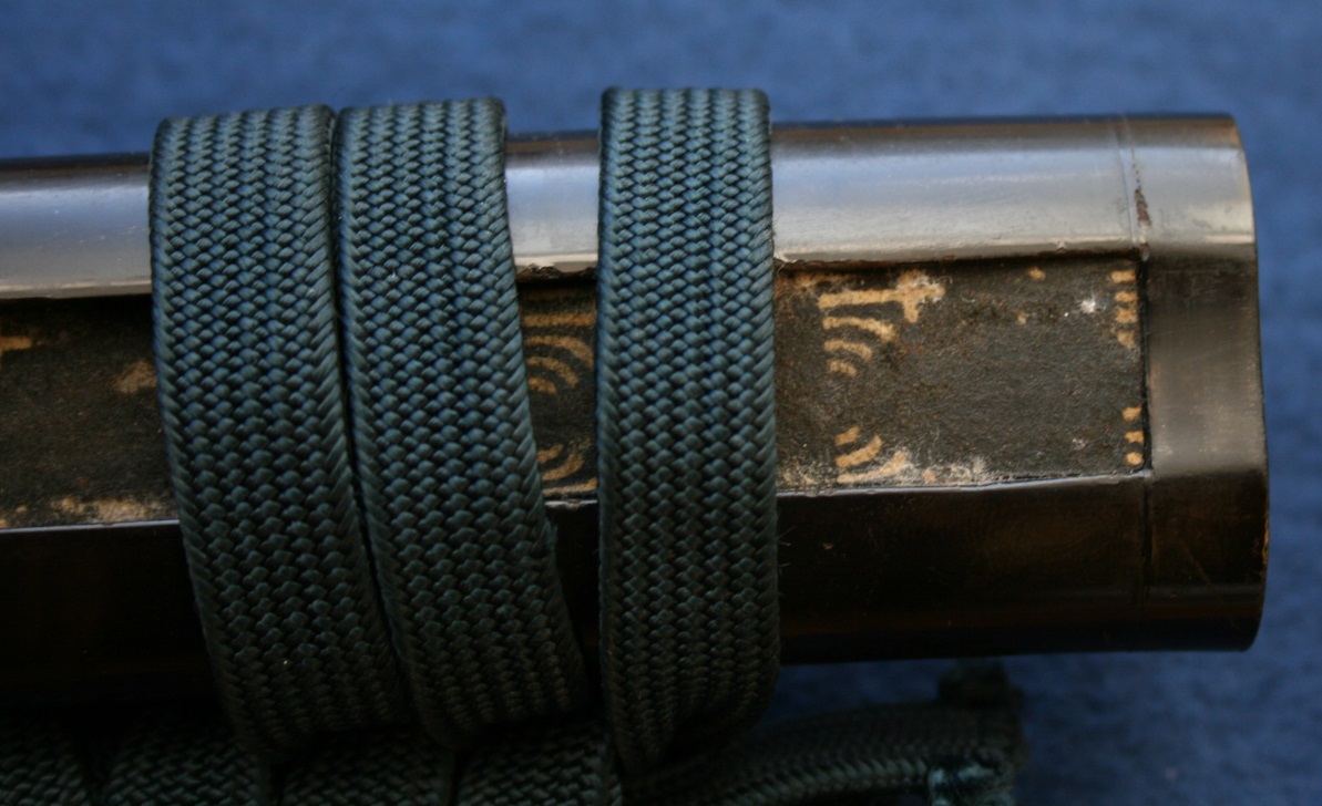

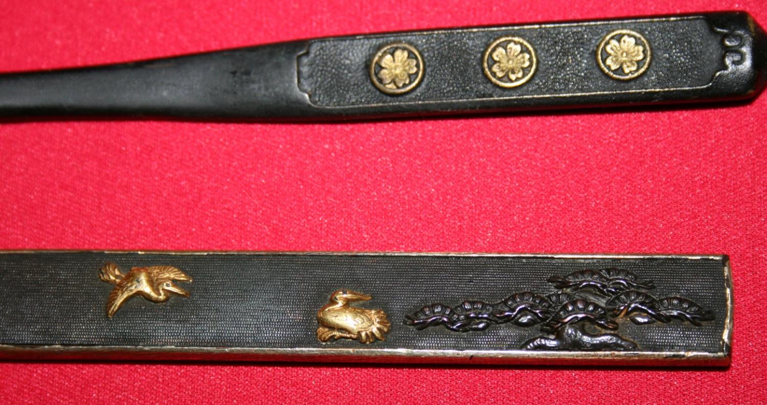

EdWolf Posted December 12, 2017 Author Report Posted December 12, 2017 Hi to all, The Kogai Bitsu and Kozuka Bitsu are on the inside decorated with some markings. Does anyone know the meaning of it or is it just some kind decoration? Does anyone have pictures of similar markings? I have never seen it before. Best regards, Ed Quote
Brian Posted December 12, 2017 Report Posted December 12, 2017 Oy vey...Christian Samurai hidden symbols again? Oddly, they are reminiscent of that. Hmmmm 1 Quote
EdWolf Posted December 12, 2017 Author Report Posted December 12, 2017 Hi Brian, Christian symbols, if have never thought of that. That would be odd. Maybe anyone else? Regards, Ed Quote
PNSSHOGUN Posted December 12, 2017 Report Posted December 12, 2017 I think "Kirishitan" is a good guess! Perhaps this koshirae was made well after 1630's.... (last major Christian crackdown by Shogunate). 1 Quote
Guido Posted December 13, 2017 Report Posted December 13, 2017 On 12/12/2017 at 12:41 PM, EdWolf said: The Kogai Bitsu and Kozuka Bitsu are on the inside decorated with some markings. Does anyone know the meaning of it or is it just some kind decoration? The inserts are made of the same stenciled deer leather (egawa 絵革) that was used for the trimming of armor. This particular pattern is called yokoshōbu 横菖蒲 and depicts stylized irises. 2 Quote
Guido Posted December 13, 2017 Report Posted December 13, 2017 And btw, that retention hook is usually only called kaeri 返り, but also kaeritsuno 返り角 or kaeshitsuno 返し角 if made of horn. 2 Quote
Henry Wilson Posted December 13, 2017 Report Posted December 13, 2017 A design also found on modern kendo bags for some reason. I recall something somewhere that illustrates the design on a fuchi. Maybe by Fred Geyer in a KTK catalog? I am at work so cannot check my bibliothèque. 2 Quote
Guido Posted December 13, 2017 Report Posted December 13, 2017 If you do a Gogle picture search for 菖蒲革 shōbugawa, it shows many examples of those iris patterns - and none lead to any Christian symbolism, hidden or otherwise: https://www.google.de/search?biw=1760&bih=908&tbm=isch&sa=1&ei=F6gwWs6AIsKr0ASL6r3wBg&q=%E8%8F%96%E8%92%B2%E9%9D%A9&oq=%E8%8F%96%E8%92%B2%E9%9D%A9&gs_l=psy-ab.12..0.61060.64858.0.67914.4.4.0.0.0.0.233.519.2j1j1.4.0....0...1c.1j2.64.psy-ab..0.1.232....0.brp42DrxIEY The iris is often seen as a decoration on Japanese items because its leaves look like sword blades; this plant is even called "Schwertlilie" in German, i.e. "sword lily". 6 Quote
