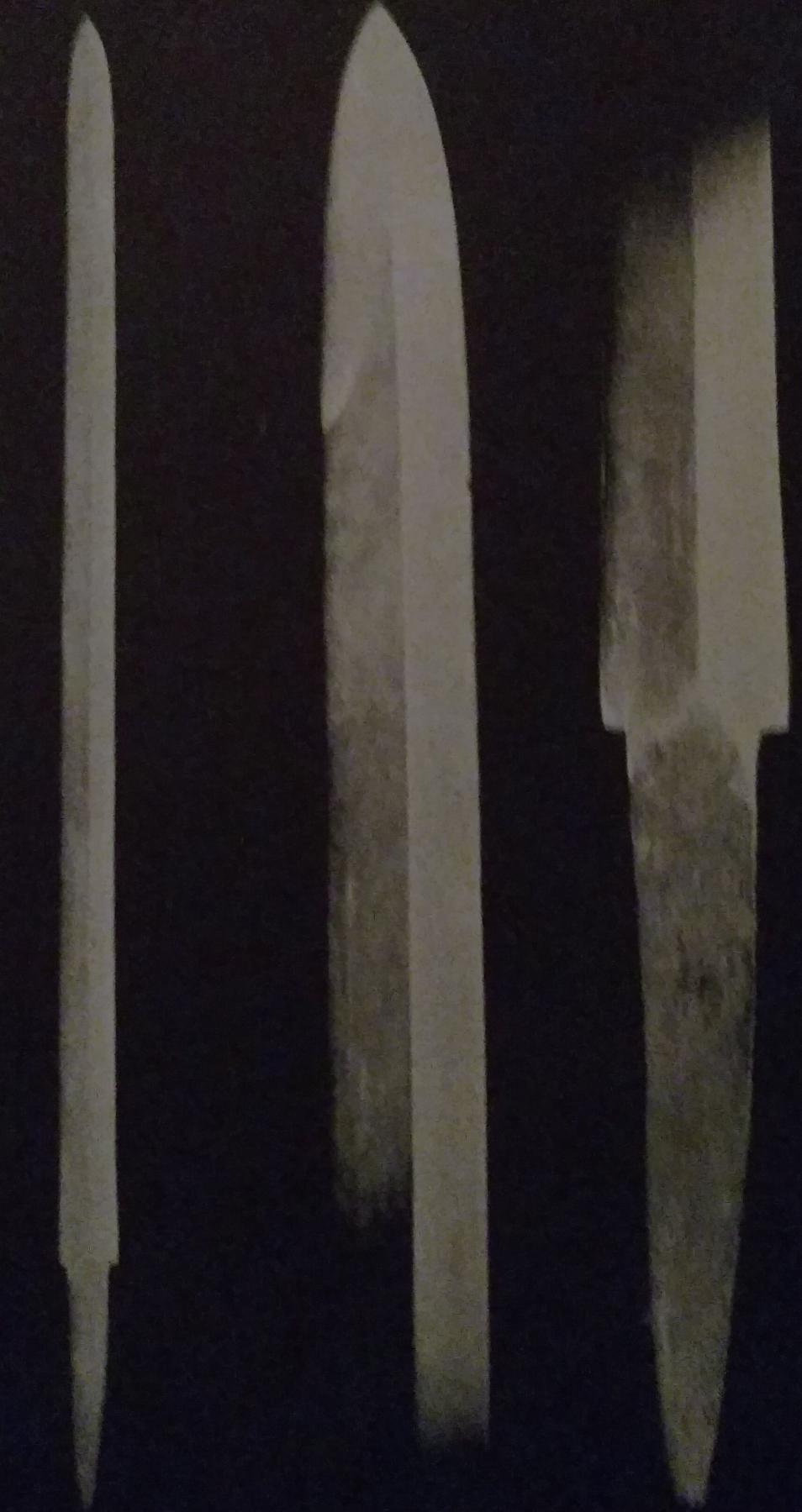

Henry Wilson Posted November 15, 2017 Report Posted November 15, 2017 Yesterday was Saitama Day meaning that I had the day off. I decided to take advantage of the fact that everyone else in the Tokyo region would be at work so I headed to Shibuya and the "Origin of Shinto" exhibition at the Kokugakuin University museum. http://museum.kokugakuin.ac.jp/fr/special_exhibition/detail/2017_kodai_saishi.html On display as part of kofun grave goods was a large kofun period sword that had been polished. What was revealed was a very nice hamon that to my tired and weary old eyes looked not dissimilar to early Bizen or Sosho work. (Kochoji in midare, I think). I wonder, does anyone have any other examples of very early swords with hamons? 2 Quote
Dave R Posted November 15, 2017 Report Posted November 15, 2017 Like this? A Warabite forged probably by the Emeshi pre -Heian. Some discussion here. http://www.militaria.co.za/nmb/topic/6107-warabite-to/ 3 Quote

ROKUJURO Posted November 15, 2017 Report Posted November 15, 2017 Henry,it seems they had similar heat treatments in the same period in Europe, but even long before in Celtic times.Look for the research results of Stefan Mäder. (http://www.schwertbruecken.de/pdf/staehle.pdf) 2 Quote
Ray Singer Posted November 15, 2017 Report Posted November 15, 2017 https://books.google.com/books?id=FmLpLkEj1LgC&printsec=frontcover#v=onepage&q&f=false Start from item #53 on page 126. 3 Quote

Carlo Giuseppe Tacchini Posted November 15, 2017 Report Posted November 15, 2017 On display as part of kofun grave goods was a large kofun period sword that had been polished. What was revealed was a very nice hamon that to my tired and weary old eyes looked not dissimilar to early Bizen or Sosho work. (Kochoji in midare, I think). I wonder, does anyone have any other examples of very early swords with hamons? Recommended reading ; Suenaga Masao "Nihon Jodai no Buki", Masakuni Ishii "Warabite-To", Honma Junji "Shoso-In no Token". You might also like my essay (http://www.webalice.it/tsubame1/ZZZZZZ_ESSAY.htm). Quote
