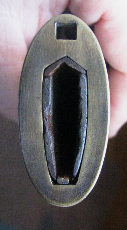

The ha and mune machi do not line up. I know this is often the sign of a Chinese fake which allows the use of a cheap habaki. However, the habaki on this sword is properly constructed with a machigane for the ha-machi to but up against, something not normally seen on a Chinese fake. ( I have tried to photograph it but not too successfully)

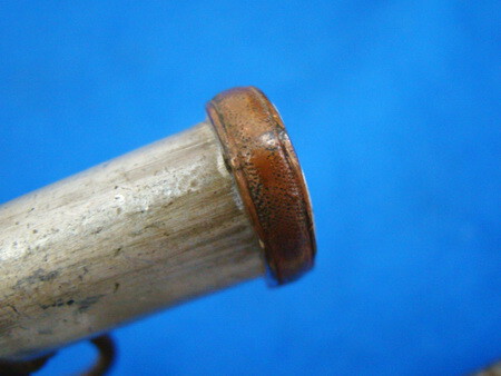

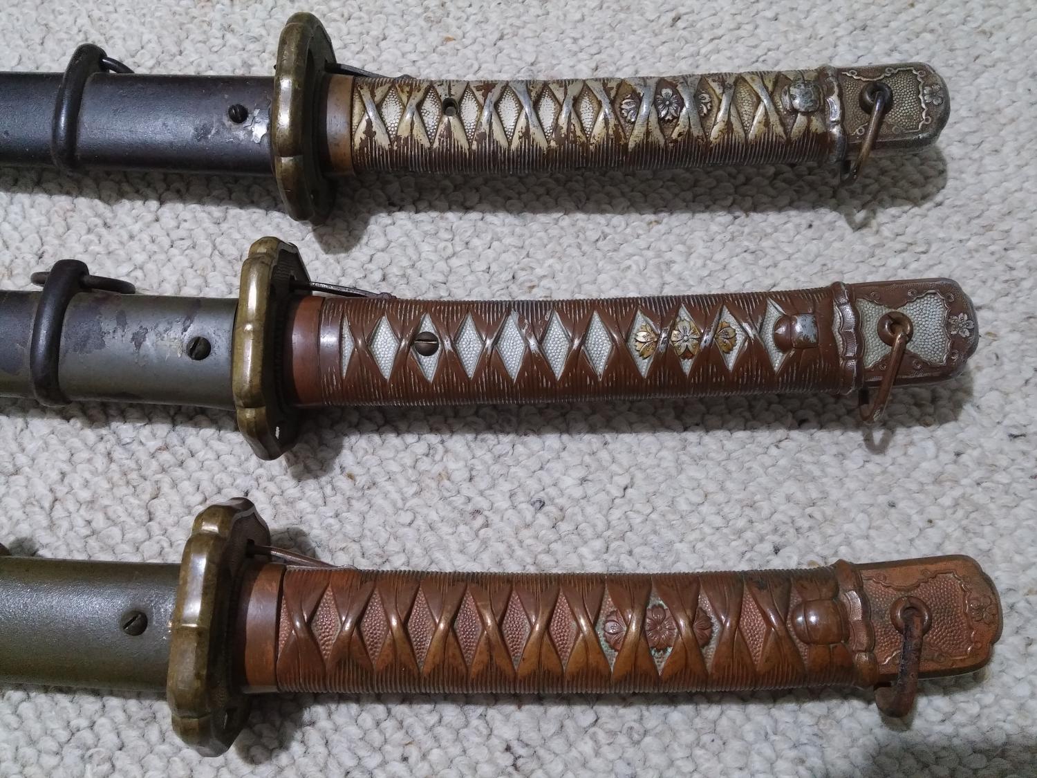

The sword is an early example by Suya. They are the only contractor that produced swords in the 6500-8000 range. These swords are readily apparent by not only their low serial numbers, but by the unique tsuka-ito pattern which is a direct copy of the copper handle series. You with this find that both sides do NOT mirror each ither, but in fact reflect the true pattern of a real ito wrap. The tsuka style was later changed to be a mirror image on either side, with one exception that's off topic.
These swords also exhibit a different screw variety to the later patterns. You will note that one side peirces the middle of a raised band of ito, while the other is centered in a diamond of ito. This was not a consideration on copper handle for obvious reasons, but seems to have been unsatisfactory once the second screw was added within the handle.
The patina is a near perfect match for these swords. Of the three examples I have studied in hand, they all seem to be in similar state.
You may also find that the tsuba is thicker, in line with the copper handles. Presumably width was reduced shortly after the change to aluminum to save on both materials and weight.
Sorry folks, but any assertion this is fake, repro or modern is simply, unequivocally wrong. I'm talking about the sword only... But I'd suggest the saya is genuine too.
You can observe what I have described in the attached photos.

Well you didn't ask, but here's a few points:
1. The fuller groove is accurate, even down to the proper shape at the kisaki, which fakes (to my knowledge) haven't gotten right yet.
2. The Tokyo inspector stamp on the blade is completely accurate, which is so far beyond the fakers to get right.
3. The nakago is completely accurate, well made, with proper patina. The fakers have yet to successfully reproduce a beautiful nakago like this.
4. The barrel screws are perfect.
5. The base of the ito design is perfect.
6. The precision of the ito wrapping is perfect, not the "sand-blasted" look the fakers produce.
7. The serial numbers are legit.
8. The seppa and tsuba are completely accurate.
And I'm nowhere near the expert on 95's that Steve is. There is NOTHING about the gunto that looks fake.

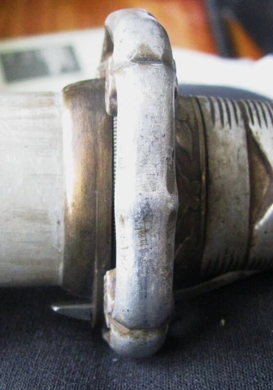

Just to point out that the Kuchi-gane is not painted at all. False colour  given by my trying to make the pictures as clear as possible I think.   Apologies if that has been misleading people. It is unpainted patinated brass with a lot of dirt in the crevices. I agree the screws do look bright although steel not aluminium.
