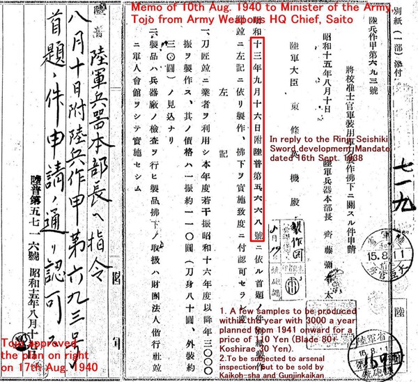

Bruce Pennington Posted August 2, 2020 Report Posted August 2, 2020 Updates on the topic from Nick at: http://www.warrelics.eu/forum/Japanese-militaria/legally-rebutting-existence-type-3-army-officers-sword-708745/ New info: - Tojo tried to get the model launched in 1941 with a press release and ordered 3,000 per year made. - Appearantly didn't happen, speculating lack of demand due to appearance - 1943, due to shortages of copper/brass, army pushed the Contingency model and production expanded. 2 Quote
Shamsy Posted August 2, 2020 Report Posted August 2, 2020 That explains why the assumption was made that the Rinji Seshiki production was not started until 44. Good to hear Nick is still working away on information for sword collectors 2 Quote

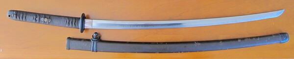

Bruce Pennington Posted August 12, 2020 Report Posted August 12, 2020 Adding one for George Trotter, who is still having trouble with the new site software - an April 1942, by Masakazu. Dec '41 is still our earliest, but this one is up there with the earliest. 1 Quote
george trotter Posted August 14, 2020 Report Posted August 14, 2020 I'm back! Thanks to Bruce and Brian...finally got me trained in the new way of doing things...I wish! Anyway, about this Tsukamoto Masakazu blade made 4/17 (April 1942) in Rinji mounts. Pretty early for Rinji as Bruce says, but starting to appear in late 1941? Masakazu 1901-1969 of Fukushima studied under his younger brother Tsukamoto Ikkansai Okimasa in Tokyo and returned to Fukushima in late 1941 to set up his own forge. He became RJT smith from late 1942, but this one is one of his pre-RJT private order blades (no star) and is very long at 69.5 cm. As Bruce has been trying to unravel, this blade is marked 1129 on the tang and 'ni' 1129 on all metal parts, even the button catch and the back of the habaki...we are not certain yet, but as this is not a RJT blade this cannot be an RJT number...mounting shop number? Here are a couple more pics. Regards, 3 Quote

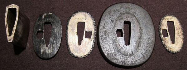

george trotter Posted August 29, 2020 Report Posted August 29, 2020 On the subject of this private order Tsukamoto Masakazu blade above. I have a couple of questions members might be able to help with...Just to add to the Rinji Seishiki knowledge base. Have a look at pics. 1. the blade is 69.5 cm.(27 3/8 in)...have other menbers seen this length blade in Rinji mounts ? 2. notice that the menuki are gilt/brass pattern instead of the usual 'Rinji pattern' black iron menuki...have members seen these as well?...maybe just a private order "customer choice" thing? Be interested to know just how "varied" the Rinji sytem was. Regards, (Edit) well there you go...I should have looked at post #55 on this thread and I would have seen the gilt/brass menuki on a Rinji...duuhh! Well, still interested in how common they are and answers on long blades. 2 Quote

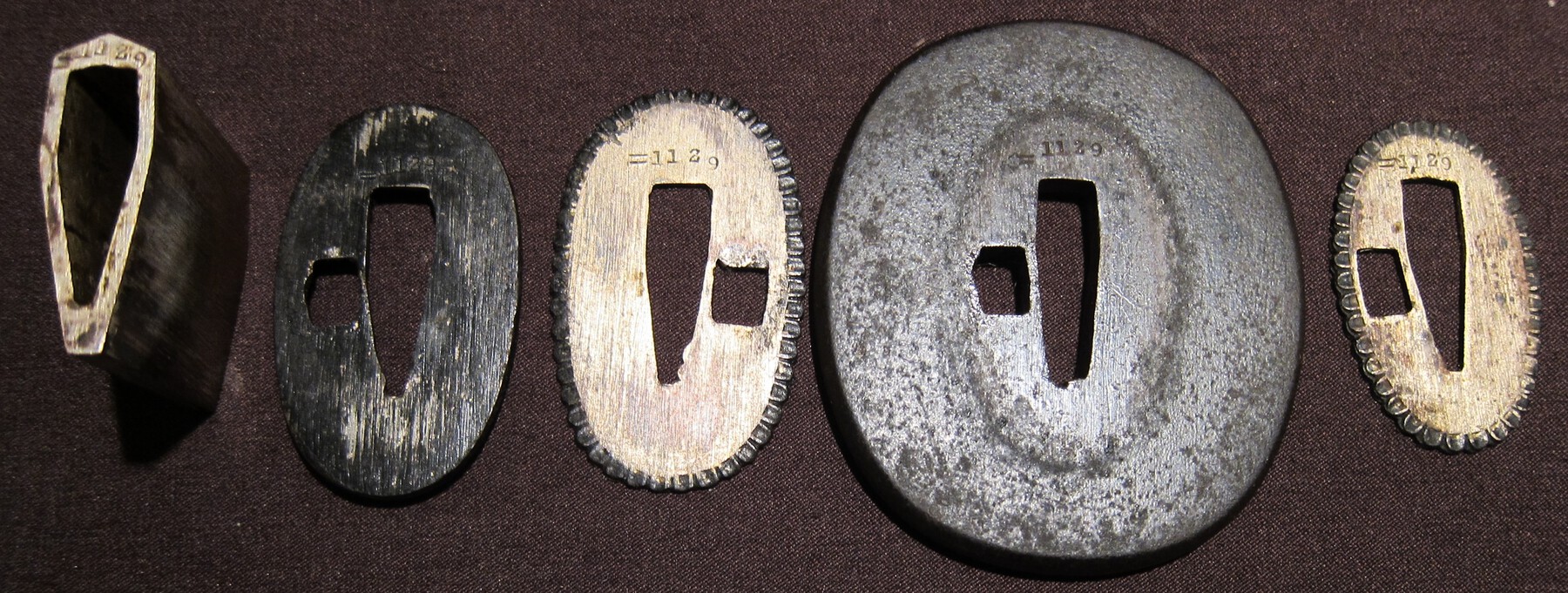

Bruce Pennington Posted August 29, 2020 Report Posted August 29, 2020 Yours is an inch longer than mine, George (don't go there! Ha!) Your question did prompt me to re-look at my star-stamped Kunitoshi. There are no stamped numbers, just painted ones (that oddly don't match the seppa numbers - 3377 painted, 945 seppa) so, my idea that the stamped numbers had something to do with the RJT is probably wrong. They are likely stamped fitting shop numbers. 1 1 Quote

IJASWORDS Posted August 31, 2020 Report Posted August 31, 2020 Please don't forget that there were a few undocumented models, similar to the RS that showed up from 1944 onward. In most respects quite unique, for example.... 1. Although the Kabutogane looks the same as the RS, the Sarute hole is about half the diameter of the RS model. 2. The handle wrap is the same style as an RS, but ranges from yellow /orange to orange /brown in colour. Some times the menuki is fully covered. 3. The menuki are brass. 4. The Same under the wrap is a painted tape wrapped around the handle. 5. The Fuchi, and Saya throat fittings are pressed brass with no markings. 6. Blades have one Mekugi-Ana. 7. Quite a few have Katsumasa blades. I have 3, and have seen others, whilst they are not pretty, and a bit rough, I have an interest in rare and unusual Gunto. 2 Quote
Bruce Pennington Posted August 31, 2020 Report Posted August 31, 2020 2 hours ago, IJASWORDS said: 3. The menuki are brass. Neil, The model has all the appearance one would expect of a "late-war", "just so it stabs...", design - yet the brass menugi rather than steel. Wonder why, considering the original intent was to avoid brass? Seems almost out of place! Oh, and you BETTER be working on a book! Quote

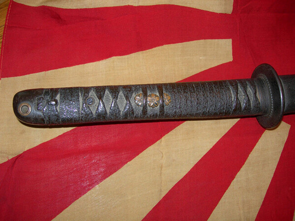

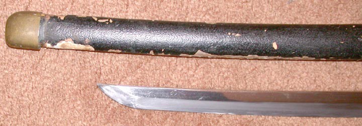

Bruce Pennington Posted September 24, 2020 Report Posted September 24, 2020 I think this was discussed on another thread that I can't find with my poor searching skills, but there are two late-war tsuka on this page with sarute ana not drilled through. I just found another. This star-stamped Munetoshi is in upgraded lacquered wooden saya, but you can see the sayajiri is low quality and the sarute ana isn't drilled through. 1 Quote

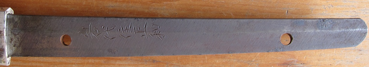

Bruce Pennington Posted July 5, 2024 Report Posted July 5, 2024 An update: David, @Akitombo, has this October 1940 Amahide in RS fittings: Quote

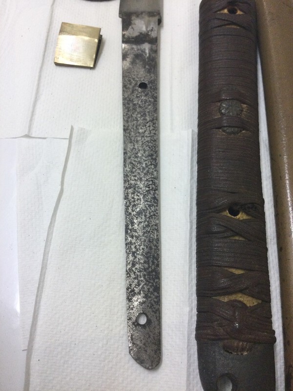

Bruce Pennington Posted July 6, 2024 Report Posted July 6, 2024 Update on that The blade has 2 ana, but mounted in Type 94/98 fittings. I've looked at a few RS blades to compare, and I'm not sure the spacing of the ana on this one are what we normally see. The blade is also fullered, not a normal feature on RS blades. So, unless someone has other thoughts on it, I'm not so sure we've found and earlier RS than Dec '41. Quote
Bruce Pennington Posted October 26, 2024 Report Posted October 26, 2024 I was reading a page on Doug Austin's, @Austo1, site Gunto Art Swords. He was discussing a custom Type 3/RS with a blade that had no star stamp. It had the double release buttons and 2 steel mekugi screws. His observation was that the blade was likely gendaito as Type 3's with steel screws will contain gendaito blades. I have seen that to be true for fittings with the double chuso buttons, but never noticed the point about the steel screws. I've done a brief survey and found the point to be true. I have loads of RJT, star-stamped blades for the survey, but could use some more standard Type 3s with showato for the data. So, if you have a standard Type 3 with a showato blade, please post for the survey. So far, I have 30 gendaito in the chart and all have steel screws, except 5 with only bamboo pegs. I have 13 standard with showato and all have bamboo pegs, except 3 with screws. In both cases, there is no way to know if the exceptions were original or post-war replacements, as many of our gunto show up missing mekugi altogether. But the overall picture is backing up the idea. Steel or Bamboo Mekugi – Rinji Seishiki Model GENDAITO Source Steel or Bamboo 1 or 2 Chuso Saya Type Standard or Custom Stamps date mei Steel, 1/? 2 Custom Star Dec 1941 Akihisa Windy, NMB Steel, 2 2 Custom Star May 1943 Chikafusa Vajo, NMB Steel, 2 2 Custom None Aug 1943 Kunitada Gunto Art Swords Steel, 1 2 Standard Star Feb 1945 Kunitoshi BWP Bamboo 1/? 2 Custom Star Jan 1943 Kaneyoshi NW, NMB Steel, 1/? 2 Custom Matsu on old blade No Date Kaneyoshi 兼賀 Apollox, NMB Steel & Bamboo 2 Standard Star Mar 1944 Kazunori Showa22, ebay Bamboo 1/? 2 Custom Star Mar 1943 Kiyokatsu Daniel, NMB Steel, 1/? 2 Custom Star Oct 1944 Masaharu ? Bamboo, 1/? 2 Custom Star Jun 1944 Masakuni Volker72, NMB Steel, 1/? 2 Custom Star Aug 1944 Masamichi Poulin Auction Steel, 2 2 Custom Star Sep 1943 Masanaga Bangbangsan Steel & Bamboo 2 Custom Star Mar 1944 Masanaga Bangbangsan Bamboo, 2 2 RS/T98 mix Star 1943 Mitsuhiro Panzerfaust44, Gunboards ?/Bamboo 2 Custom Star May 1943 Nagatoshi Warpathmilitaria Steel, 1/? 2 Custom Star Jul 1943 Munetoshi Pippo, NMB Steel, 1/? ? Custom Star Dec 1944 Nobutake Bangbangsan Steel, 1/? 2 Custom Star Jun 1943 Nobutake Ammad, NMB Steel, 1/? ? Custom Star Jun 1943 Sadakatsu Warpath collectables Steel, 1/? 1 Custom Star Feb 1944 Sadaroku Showa22, ebay Steel, 1/? ? Custom Star Oct 1944 Sadashige Japanesesword.com Steel, 1/? ? ? Star Aug 1943 Shigefusa Cox/ima-usa Steel, 2 2 Custom Star Spring 1943 Sukenobu Hi-revr, NMB Steel, 2 2 Custom Star Feb 1944 Sukenobu Cox/Worthpoint Steel, 1 ? Standard Star Sep 1944 Sukenobu Cox/Worthpoint Steel, 1 2 Custom Star Jul 1944 Tomonari IJASWORDS, NMB Steel, 1 2 Custom Star Mar 1943 Tsuguhiro Adrian S, NMB Steel, 2 2 Custom Star Feb 1943 Tsugunobu Bangbangsan Steel, 2 2 Custom Star 1943 Zuiho Butch, NMB Bamboo 1 Custom Star Aug 1943 Zuiho ebay SHOWATO Steel, 1/? 1 Standard Unknown Numblock, NMB Steel, 1/? 1 Standard Gifu/Seki Feb 1945 Kanemune Lennon, NMB Bamboo, 2 1 Standard Gifu Nov 1944 Kanemune Erwin, NMB Bamboo, 1/? 1 Standard Na Jan 1944 Kanenori Dabedo, NMB Steel, 1/? 1 Standard Gifu 1945 Katsumasa Den70, NMB Bamboo, 1/? 1 Standard Gifu May 1944 Masanori Swordamateurnagoya Bamboo, 2 1 Standard Gifu/Seki/Na Mar 1944 Yoshichika RussellM, NMB Bamboo, 1/? 1 Standard Mar 1945 Yoshichika Sechan, NMB Bamboo, 1/? 1 Standard Mumei, No Date DTM72, NMB Bamboo 1 Standard Unknown Bruno, NMB Bamboo 1 Standard Unknown Bruno, NMB Bamboo, 2 1 Standard Unknown Montrealfan1986 Bamboo 1 Standard ? Apr 1945 Sukekuni BWP 1 Quote

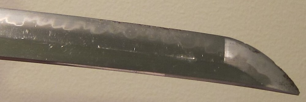

John C Posted October 26, 2024 Report Posted October 26, 2024 17 hours ago, Bruce Pennington said: So, if you have a standard Type 3 with a showato blade, please post for the survey. I think I have one for your data set. Jan 1945 Katsumasa with small seki stamp. It came with one bamboo mekugi near the kojiri, however the mekugi-ana near the tsuba end does not go all the way through and may have been a screw originally. Only one chuso release. John C. 1 Quote
