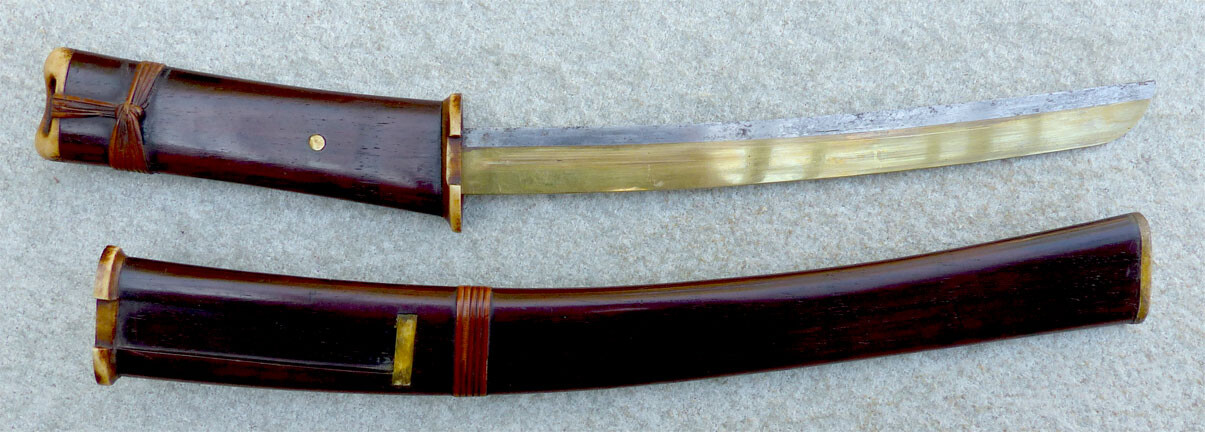

Here is my Kubikiri Tanto or Nata. My guess is that it is a bonsai pruner. Considering how valuable and prized many bonsai were and are a wealthy person would spare no expense on a special pruning tool.
This example does look utilitarian Dick.  I wonder whether cutting bonsai might be better done with small serrations on the blades?  Thanks for the addition to the Kubikiri collection.
