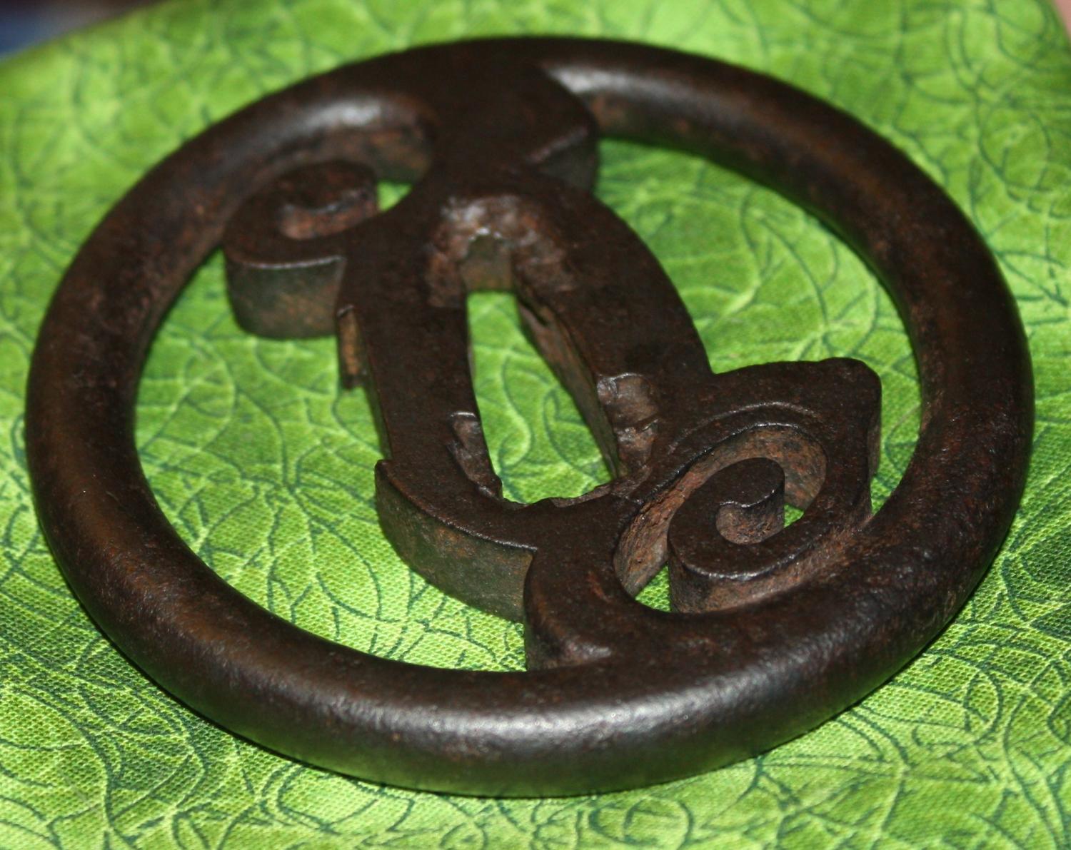

johnnyi Posted October 13, 2017 Report Posted October 13, 2017 Hello, I would also like to understand this school a little better and see some early examples. Elliott Long has done some excellent research which can be found on the Shibui Sword site. Briefly, he states that most of the early work you see is the product of Kazariya Katsukage (Sado Sanzaemon Katsukage) who worked on Sado Island 1675-1750. Mr. Long goes on to write that most of these tsuba were in the open work style "of Owari, Akasaka, and Kyo-Sukashi". They were bolder and thicker however. (the pictured tsuba (ex Haynes, Long) measures 8.1 mm thick.) In the 19th century two descendants of Sanzaemon worked on Sado Island mostly in the flat plate style. These two were the first and second Toshisada who we are probably most familiar with due to many of their tsuba being signed. (They also did Mokume). After the Toshidas Mr. Long writes that the style of the school was mostly a more ordinary flat plate. Here is an example of an early work by Sado Sanzaemon Katsukage. As he was exiled to the Island of Sado it is tempting to imagine the freedom of the waves being restricted by a ring of solid iron as an inspiration for this work Kind regards, JohnI Quote

johnnyi Posted October 14, 2017 Report Posted October 14, 2017 Thanks Curran, Torigoye is a good book and I have it and have read it, as well as Vol. 1 of the "Classroom", but I wasn't aware that Grev's museum book was available yet. I will order it., Anyway, to the point of my post, it was in relation to Grev's question on whether his two tsuba were Sado Island School. I don't know, and can only restate what Mr. Torigoye has said, and provide another example to view of mid-Edo work. In other words, regarding my previous post please consider it a "bump" Regards, John Quote

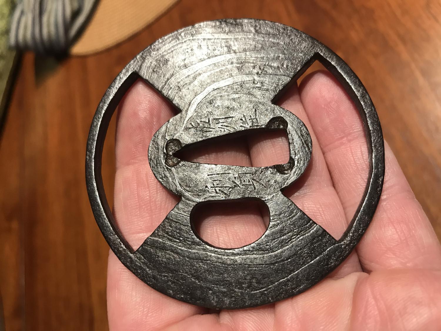

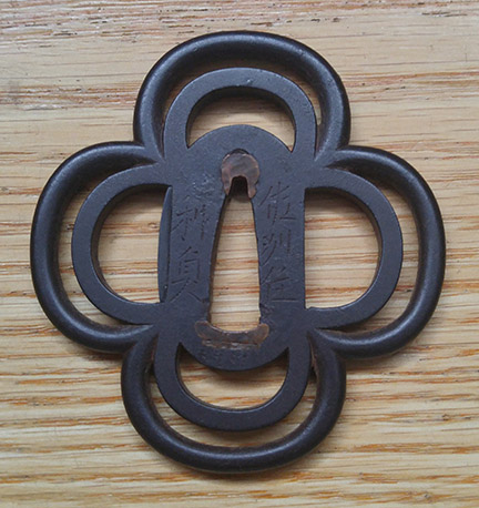

b.hennick Posted October 14, 2017 Report Posted October 14, 2017 Here are two more Sado Island tsuba that I can add: 3 Quote
Curran Posted October 14, 2017 Report Posted October 14, 2017 Thanks Barry. That top mokko gata signed one really nails what I think of as Sado. Quote
johnnyi Posted October 14, 2017 Report Posted October 14, 2017 What is written on the left? Johni Quote
kissakai Posted October 14, 2017 Author Report Posted October 14, 2017 Thanks Curran for your kinds words re my book I agrre about Barry's mokko tsuba and I also think Johns earlier image shouts Sado Well building up a few more good images and I'll look out Torigoye book Quote
Geraint Posted October 14, 2017 Report Posted October 14, 2017 Dear John. Are you referring to the top tsuba that Barry posted? In which case; right hand side, "Sashu no ju" and left hand side, "Toshisada" I believe. All the best. Quote
johnnyi Posted October 15, 2017 Report Posted October 15, 2017 Hi Geraint, Yikes, I glanced too fast, thanks. Great to know "Toshisada" is on Barry's tsuba on the left side, so I guess that tsuba was made by the pupil in the style of his teacher Sanzaemon? regards, John Quote
