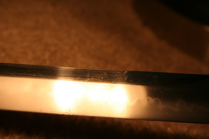

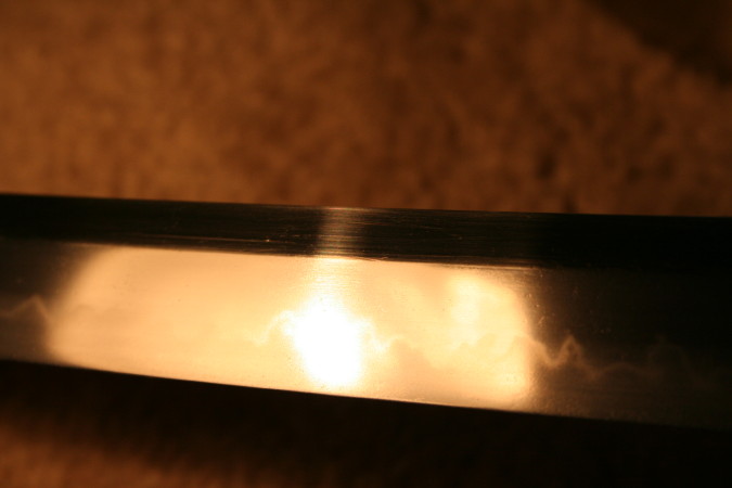

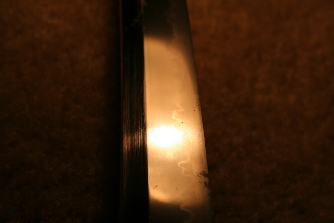

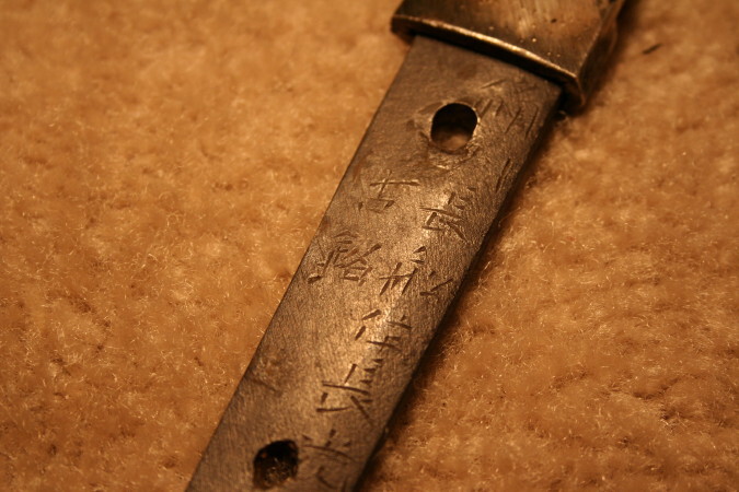

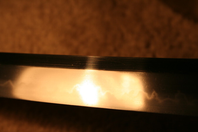

Leatherdog Posted April 4, 2008 Report Posted April 4, 2008 Hello all, Picked this sword up fairly recently and am curious to find out what everyone thinks... Translated the "signature" as Bishu Osafune Nagamitsu...don't know about the other two kanji off to the side. Its in good condition, but has a few spots of staining and a little loose grain. I'm interested in opinions regarding the inscription; it seems to have been added after shortening - which would seem to rule out an attempt to outright fake, as I would expect a maker of gimei would have taken the trouble to place the signature in a more convincing position ...could this be an attribution, perhaps to one of the later smiths who used this signature? Nagasa: 25.5" Total: 32.25" Sori: 2.1cm Motokasane: 6mm Sakikasane: 5mm Motohaba: 2.7cm Sakihaba: 1.8cm Kissaki: 3.7cm Quote
Darcy Posted April 4, 2008 Report Posted April 4, 2008 Think it is: 備州長船ä½é•·å…‰ Bishu Osafune Ju Nagamitsu å¤éŠ˜ Komei (old signature) Might be referring to a shortening. Think we talked about this one before but I didn't read those other two characters. The hamon is very nice and consistent with old Bizen work. Should be sent for papers. Quote
Darcy Posted April 5, 2008 Report Posted April 5, 2008 The hamon looks like old Bizen work but looks more like Ichimonji style than Nagamitsu style. Nagamitsu is usually more quiet and Ichimonji more flamboyant (note usually, there is no hard and fast here). The skill of the chiseling is poor so it is enough to give it doubts about how legitimate the story is that is being told. This is the flipside of the Kanenori that we were discussing on the board, because it's attesting to a Nagamitsu one has to take it with a several hundred kilo grain of salt. However, the work is consistent with old Bizen style. However, it could be a shinshinto copy, as the shinshinto smiths were able to make very nice choji among those who took up Bizen style with vigor. I would safely rule out any Bizen between Nambokucho and the end of Shinto looking at the hamon. If the jihada is kind of weak, that is kind of standard for middle period Kamakura Bizen. These smiths were hamon men, they did not make the beautiful jihada that you see in Yamashiro or in Soshu (which is inherited through Yamashiro). So I think that you can have hope that this is an old Bizen blade. It is possible that it could be ubu or nearly so and was a mumei kodachi that was later on dummied up to pretend to be an o-suriage tachi. On the other hand, could be shinshinto, a kodachi that was then dummied up to look like an old blade. I think that you might be shooting with a bulb that is either behind a lamp shade or is a frosted bulb... if so use a clear bulb. Take these photos again, and show some pictures where the filament of the bulb is reflecting right into the camera. This will light up the nioi crystals and then give an impression of the detail and structure of the hamon. A shinshinto hamon I think will tend to be very "clean" where the older Kamakura hamon is going to have beautiful and natural detail inside it. I think that because of what is shown the sword really needs to be sent in for papers, to have a proper expert evaluate it and make a decision on what we're looking at. I'm about 80% certain that the "old mei, nagamitsu" stuff is BS, but it does not mean that the sword is not old Bizen. If you have an Ichimonji kodachi it's every bit as good as a Nagamitsu. Collectors would give a left arm for either one. Which also means that the whole thing has to remain suspect until it can be handled in person by someone who can make a proper judgment. My only concern looking at the pictures is that the structure of the hamon is very regular. Ichimonji brings the feeling of wildness, like you are looking at a fire burning out of control. This does not give that feeling. It's got more of a regular gunome mixed into the choji and so it then gives the feeling instead of a smith who is working within his natural form of expression, the feeling of an artist trying to match a template. So that would have me lean to a shinshinto work dummied up but I don't get that feeling enough to rule out that you have a nice old koto Bizen work. I'd lean to Ichimonji still over Nagamitsu if I were told certainly it is Kamakura Bizen, because the range is very broad. Included below is a middle period, likely Fukuoka, Ichimonji master work. This is a little bit more regular and sedate than the true grand flamboyant pieces, but you can still see the wildness and natural nature of the hamon. It is very organic, the structure it has feels like the structure of fire or anything that grows and is natural. When someone tries to replicate this centuries later, they have no idea what the smith actually did to pull this off, so work off of theories and attempts to duplicate it, and usually then a forced feeling comes through in the work. It's probably not until Ka that people really pulled off the same feeling, I am really enamored of Shibata Ka's work, the two that I have seen very much impressed me. Quote

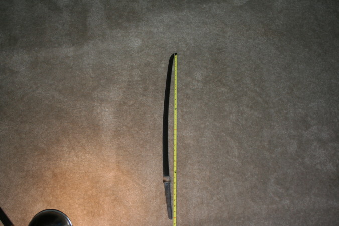

Leatherdog Posted April 5, 2008 Author Report Posted April 5, 2008 Thanks for the info...I'll try to take more photos this afternoon. As a point of interest, not that it helps us with the origin of the blade itself, this piece was captured by a Marine flamethrower operator during the battle for Iwo Jima. He passed away in 1971, and the sword was rediscovered by his daughter when cleaning out the house recently (I assume after the widow passed away, but she didn't say). She said it was her father's prized possession...but she sold it to me. (Not that I'm complaining too much). It's nicely mounted, but the tsuba is long gone, unfortunately. Quote
John A Stuart Posted April 5, 2008 Report Posted April 5, 2008 Hi, I've just finished looking at about 40 Ichimonji recently and I have the Bizen Ichimonji book open in front of me. The hamon matches o-busa choji with maybe a little togari-gunome thrown in, which is ok for Ichimonji. What is the hada? Look for itame, mokume or masame. Quite a few that are ubu or suriage start with suguba before evolving, not a rule. Most boshi are suguba, gentle notare or hakikake, though some continue with a choji pattern, but more suguba than others. In all the swords I've seen and that are illustrated in this book there are no examples of this type of nakago. It seems crude in comparison. Even the o-suriage swords have had their nakago shaped and bent to maintain conformity. This is what makes me wonder, but this is speculation on my part and as an exercise for me. I would check those points though. Surely a Bizen feeling here. John Quote
Darcy Posted April 5, 2008 Report Posted April 5, 2008 I'm not sure about generalizing the Ichimonji boshi as suguba, the school runs about 150 years and has several major stylistic changes. I shot four for my book, the Ko-Ichimonji has suguba, the other three all are midare boshi. Nakago is always going to be depending on whether it is ubu or not and when the shortening was done and by whom. If this was a kodachi, it's just been shortened a small amount and the nakago would have been filed straight. A friend of mine has a 36" tachi, the only modification is that they filed the nakago straight on that thing too so it could be worn as a katana. No idea how they got the blade out of the saya. Quote

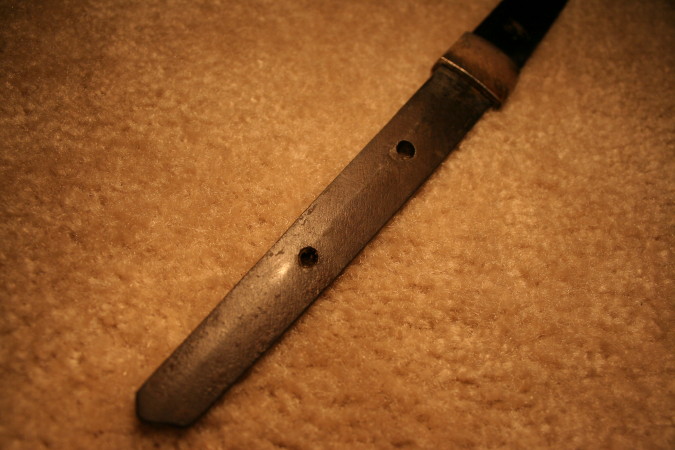

Leatherdog Posted April 5, 2008 Author Report Posted April 5, 2008 Regarding the possibility that this might be a very old blade...should I still be able to see the yasuri? Also, the nakago is a "chocolate" color - not blackish...looks older than shinshinto, but shouldn't it be very dark if koto? I've not got enough experience handling old blades to feel confident making a call on my own. If the blade is slightly suriage, would the entire nakago have been refinished, and the patina and yasuri date from the shortening, or should the larger part of the nakago have original rust/filing? Quote

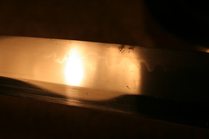

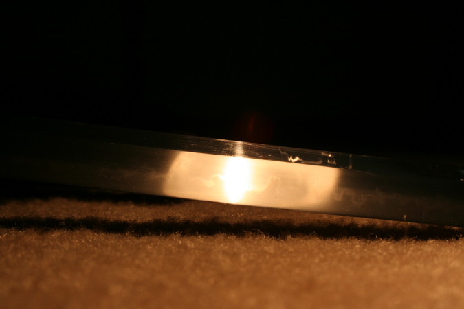

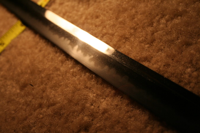

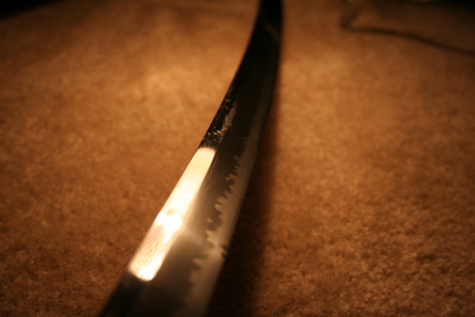

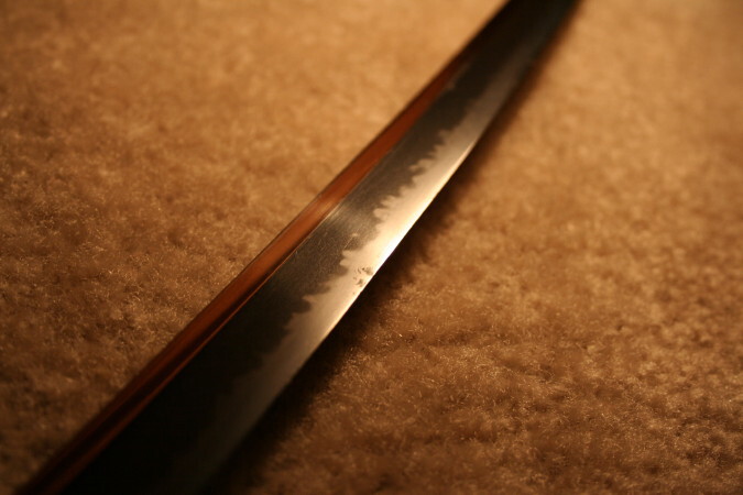

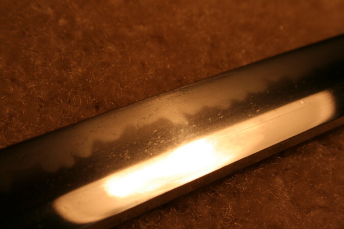

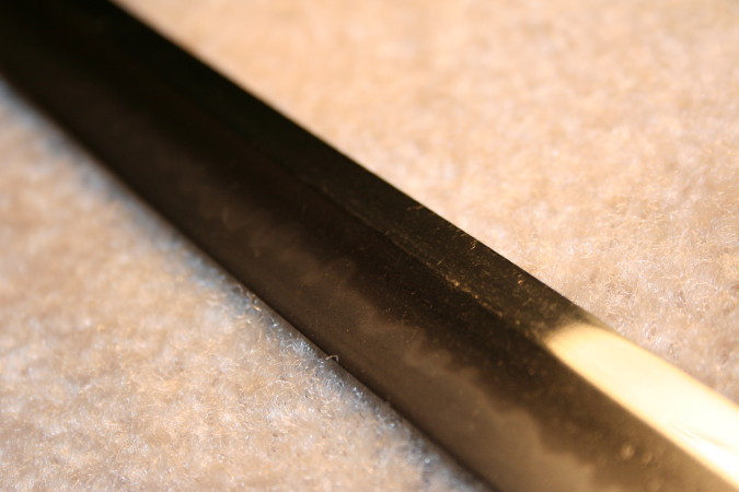

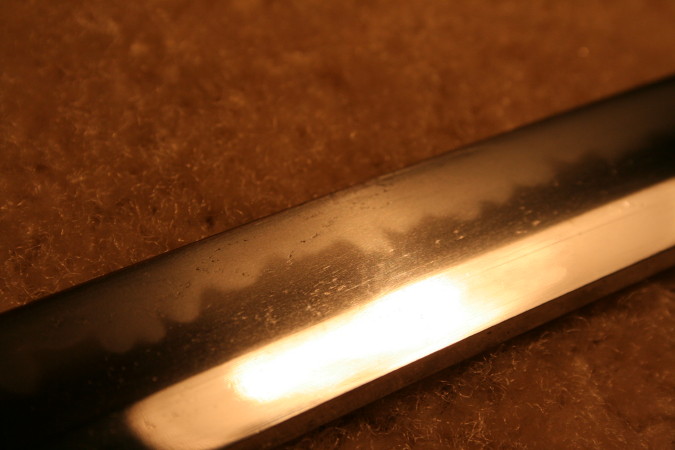

Leatherdog Posted April 6, 2008 Author Report Posted April 6, 2008 I re-shot some pics of the hamon. Hope this reveals a little more detail. Quote
Darcy Posted April 6, 2008 Report Posted April 6, 2008 This is more of a style of gunome than of choji I think... also you can see how clean the appearance is, it's lacking the detail and substance of the great older Bizen works. I'm attaching a great Ichimonji from my book and you can see how much is going on in the hamon. So the backup theory on your blade is it might actually be one of the late generation Nagamitsu, into the Muromachi period. Blade was shortened afterwards. http://www.nihonto.ca/Ichimonji.jpg Quote
John A Stuart Posted April 7, 2008 Report Posted April 7, 2008 Hi Darcy, Your right the new pics show it as gunome. No real activity to speak of and being nioi-deki would have some. It would still be nice to see the kissaki and boshi. John Quote

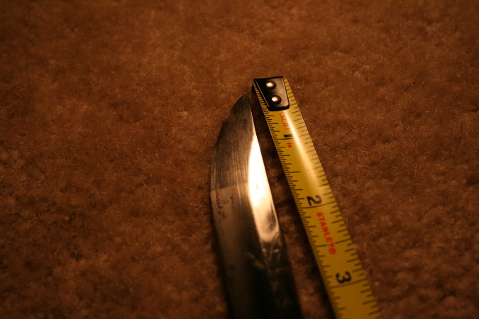

Leatherdog Posted April 7, 2008 Author Report Posted April 7, 2008 Sorry...the boshi is obscured by staining, and isn't visible. Back to the patina on the nakago I mentioned a few posts ago; could it have been refinished completely at the time of shortening, or should I be looking at original patina? Attached is a pic of the kissaki...it kind of looks like boshi in the photo, but I don't think it is - I have trouble seeing it at all with the sword in hand. Likely just an effect of the photo. Quote
John A Stuart Posted April 7, 2008 Report Posted April 7, 2008 OK, The boshi appears in the pic to be a continuation of the same hamon, ko-maru, if the faint outline can be beleived. The mei is in the place you would expect when you look at the upper mekugiana, but if the lower mekugiana is the original and the sword is suriage there would be remnants of a mei there, on the lower one. So this sword seems to be either suriage mumei, machiokuri and gimei or o-suriage machiokuri and gimei. The signature either way is a later addition. So, what does this lead me to think? Muromachi/momoyama gimei kazuuchimono Bizento. Just my poor opinion and waiting for others. John Quote
Guest reinhard Posted April 7, 2008 Report Posted April 7, 2008 I don't intend to do kantei on the basis of photographs, but there are very obvious deviations from old Bizen style swords (Osafune and Ichimonji). - the shinogi-ji is very narrow > ShinShinTo or later - the hada seems to be very tight and crisp - the nioi-guchi is very tight and constricted (shimari) - no utsuri is visible (this might be due to polish/photographs) - the outline of the hamon lacks the natural and relaxed quality of old Bizen masters This is a good learning piece for approaching any blade and for what one should not do. The first step is supposed to be: NAGAMITSU never signed a tachi on the haki-ura: NEVER. Therefore there's no need for checking mei or nakago. The mei is either false or a later attribution; ergo: forget mei and nakago! If you're still interested, the next step would be: What can it be instead? To find out you have to clear your mind from thoughts of Nagamitsu, old Bizen, KoTo. One has to start at the very beginning of kantei with an open mind. reinhard Quote
