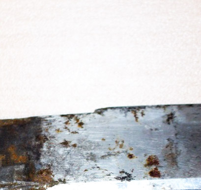

Wow Ray, two more great examples.  Do you own either?  I hope you are wrong about it being shinshinto.  My thinking was that the thinning of the bohi at the machi was indicative of numerous polishes, probably more than a shinshinto blade would have had.  I may or may not have the smarts to figure it out when the sword is in hand but will show it to you at the Minneapolis or Chicago show to get your thoughts.  Here is the machi showing the narrowing of the bohi.  Cheers, Bob

Neither of the examples are mine. I did see that feature in the Fuyuhiro, but felt it was made that way. Note the somewhat crude execution of the horimono (naginata-hi, soe-hi), which I cannot recall seeing on an earlier (Nambokucho or prior) sword. Sorry, don't mean to be a downer and hope I am wrong here...

Thanks Ray.  I admit to having stared at the end of the bohi a long time.  Ultimately, I decided that it was perfectly identical on both sides of the blade and was done with intent.  It also has a curvature different from the curvature of the sweep in the shinogi ji and that was identical on both sides.  After staring at it a long while, I decided that it wasn't so crudely done as I initially thought.  Again, we shall see when it is in hand!  If it turns out to be an utsushimono, I probably won't have it restored unless the hamon and hada really beg for it.  Cheers, Bob

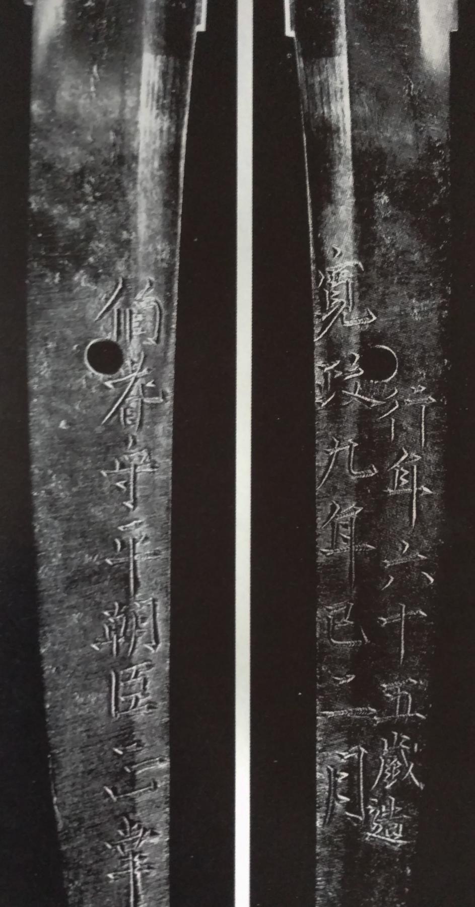

Attached is an o-suriage Masamune. Nakahara seems to argue that these types of swords really are ubu, and not what they purport to be.
