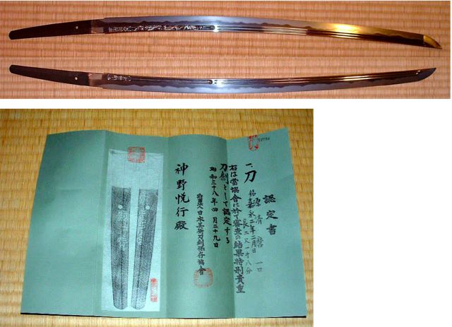

As I said before: It is confusing to compare just any mei you can find of a particular smith. Looking at the exhibition in the Sanoo museum, n.65 was made in Kaei 6th year and n.66 in Kaei 7th year (1854, the year of KIYOMARO's death) and what's more important: it has a "kirite" added to the mei dating from Ansei 3rd year (1856). Moriyama-san or Morita-san might find the time to translate and explain it fully.
The sword in question is dated to Kaei ninen hachi gatsu and can only be compared with the examples of that time.
Darcy pointed out: "...this mei has been laid out with an intention..."
This is also what I think and why this is a good exercise. Comparing the three mei from the same year and month, you will notice, that the "obvious" deviation between the two genuine examples (top part of the "Maro" kanji) still includes a personal handwriting, while the mei in question was obviously done by somebody, who knew the left mei and tried to copy it as closely as he could without fully succeeding.
reinhard
Reinhard,
I see now ! That is what I needed to know.
Darcy, said to submit it for papers anyway. If he says to do so, guess that is what I need to do.
Thank you ,
Lee
Just to be clear I'm saying submit because in the case of a big name I think that it has to be exhausted beyond a shadow of a doubt as a rule. That is, in a time when the community is wrong, the potential impact of that incorrect "gimei" reading is really big. Removal of a mei or a sword being mistreated, etc.
So it has to be done I think just to rule out any possibility of error.
I don't have any doubt in my own opinion, I think the sword is gimei, but if I had the blade I would still submit it just in case. My other blade I had finally been convinced it was gimei and in the end it wasn't.
This particular community is also much better as nihonto students than it was 5 years ago.
Kind of replying in reverse order but...
On all of the good examples the mei is showing what is a very good sense of geometric proportion. The characters are just laid out with respect to each other and the shinogi and the boundaries of the nakago in a way that is very clean and in harmony with each other.
He may change the actual position with respect to the shinogi depending on the blade, I have not studied this smith much, but what does not change is that he has a very keen sense of space and layout. It's the same kind of thing as the eye of a master photographer who is framing a picture of a model, or of a master furniture maker deciding how high, how wide and how long a particular table is going to be. Some smiths follow layout in regards to shinogi as a straight rule, it's a matter of studying the smith to find his habits.
Whenever a faker is faking something he is trying to emulate something that the actual artist feels innately, or else creates by means of some formula of body position, hand position, his favorite tools, the way sensei told him to make his tagane, his bench height, whatever it is... the faker instead has the final product to look at and doesn't know each of the variables in the formula. He is working backwards, reverse engineering and as well is trying to do this for profit and is not going to spend weeks trying to get the mei just right. Or else, he might as well just make and sell his own swords.
What his goal is, is to make it passably good because he knows already he won't match it, or to match it would take insane amounts of time... he wants it good enough so that someone on seeing it, their heart will skip a beat and their own desire to discover something will take over. He wants it good enough for the weakness in the sword lover or the greed in the businessman to speak louder than good sense. And this is a pretty good plan historically in all fields and markets :-).
So what you always get are these fakes which are "good enough", and invariably there is something wrong, big or small that you can pick up with dispassionate and skeptical study.
In your posts you keep concluding with "who knows?" which shows a hope for the sword to be legitimate... instead with a big name smith, we already know it is fake and then the sword has to prove itself to be legitimate. If the sword swings on three pitches and fails to hit the ball, then we know, and trying to argue the case of the sword as its advocate leads the student down the wrong path. You are supposed to be arguing with the sword, making points and letting the sword argue back. In this case the sword has no answer for the problems, and that's why we conclude it's gimei.
The thing to do I think is to understand that Kiyomaro is faked extensively, that this appears to be a mei that may have been faked from an oshigata of the sword that Reinhard found (how he continues to dig up just the right thing is beyond me :-), and that this sword has failed on multiple key and important issues of kantei. So we should know.
Then what we have to do after making a conclusion to the best of our abilities, is to continue to remain humble and make sure that all possible bases are covered in case we're wrong. So the blade shouldn't be submitted in a "who knows" sense, but it should be submitted in a "I believe I understand the situation, but in case that my knowledge is not as good as I think it is, then I must make sure that I've considered the case where I am wrong."

Lee, Carlo was not correcting you. I think he was being very helpful, and pointing out how valid Darcy's points were. You seemed to be querying some of the observations, and I think he was being most polite about it. None of us knows who knows who else, and indicating someone's experience is helpful to anyone reading who isn't a regular here. The catalog pics he posted are very helpful, especially with regard to the yasuri..which are the diagonal filemarks.
The input from everyone on this thread has been amazing, and about as much as you could ever hope for online imho. Thanks to everyone who posted :)

lee
its a gimei by a good smith well worth getting restored
why not get the kissaki done in the us first ? in the uk it would not cost that much

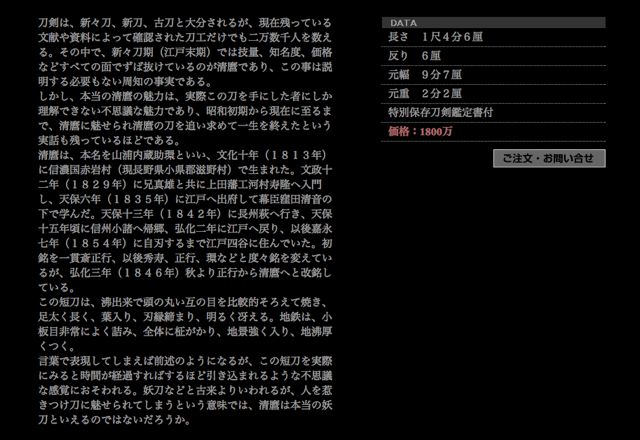

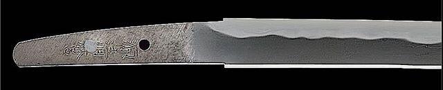

Wakizashi Kiyomaro, 44.2 cm
1800 man = US$ 220,000.00
