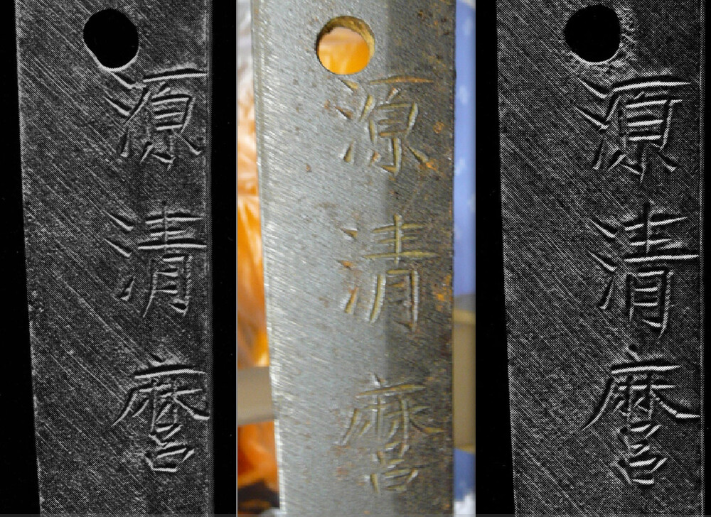

sencho Posted April 11, 2008 Report Posted April 11, 2008 That's good... thanks Reinhard.. To me the comparison suggests strongly gimei... the mei in question does not have the same "handwriting" as the example... (in my novice opinion anyway) The third kanji of the mei is particularly "loose" and untidy.. Cheers Quote
Guest Lee Posted April 11, 2008 Report Posted April 11, 2008 Hello, I do not think Reinhard said it was a Gemei, I think he is saying that using just one Mei with a smith signature is not good because they mature over the years . Not all the smith signatures over the years are exactly the same. You must look at many examples . They both look the same to me ! Did I read it wrong ? Reinhard , is this what you are saying ? Is the sword in question Shoshin or Gemei ? Thanks! Quote
sencho Posted April 11, 2008 Report Posted April 11, 2008 Hi Lee, I think Reinhard is letting us educate ourselves, by not saying anything and letting us come to our own conclusions. He did not say it was gimei or shoshin.. Reinhard (if I am correct) is showing us a comparison from the same date as your sword. He is saying that a comparison with a mei from a sword, made 10 or 20 years before or after may be not much help, as a smith's signature often evolved over time. The kanji is written as the same kanji on both swords..., ...but just as you and I can write the same words in English, in similar handwriting, the words were still written by different people. Even if I tried to copy your handwriting exactly, I would still miss a few elements of your particular style, and my copy of your handwriting would not be as fluid as your regular writing.... .. same as on a copied mei... some of these guys on the board, can tell immediately with some smiths, they have studied for so long. ... I am still learning and may be proved wrong, but I see inconsistencies between the two mei's. Especially the 3rd kanji is strikingly different... as if a copy was tried but did not quite make it.... Let's see what the others say about it.... Cheers Quote

Brian Posted April 11, 2008 Report Posted April 11, 2008 Lee, If there ever was a reason to send something to shinsa, this is it. None of us here can be 100% sure. You will never get a definite answer on a forum, just guidelines. However if the workmanship is as nice as you say, then it is worth polishing and submitting. It is close, but with every Kiyomaro I would assume gimei until proven otherwise. Send it to Bob Benson...he will tell you if it is worth going further. Unless the entire shinsa panel registers here and gives you a firm answer, get it looked at in hand by someone. Brian Quote

Guest Simon Rowson Posted April 11, 2008 Report Posted April 11, 2008 Actually awfully darn close for me as well now that I can see the signature properly. (For example, I can now see Jacques "pre-terminal" hooks) However, Brian quite rightly said: Quote None of us here can be 100% sure. (I totally agree, but I certainly think that is just as true for the shinsa panel itself - they are just human beings with all the fallability and bias which that fragile state entails. ) Quote
Guest nickn Posted April 11, 2008 Report Posted April 11, 2008 there are too many erros in the mei the strokes are much to chippy and hesitant my guess would be kajihei who copied kiyomaro very closely ,explaining the hamon, over a long period and the bonji well they just are not the quality you would get on a true kiyomaro his sword have always been valuable its inconveivable the someone would have added them to a genuine blade send photos to bob he will tell you if it is shoshin or not Quote

Nobody Posted April 12, 2008 Report Posted April 12, 2008 I noticed the difference in their Yasurime. I think Yasurime of most Kiyomaro were Sujikai (ç‹é•). But the Yasurime of the sword in question is not so steeply slanted. It looks rather like Katte-sagari (勿‰‹ä¸‹ãŒã‚Š) to me. Quote
Guest reinhard Posted April 12, 2008 Report Posted April 12, 2008 In Kaei 2nd year KIYOMARO was still in full power and this can be seen in his mei as well as in his swords dating from that year. Two famous katana from Kaei ninen 8th month are known. I made a "sandwich-pic" with the mei in question in between those two swords. I would like you to have a look at the yasurime-angle and the Kanji for "Minamoto" in particular. I don't say it's genuine or gimei yet, but I lean towards Sencho's opinion. It's about personal handwriting. reinhard Edit: was still working on the pic when Moriyama-san posted his remark about the yasurime. It's his copyright :-) Quote

Jacques Posted April 12, 2008 Report Posted April 12, 2008 Hi, Lee, Can you post a picture of this blade? Sometimes, photographies don't show up all details (it's why good oshigata are often better to compare). Quote

Darcy Posted April 12, 2008 Report Posted April 12, 2008 This is a very good thread. Jacques made an extremely valuable observation. Atari (hooks) are extremely important in recognizing whether a signature is good or not. The smith's typical placement is not in this mei. Reinhard's comparison oshigata shows it very clearly. Furthermore some of the free-standing atari are very weak. The mei has been laid out with an intention to follow Kiyomaro, that's pretty clear. Someone worked from a template. The slam dunk that ends the discussion is Moriyama san's analysis of the yasurime. They are very obviously different, and yasurime come up time and time again as a very conscious habit of the smith. If the yasurime are at a much different angle it is because the smith is orienting the blade and his tools differently, and these are as good a fingerprint as the mei. The sword is gimei. There were very talented forgers, I would be tempted to classify this as a Kajihei as it shows some of his traits... he could lay this kind of thing out from memory, and kind of slammed out his forgeries with a feeling of arrogance that it was good enough to get by and though if he would have applied himself even more carefully he could have replicated it even better. But one almost feels a smirk from this smith as he does it, almost like he is doing a less good job than he could because he knows it is good enough to fool the people he wants to and is almost giving them hints to catch him in the act. Following this there were talented fakes happening in the Showa period as well. A good temperline is not enough to confirm a bad mei. I would consider the blade to be gimei. As usual, the advice with a big name is to double and triplecheck. Submit it for papers anyway. I have had a Nosada that everyone considered gimei based on the workmanship being atypical and then nitpicking the mei, and it passed NBTHK papering without a comment, and after polish was top notch sai-jo saku work. So I hope for the owner that we're all wrong, but starting with Kiyomaro skepticism is required, and the board members have pointed out major inconsistencies from canonical Kiyomaro works. What has not been pointed out yet is the haphazard alignment of the mei characters in regards to the shinogi line. In Reinhard's canonical example they are very tightly and obviously laid out in regards to the shinogi, and in the sample sword the shinogi is a non-factor. Quote

Guest Lee Posted April 12, 2008 Report Posted April 12, 2008 Darcy, The middle picture of my mei is not flat on the table. Picture shows more of a gap than it is. I laid it down and compared it to the book , very very tiny space between the letter and the shiogi ridgeline of the sword. Wish you could hold the sword . The pictures are not showing the sword right. What do you think of no. 65 of Carlo's picture and the tanto Kiyomaro made ? The letters are away from this line. On this sword ,the line down the middle of the mei [raised part] in the book and the sword , is on the money. Who knows! Just a thought ! Lee Quote
Carlo Giuseppe Tacchini Posted April 12, 2008 Report Posted April 12, 2008 Lee, respectfully, check also the Yasuri from my pics. If anybody of the ones that posted in this thread handled enough Kiyomaro's to have a legitimacy in giving an opinion, that's Darcy (I dare to say and with no offense meant to anybody). Quote
