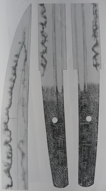

Guest Lee Posted April 9, 2008 Report Posted April 9, 2008 It says Minamoto [No] Kiyomaro , date: Kaei 2 nen8 gatsu jitsu = Late Edo period 1849. Signature looks good in my book. Sano Art Museum Kiyomaro/Kotetsu #58 & #59 in the book. Were you going to by the sword ? Quote
Guest Simon Rowson Posted April 9, 2008 Report Posted April 9, 2008 I agree with Lee. I just looked at the pages he indicated and the signature and date look like a very close match. If you are in the running to buy this (or have already bought it) and the blade isn't missing something vital (like everything beyond the nakago) you may well have made the Nihonto find of the decade. Of course, now I'm waiting for the experts to inform us that Kiyomaro always signed something like "Minamoto Bunty Kiyomaro" in 1849 or that the yasurime are 0.0005 degrees at the wrong angle so, naturally, this has to be gimei. Quote

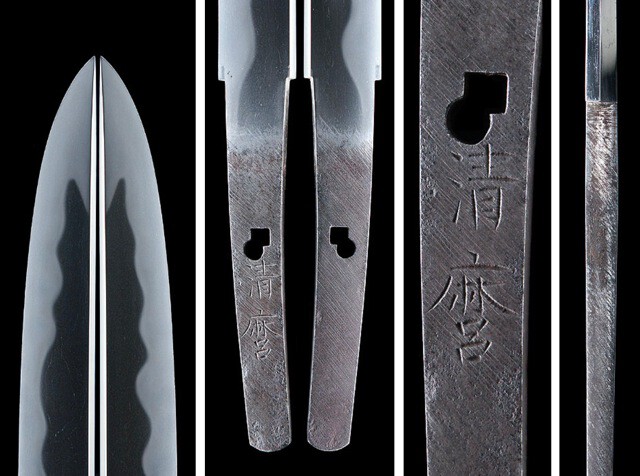

Eric H Posted April 9, 2008 Report Posted April 9, 2008 Tanto Kiyomaro, 28.0 cm, NBTHK Tokubetsu Hozon Eric Quote

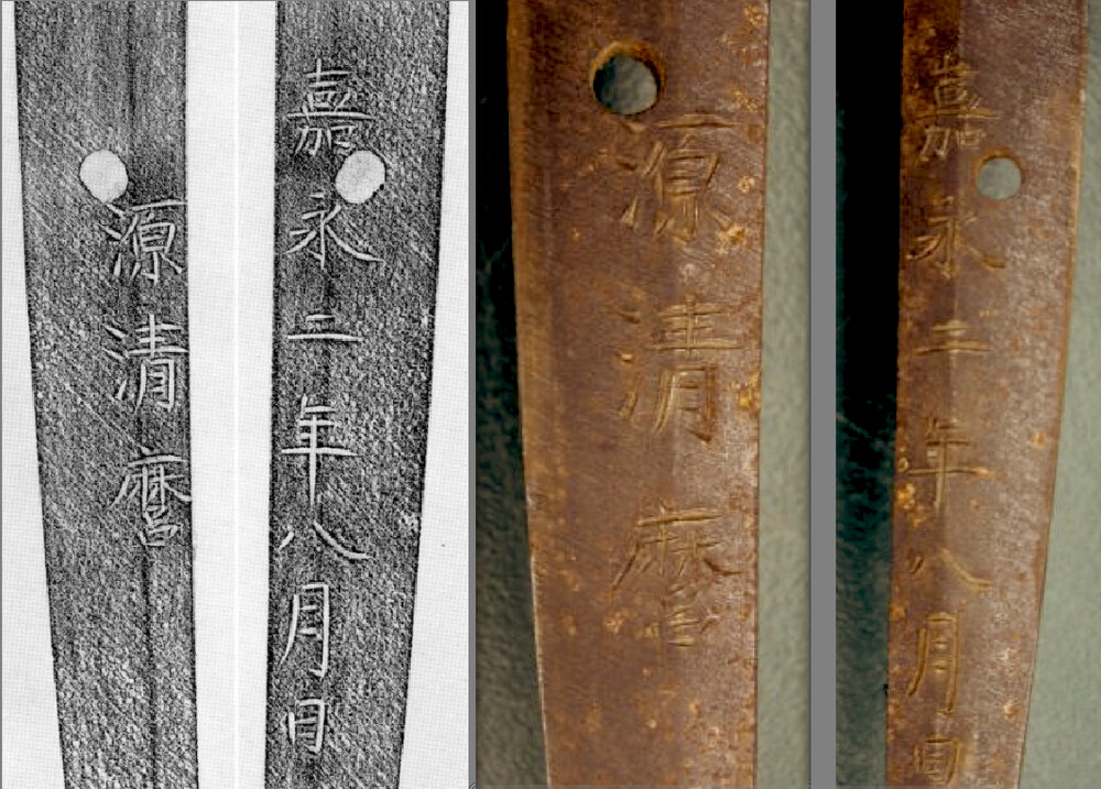

Jacques Posted April 9, 2008 Report Posted April 9, 2008 Hi, Think it is gimei, Kyomaro had some special points in his mei and i don't find them on the blade shown by Slavia. Quote

Guest Lee Posted April 9, 2008 Report Posted April 9, 2008 I am no expert, I was looking at the chisel marks in each letter or I think you say kinji. The position of the letters Location. File marks . Quote

Jacques Posted April 9, 2008 Report Posted April 9, 2008 Hi, Jacques D said:Kyomaro had some special points in his mei and i don't find them on the blade shown by Slavia. Care to elucidate? Look at the picture below. More, the way of engraving on the blade we discuss has a lack of strength and self confidence. Quote

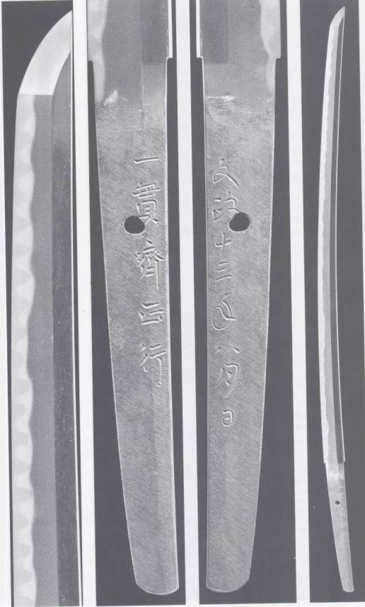

John A Stuart Posted April 9, 2008 Report Posted April 9, 2008 Hi Jacques, Kiyomaro did hook the verticals at the bottom early in his career when signing 'Ikkansai Masayuki'. Other than that I do not know how his Kiyomaro mei matured. Just for clarity. John Quote

Eric H Posted April 9, 2008 Report Posted April 9, 2008 Minamoto-no-Kiyomaro, Wakizashi 48.78 cm Eric Quote
Guest Lee Posted April 9, 2008 Report Posted April 9, 2008 Jacques D. I see what you are saying. There are some of those points in this book that run with the file marks . The temper in the sun light is just the same as #58 in the Sano Book Kiyomaro/Kotetsu. I read Kiyomaro had a stroke and later committed suicide 1854 . Some blades have to reflect this problem he had . This sword is 1849 who knows how long or when he had the stroke. The only way to know is to submit it to the NBTHK. Quote

Ford Hallam Posted April 9, 2008 Report Posted April 9, 2008 This mei seems weak, and uncertain, to me. Kiyomaro was neither, with regard to his swords. Personally, however, he had some problems.... lack of belief in his own work wasn't one of them. Quote
Jacques Posted April 9, 2008 Report Posted April 9, 2008 Hi, Lee, This sword is 1849 who knows how long or when he had the stroke. The blade on the last photo where is written the comment about the hooks, is from Kaei roku (1852). Quote
Guest Lee Posted April 9, 2008 Report Posted April 9, 2008 I guess Sano Art Museum needs to know about the three fake blades in the book . Anyone have the number I will call them. Just a joke there ! Seriously ! There are blades by him that do not follow those points. Sword in hand ,you would see that its more than the signature that defines the smiths work. Its how its made too. I agree that the horimono [ dragon claws ? ] on the side looks weak. No one knows by who or when it was put on the sword. Have a good one ! Quote

Guest reinhard Posted April 11, 2008 Report Posted April 11, 2008 This sword is a good exercise. The pics of the blade are not much of a help and the nakago is the most reliable source of information. I would like to show you an oshigata of a Kiyomaro-mei from the same year and month like the sword in question. On the left the oshigata, on the right the sword in question (I tried to enhance the quality of the pics without substantially changing them). BTW It doesn't make much sense to post just any mei connected to a particular ToKo, for many of them slightly altered their signatures during their career. reinhard Quote
