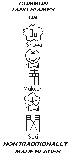

vajo Posted September 25, 2017 Report Posted September 25, 2017 http://www.militaria.co.za/nmb/uploads/monthly_09_2017/post-4223-0-52364900-1506298641.jpgFetching info... on the picture i see a seki stamp. Maybe they stamped it false with star stamp und remove it. I guess it is a simple Showa-to Quote

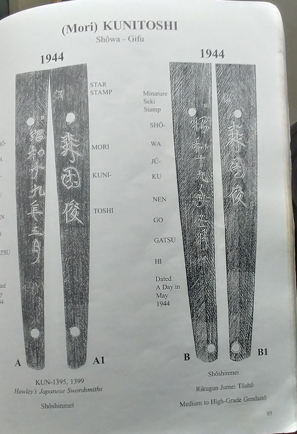

Bencld Posted September 26, 2017 Report Posted September 26, 2017 It says in Sloughs book medium to high grade gendai. Doesn't say anything about showato. Sloughs book usually says if they made showato as well. Noting that Sloughs book is not "THE" diffinitive on these war time blades. I owned one by this smith for a while and I believe it to be genuine hand made non showato gendai blade. It did not have a star stamp or any other stamp on it and was not dated. The signature was identical to this one. Maybe if the OP can have a window opened up and then you would know ? 1 Quote
vajo Posted September 26, 2017 Report Posted September 26, 2017 This one has a seki stamp and for me it can't be gendaito. Quote

vajo Posted November 21, 2017 Report Posted November 21, 2017 On 10/2/2017 at 11:17 AM, Stephen said: Im not 100% sure on that Josh, ive had my fair share of Gendaito with patina less nakago, Nagamitsu Emura ect. Yes Stephen thats true. It's the kind of forging the steel. They didn't rust very fast. Btw i read last an article in which they said that the iron sand in Japan is sometimes very different. The Tamahagene is from different quality in the provinces. So sometimes you see old blades with less oder thiner patina. I didn't know if its true or not. The Kunitoshi have a Star Stamp and a Seki Stamp for its gendaito. Quote
