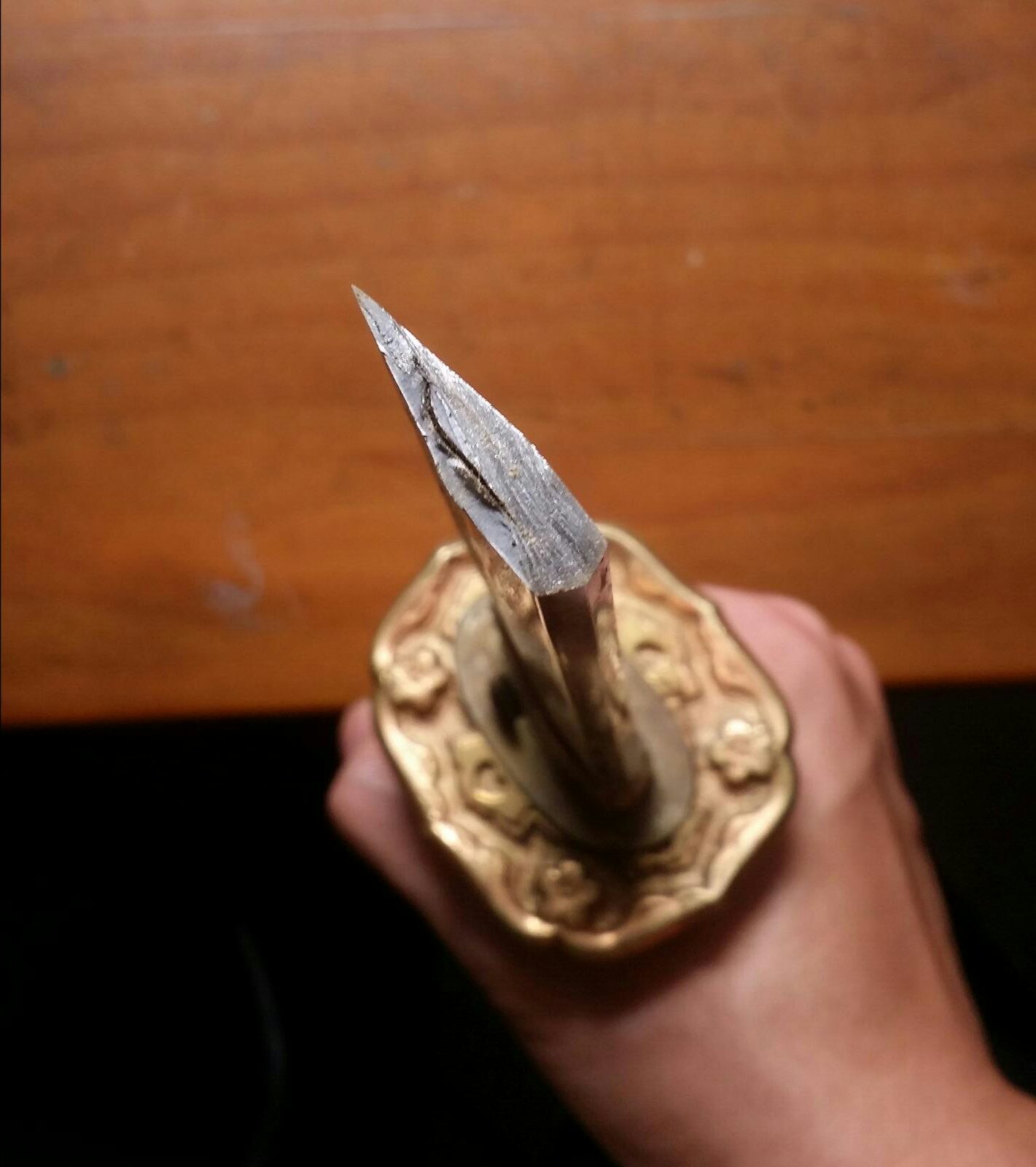

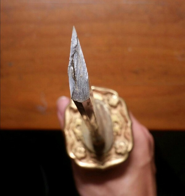

vfox Posted September 9, 2017 Author Report Posted September 9, 2017 Appreciate the speedy reply. Could I please also get an opinion on whether these blades are traditionally or machine made? #1 #2 They are from guntos. Thanks a lot. Jay Quote
Shugyosha Posted September 9, 2017 Report Posted September 9, 2017 I can't see anything to indicate anything other than non-traditionally made blades. 1 Quote
vajo Posted September 9, 2017 Report Posted September 9, 2017 Jay they have been destroyed because they are not traditionell made. The last ones could be hand forged, but they all has been judged as non traditionell. Do you collect these parts of trash? Quote
obiwanknabbe Posted September 9, 2017 Report Posted September 9, 2017 If you want to get a really good idea of what is going on inside that steel.. polish the flat cut to 3000 grit and then submerge in 1/3 soloution ferric chloride and warm water for a few mins.. The metal structure will pop. Kurt K 2 Quote

Lineaments Posted September 9, 2017 Report Posted September 9, 2017 I am curious to understand how some judge these blades as machine made with such self-confidence. The #2 is even having a welding flaw, so it indicates a "handmade" in my eyes. Also, why presume they are cut in half by the government? Some cut their own swords to be able to keep them during the occupation, so not only un-traditional swords got cut. Or perhaps they are broken in battle Quote
vajo Posted September 9, 2017 Report Posted September 9, 2017 There are two terms traditionell and machine made. These cut blades are all indicated as none traditionell made. There are many very nice gunto none traditionell made. For me it is machine made if the smith uses a steam hammer. There is a wide range in that term. These blades are checked, judged and destroyed. https://www.youtube.com/watch?v=aF7X5fxM64k For my opinion machine made Japanese knifes. Are they bad? Of course not. They are great! Quote
TheGermanBastard Posted September 9, 2017 Report Posted September 9, 2017 I do not see why these blades ought to be machine made for sure. Atleast on blade 1) I am 99.9 sure it is NOT machine made ... Hirazukuri and pre Showa Periode ... But in my humble oppinion it does not really matter because all you have there is a partial metal tsunagi. As a Nihonto there is no more value in them. Quote

Stephen Posted September 9, 2017 Report Posted September 9, 2017 Dead swords, RIP. Do as Kurk suggested, polish the ends. really not worth it tho, as in what diff does it make? 1 Quote
TheGermanBastard Posted September 9, 2017 Report Posted September 9, 2017 On 9/9/2017 at 4:31 PM, vajo said: What is your explanation of machine made? Maybe i had some different understandig. For me traditionell forging include all aspects. From praying and cleaning before begining, up to the last stage of polishing. Machine made can be all. Maybe the most think it is only oil hardening? I am subjective now. Oil Hardneing = Showato but still blade can be handmade. Machine made = Likely no Thamagane used and no "classic" construction with soft core and hard sell but just cut / hammered from one piece of steel and no folding at all. or in other word: A piece of stell shaped like a Katana and a fake Hamon either etched or roughly polished. 1 Quote
