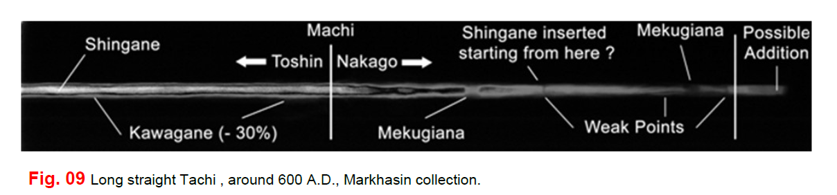

Carlo Giuseppe Tacchini Posted September 7, 2017 Report Posted September 7, 2017 As a scientist (molecular biology) I have to read stuff like this all day long, but after 20 years, most of the topics I read have little new to offer. This kind of study however, WOW! Fun! I attached a PDF so let's see if that opens correct. They scan a Koto era sword and a Shinto era sword, it''s a really cool study. Hamon25-3_Grazzi.pdf Guess youll'like this Gamma Radiography (Sr 92 source, the result of the radiograph has been adjusted in saturation to obtain the picture hereunder.) 5 Quote
Ken-Hawaii Posted September 7, 2017 Report Posted September 7, 2017 Yes, Carlo, that one image is worth its weight in gold! First verified example of shingane (i.e., kobuse)! Ken 1 Quote

Carlo Giuseppe Tacchini Posted September 8, 2017 Report Posted September 8, 2017 Yes, Carlo, that one image is worth its weight in gold! First verified example of shingane (i.e., kobuse)! Ken Our thanks to the owner, Boris Markasin, that managed the matter for pure love of knowledge. I wish I hadn't lost the contacts with him cause he surely continued his studies on Jokoto. May be Ted Tenold knows where he is now. P.S. to be fair there were earlier images taken by Suenaga (hereunder) but this one is the first taken with technologically avanced instruments. Quote
