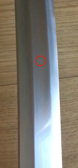

I recieved yersterday evening a blade from a trade here in NMB.
The blade is very nice and healthy and was polished in Japan a couple of month ago.
This morning i take a deeper look on the blade and after removing the choji with uchiko i found 3 spots of rust on the blade.
The biggest one is maybe <1mm and under macro you see a very thin ware where it rust.
My question is how what is the best way to handle the spots? If you take a fast look you didn't see them, but if you know the place you look on it.
I have a old mumei koto wakizashi with a fresh Japanese polish from a member here with a single rust spot on the kissaki. The blade was cheap so i didn't care much about it. But this blade now is much more worth. So I'm a little afraid about the iron cancer on it.
I oild the blade no with caramba70 (maybe like WD40). I think it is more liquid than choji to go in the blade.
Small spots of superficial rust could be removed using improvised tools of ivory or bone AND A LOT OF PRUDENCE. However if there is a ware we don't really know if the rust is working under the skin, not knowing if and how the ware develop in depth. Freshly polished blade are very fragile under this point of view and should be oiled very frequently.

The picture above is not that what i put with the blade in the saya. Its a macro picture of the spot with the caramba 70 oil.
I didn't care longer of this tiny little spot. It is obviously old oxidation. I oil the blade with a high quality oil and clean in the future with isopropylalcohol.

Neutralise the rust and it will bother you no more...! When it's brown it's active...get it black....I use copper to clean it then Renaissance de- corroder...Done lot's of swords over the years and it's always worked....Just my opinion...If I found the missing Masamune I'd still use it !

Yes,that's the one...That 1 litre will de- corrode all the blades in the country but that's the smallest container...You only use a small amount ....Had mine for years and it doesn't seem to degrade.....The wax is also very good,they use it in The British Museum...again,a small container last's for years...I Don't put the wax on my Japanese blades but wouldn't be without it for my other swords....

Chris,sorry,forgot to add....Have a friend who buy's lots of swords and some are obviously freshly polished in Japan...I do suspect they are what some label " commercially polished " and you have to keep an eye on the blade for weeks on the next Just in case some moisture surfaces....Not sure if it's in the metal or from being put in the saya without being correctly dried and cleaned....but not a problem if spotted in time....Just keep an eye on it..! After the de-corroder is used,no problems....

I understand to use only a little drop on the corrorsion. What doing after this? Some comments say after the de-corroder you must wash it up under water?
Hello Chris,
Yes,wash it off with clean water,dry thoroughly and the next part can be a bit contentious and you can ignore it if you are happy with the result thus far..I use solvol autosol chrome cleaner on a cotton bud ( the cotton ball on a stick people are not supposed to clean their ears with but they do ) to polish the damaged area...It's superfine so won't damage a polished blade,then one pass over the blade with an alcohol wipe ( the small ones used in the medical profession are best ) then oil as you would normally...Personally I don't use uchiko powder on polished blades just alcohol and choji oil.....but that's only my take on things....don't want to step on any toes or start a cleaning war !
