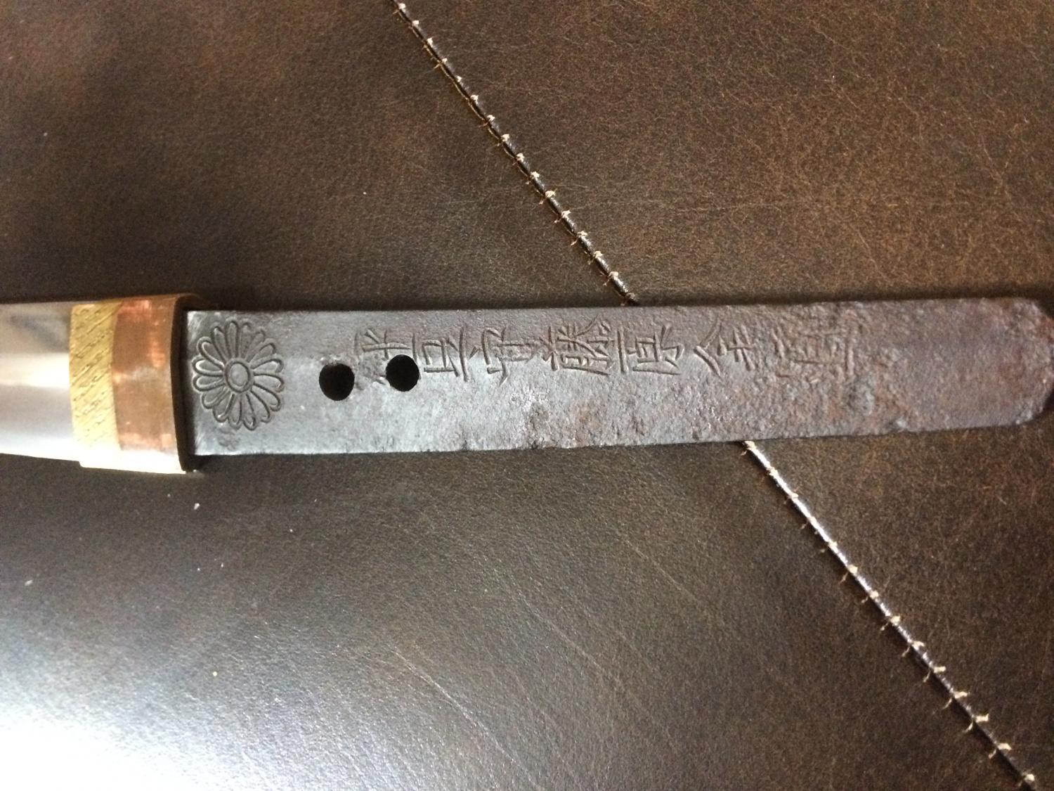

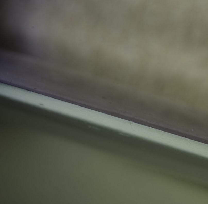

Ben9806 Posted August 31, 2017 Report Posted August 31, 2017 First post here for me, I wish it was about something else, but could do with some advice on a few matters. Firstly I was wondering if anyone had come across this wakizashi before, any resent history would be very helpful. (Izu No Kami Fusiwara Kinmichi) Secondly, I think I've found three cracks in the blade, hagire, admittedly I'm no expert and was wondering by the photos if this could be confirmed Thirdly, I've just purchased this blade with no mention of any flaws in the advertisement, and I'm unsure now of its worth and how to go forward, any advice would be much welcomed. Quote
ROKUJURO Posted August 31, 2017 Report Posted August 31, 2017 Ben,welcome to the board!It is difficult to judge with photos if there are scratches or really HAGIRE, but I think I see at least one of them plus some WARE/pinholes. The sales conditions and the seller's fairness decide what you can do. If the blade was described as free of flaws then you should talk to the seller and possibly give the blade back with full refund. Sometimes a very low price hides the possibility of purchasing a defective blade.The value depends on many factors. A very rare old blade from a famous smith with superb quality, but some serious flaws may still have a good value as studying object while a SHINTO blade with the same KIZU might lose most of its 'normal' market value, compared to intact blades. Quote
Ben9806 Posted August 31, 2017 Author Report Posted August 31, 2017 Hi Jean thank you, I agree without seeing the blade in person it's hard to say for sure, a full refund is an option for me, however I'm reluctant as the blade will possibly be sold again in the same manner and someone else will have the same problem, and also the rarety of this maker appeals to me although he wasn't the best. I guess my next move would depend on the worth of the blade knowing now the faults it has. Quote
Geraint Posted August 31, 2017 Report Posted August 31, 2017 Hi Ben. Sorry to hear that your first sword has caused you problems. I guess the first step is to show it to someone who can confirm in hand the hagire, the other flaws were mentioned in the description but hagire were not. They can be hard to spot and in hand is the only way to be sure I think. Not sure where you are in the UK but there are quite a few of us here and one of us is probably in fairly easy reach for you if that is something you would like to pursue. If it came from where I think it did then the returns policy might be your best bet, "All Internet / email customers have the right to return an item within two weeks of receipt for a full refund if the item is not as described / depicted in the photographs. EU customers have additional rights to cancel for any reason within 7 working days of receipt of the item(s) under 97/7/EC (in such cases the customer is obliged to return the item / items to us at their own cost). Any insurance element paid in the shipping cost is NOT refundable if the item / items has / have already been shipped / sent. If you wish to return an item for refund, please contact us by email first" Did you ask for the full size pictures? Even if you did then this might be hard to spot. I hope you can resolve this but above all don't let it put you off. If you are in the northern half of the country then join the Northern Token society, great bunch of people and a chance to see some good stuff. If in the south then the same for the Token Society of Great Britain, who have a meeting coming up in Northumberland in October. http://to-ken.uk/home/news.html All the best Quote
vajo Posted August 31, 2017 Report Posted August 31, 2017 The last picture ist hagire, i would bet. Quote

Ben9806 Posted August 31, 2017 Author Report Posted August 31, 2017 The last pic is the best shot of one of them I've managed so far Quote

Ben9806 Posted August 31, 2017 Author Report Posted August 31, 2017 On my way back from the armouries in Leeds now, thanks again Dave and it was great to see you. The general feeling is that the marks were not cracks but deep scratches that someone has tried to polish out. And there are signs of a polishing wheel being used to do this. Also looking forward to seeing it after John's given it the polish it deserves. All in all a very relieving evening. Next to apologise to Mark for causing him so much stress. 2 Quote
seanyx11 Posted September 1, 2017 Report Posted September 1, 2017 I'm glad you were able to work it out and find some experienced collectors to study it with. Just out of curiosity, did you figure out which Kinmichi made it? In your first post you said that it was Izumi no kami Kinmichi, but Izumi no kami was usually given to Rai Kinmichi and there is definitely no "Rai" in the mei. Plus, I'm fairly certain it doesn't say "Izumi", but it doesn't look like "Iga" either. All I can definitively make out, is "kami fujiwara Kinmichi". I'm very new to collecting and just started to attempt to read mei a few weeks ago, so I'm just trying to make sure I'm correct in my comprehension of the mei. I actually have an Izumi (no) Kami Rai Kinmichi (3rd generation) wakizashi, so I'm interested in the 5 main Mishina lines of smiths and the differences in their mei. Any info would be great, thanks Quote
Marius Posted September 1, 2017 Report Posted September 1, 2017 You don't need any specialist to help you. It is very simple to determine if the flaw shown on your picture is a hagire. If you see it on one side of a blade, it is a scratch, if it is an identical line on both sides of the blade, it is a crack. I shouldn't say that, since it is so obvious, but since nobody has mentioned it... 2 Quote
IanB Posted September 1, 2017 Report Posted September 1, 2017 Having looked at the blade last night I am pleased to say I couldn't see any hagire, but it has been on a linisher or something similar that had left some transverse scratches that haven't been taken out. I became distracted by other things before really looking at the signature. Ian Bottomley Quote
Ben9806 Posted September 1, 2017 Author Report Posted September 1, 2017 Cheers guys, There was something there very special so don't worry Ian. As far as I'm aware it's 'izu no kami' 2 gen from the kinmichi mishina school Quote
