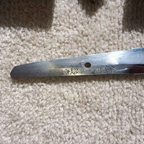

Mortis Posted August 18, 2017 Report Posted August 18, 2017 Thoughts on the mei? Sword has no hamon that I can see and the nakago has virtually no patina, if there ever was. It is sharp though. Quote
Fuuten Posted August 18, 2017 Report Posted August 18, 2017 Apart from the signature (which doesn't look great), we need better photo's. Quote
IanB Posted August 18, 2017 Report Posted August 18, 2017 Justin, Sadly you are now the lucky owner of a Chinese made sword trying desperately to be Japanese. I hope you did not pay too much. Ian Bottomley Quote
Mortis Posted August 18, 2017 Author Report Posted August 18, 2017 Thank you gentlemen. No I did not....$25 dollars, so I didn't have very high hopes whatsoever, one way or another. Had in mind a cheap piece for "public" display. Thanks again. Quote

Jussi Ekholm Posted August 19, 2017 Report Posted August 19, 2017 Do you have more pictures of it? I think it might be a really good buy for 25$'s. You normally won't get even stainless steel wakizashi replicas that cheaply. Quote
Stephen Posted August 19, 2017 Report Posted August 19, 2017 lol that would be funny, if it was a mumei blade that someone wanted a mei! Yes lets see the rest of the story fittings and all! Quote
Brian Posted August 19, 2017 Report Posted August 19, 2017 A kick in the ass can still be considered a step forward. I love this place, am grateful for it's existence, and I apologize for cluttering up the board with junk. Precisely the reaction we expect and look for here And no....you are not cluttering anything. Feel free to post them. I don't want people to be too pc...tough love and all that. But once the point is made, it's made. No need to reiterate it...again...repeatedly But yes...we will be blunt and tell people exactly what they have, and what is advised. After that, it's their call. Sounds like you will do just fine 1 Quote

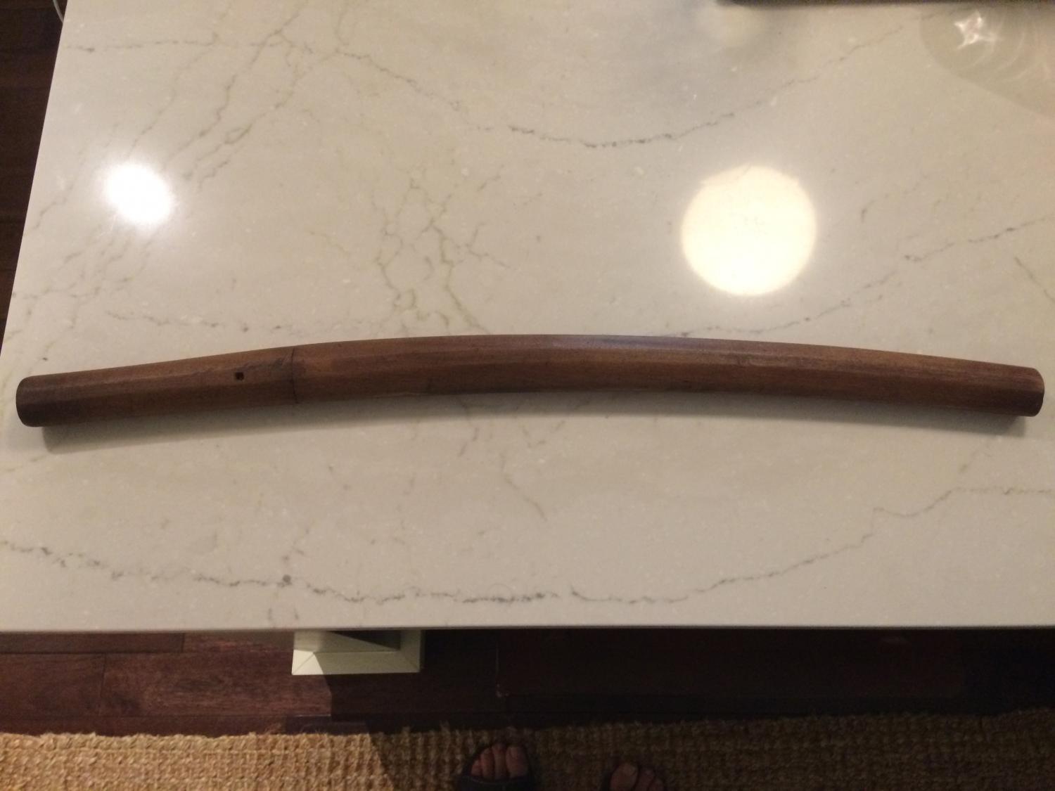

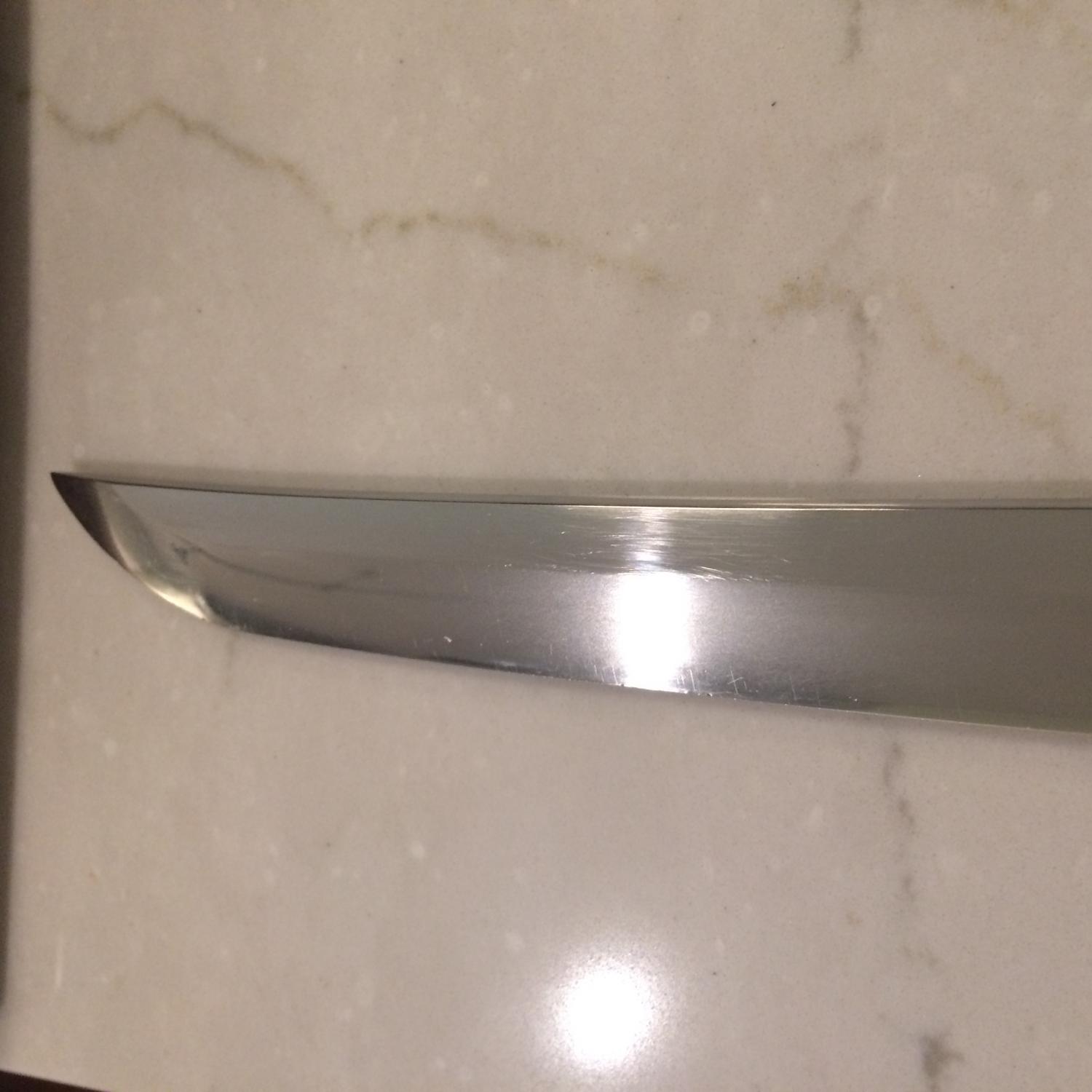

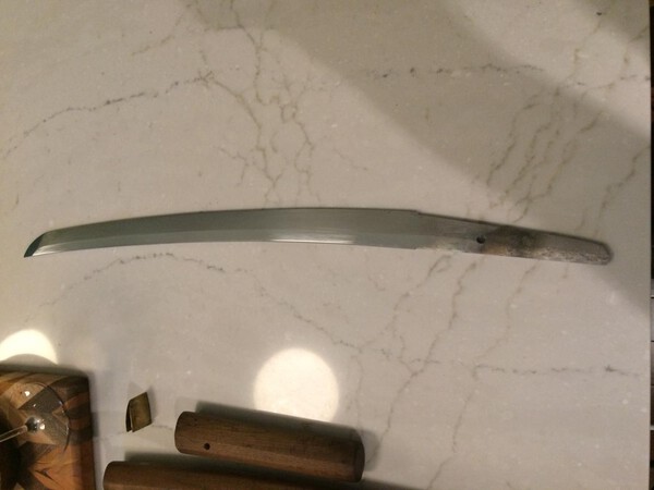

Mortis Posted August 20, 2017 Author Report Posted August 20, 2017 Ok fellas, here's some additional photos. Blade is in shirasaya, brass habaki, and honest to God, I think I can see some hada in this thing. Also, I don't know how to prevent the photos from becoming inverted in some cases. Quote
Stephen Posted August 20, 2017 Report Posted August 20, 2017 Ill go out on a limb and say true Nihonto, an that the nakago was severely messed with, even has heat marks, some pix to large to open or broken. Quote

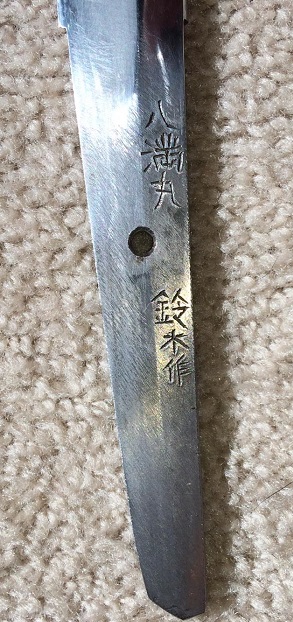

PNSSHOGUN Posted August 21, 2017 Report Posted August 21, 2017 Doesn't look too bad to me, might've lucked out. Anyone able to translate the mei? Quote
Brian Posted August 21, 2017 Report Posted August 21, 2017 The kanji are fake as heck.IF it is a real sword, and that is a big IF, then it is the front end of a katana that has broken and a new nakago cut. The dimensions of the blade and overall thickness don't really fit a wakzashi. Quote

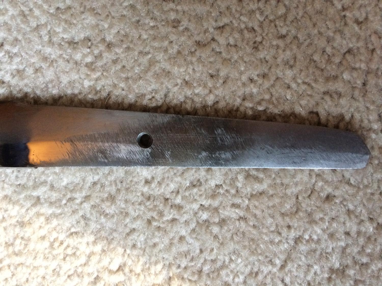

Stephen Posted August 21, 2017 Report Posted August 21, 2017 clear shot of the other side of nakago please Quote
Mortis Posted August 21, 2017 Author Report Posted August 21, 2017 Stephen, I'll get on that when I get home from work tonight. Quote
Mortis Posted August 22, 2017 Author Report Posted August 22, 2017 I'm gonna go with Brian's theory. If the photos turn out right, you can see there's a portion of the nakago, near the hamachi, that is (or was) polished and has no file marks. There are other spots here and there that show the same, easier seen in hand of course. Also, both the mune and ha machi seem very shallow for a blade that doesn't look so old. Quote
Stephen Posted August 22, 2017 Report Posted August 22, 2017 Nakagoana looks punched not drilled Quote
Bazza Posted August 22, 2017 Report Posted August 22, 2017 But the yasurime (not yasurimei) look VERY unprofessional and not from the hand of a Japanese artisan. BaZZa. Quote
Stephen Posted August 22, 2017 Report Posted August 22, 2017 Might be what ya all think it is, i see the nakago as being have severely messed with Quote
