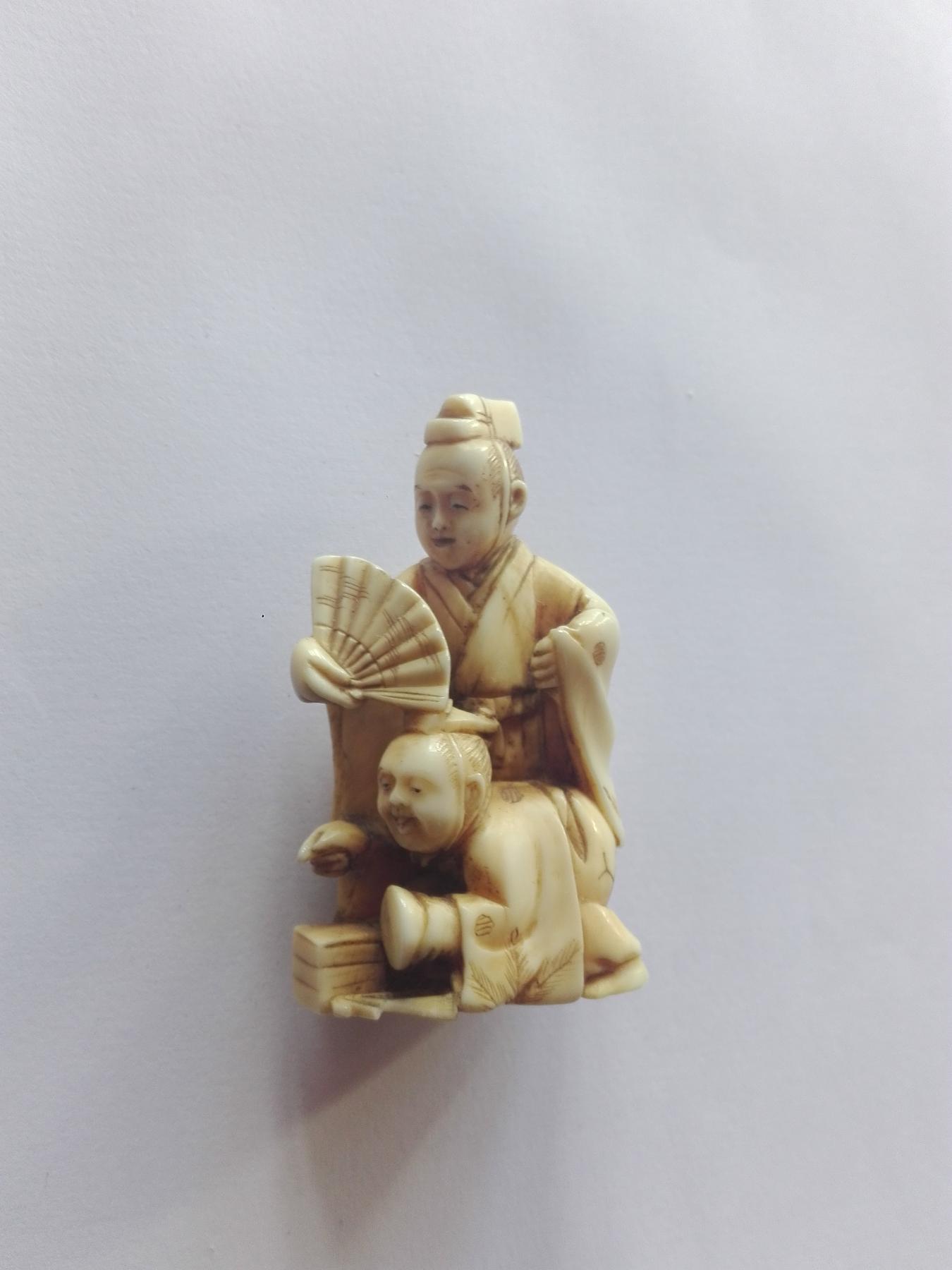

Akao Posted August 14, 2017 Report Posted August 14, 2017 Hello, I don’t know anything about netsuke, so I appeal to your knowledge ! Here two netsuke brought back by my great grandfather from Japan : he was a french naval officer and was in Japan circa1900. One of the two is signed, H. 5,5 cm each, I'm interested in any element about it (iconography, etc.) Certainly not master piece, he was better officer than collector ! Thank you for yours comments, Regards Quote
shibeni Posted August 29, 2017 Report Posted August 29, 2017 First one, with signature look's very fine made. Regards, Bojan S. Quote

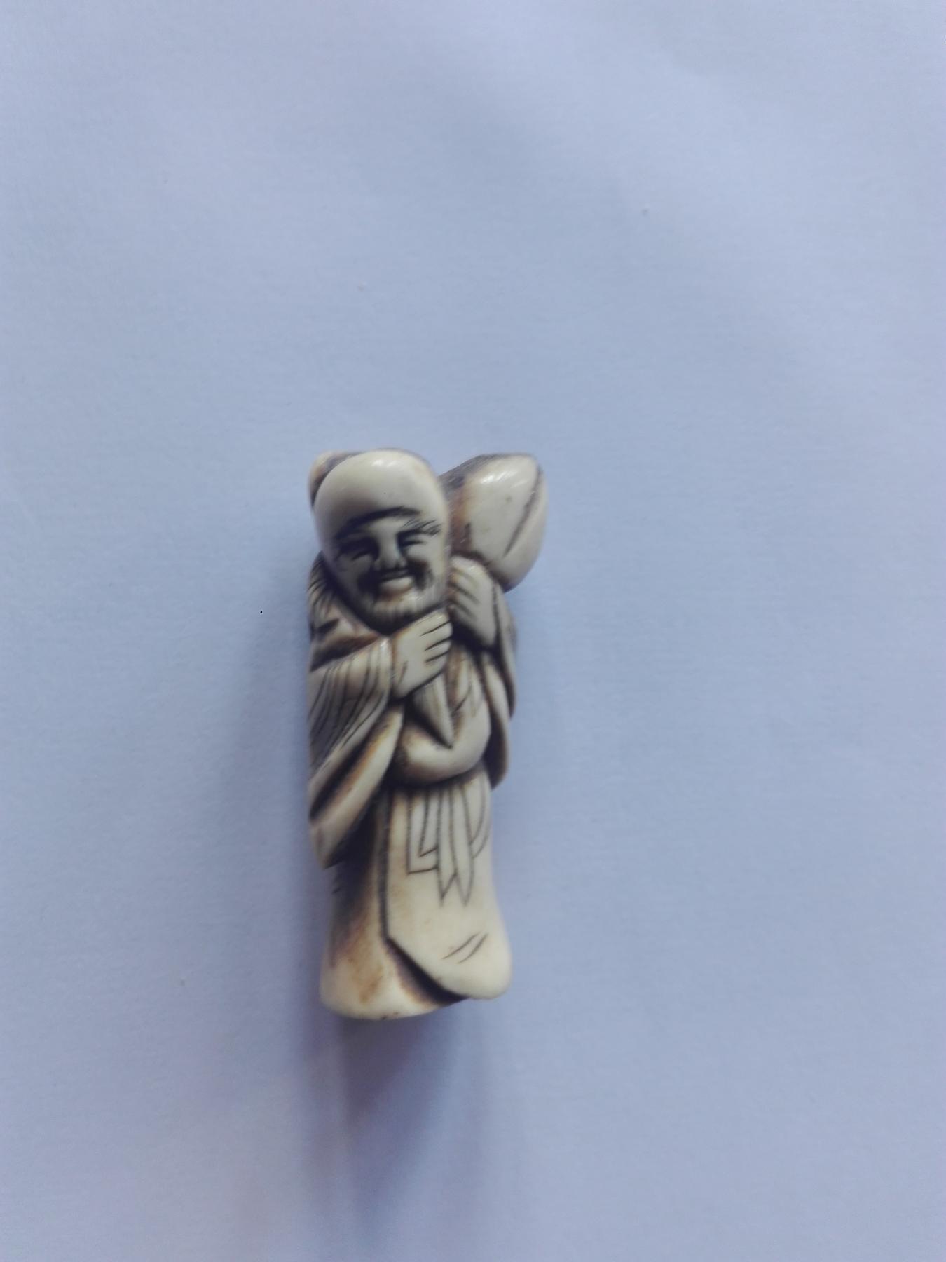

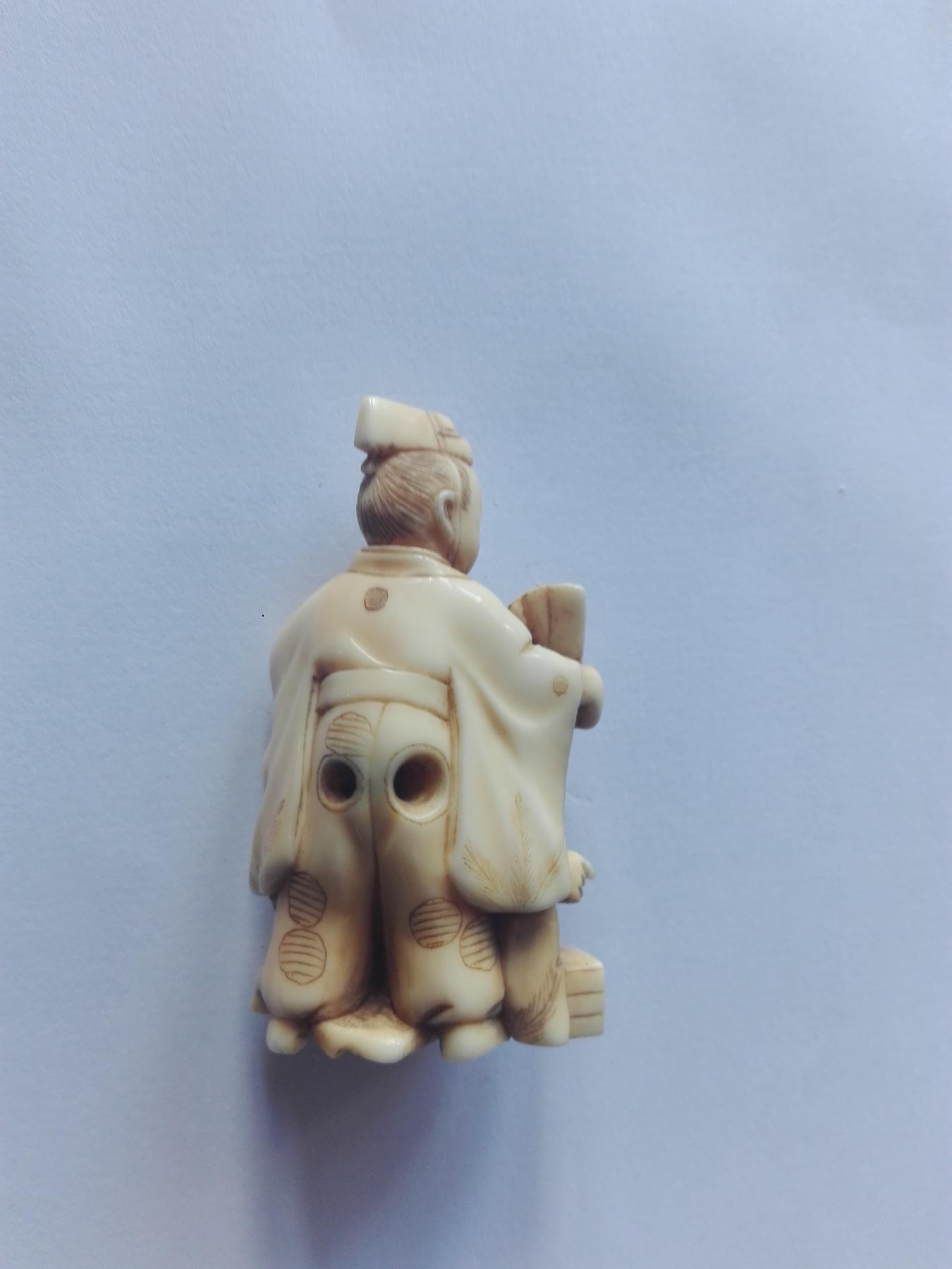

SteveM Posted September 1, 2017 Report Posted September 1, 2017 I was looking at these and unfortunately could not come up with anything definitive. The netsuke with the two figures are representing either someone of high-rank, or actors portraying such. The hats worn by the two figures are representative of someone with social rank, and I think their costumes and the fan also reflect this, but that's about where the guesswork ends. The red "signature" square is unusual. I don't know if the writing in the square is intended to be a signature or something else. It doesn't look like a name. It sort of looks like 一三川, which is too cryptic for me to figure out. The red color is enigmatic also. Interesting, but this is as far as I got. The other netsuke stumps me as well. I was thinking it might be representing the god Hotei, and he is carrying what looks to be like a daikon radish, or possibly an eggplant (eggplant symbolic of fruitfulness). Quote
Baka Gaijin Posted September 2, 2017 Report Posted September 2, 2017 Hi Steve, in the first netsuke, could they be playing the fan tossing game Tousenkyo? The smaller character has what looks like the block and target in front of him............ Quote
SteveM Posted September 2, 2017 Report Posted September 2, 2017 I think that's a good guess. If we could get a better look at the thing on the ground in front of the crouching guy, it could remove all doubt. Quote
ROKUJURO Posted September 2, 2017 Report Posted September 2, 2017 The first NETSUKE seems to be made of ivory; it is a better one, but with its lack of fine detail not top quality, as you already said.The second NETSUKE is very probably made of bone, and it looks like amateur work ('peasant' style). We have to remember that in Japan of 1900, NETSUKE were not necessarily objets d' art, but still items for daily use as KIMONO have no pockets, and some pieces of equipment (SAGEMONO like INRÔ or KISERUZUTSU) had to be secured on the belt (OBI) with the help of a NETSUKE or MANJÛ.Wealthy people could afford good quality NETSUKE, while lower classes had to content themselves with simple items, often not made by artists. Quote
