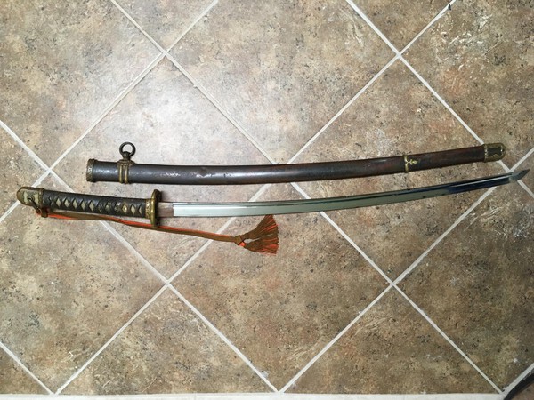

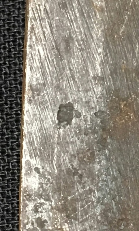

Bruce Pennington Posted August 9, 2017 Report Posted August 9, 2017 I was excited to pick up this item because it's almost identical to the one depicted on Dawson's book, pages 156-158! Sadly, the chrome is coming off in isolated spots. Nakago has small inspector stamp, probably a Seki. My impression is that these were made during the gunto shortage of the mid-to-late '30s. It seems to be made by the same process as the NCO Type 95 blades, but chromed to "officer-ize" it, and obviously no serial number. The whole thing seems to have quite a bit of wear as the tsuka ito is fully darkened by hand oil and the saya paint is heavily worn off in most areas. 1 Quote

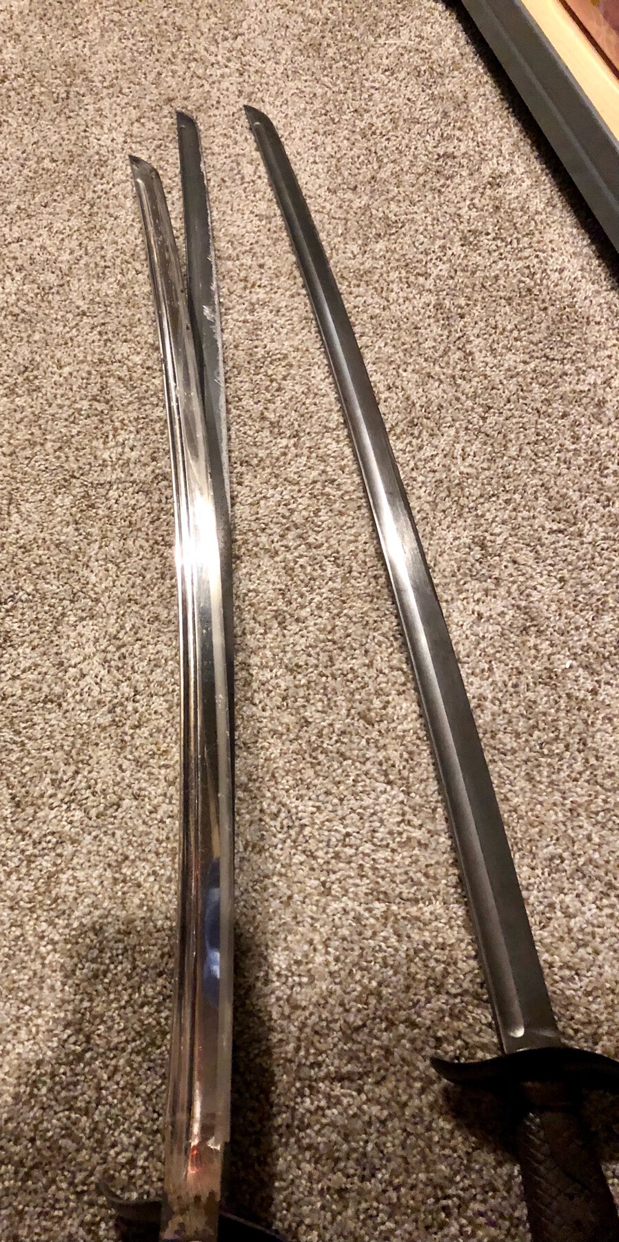

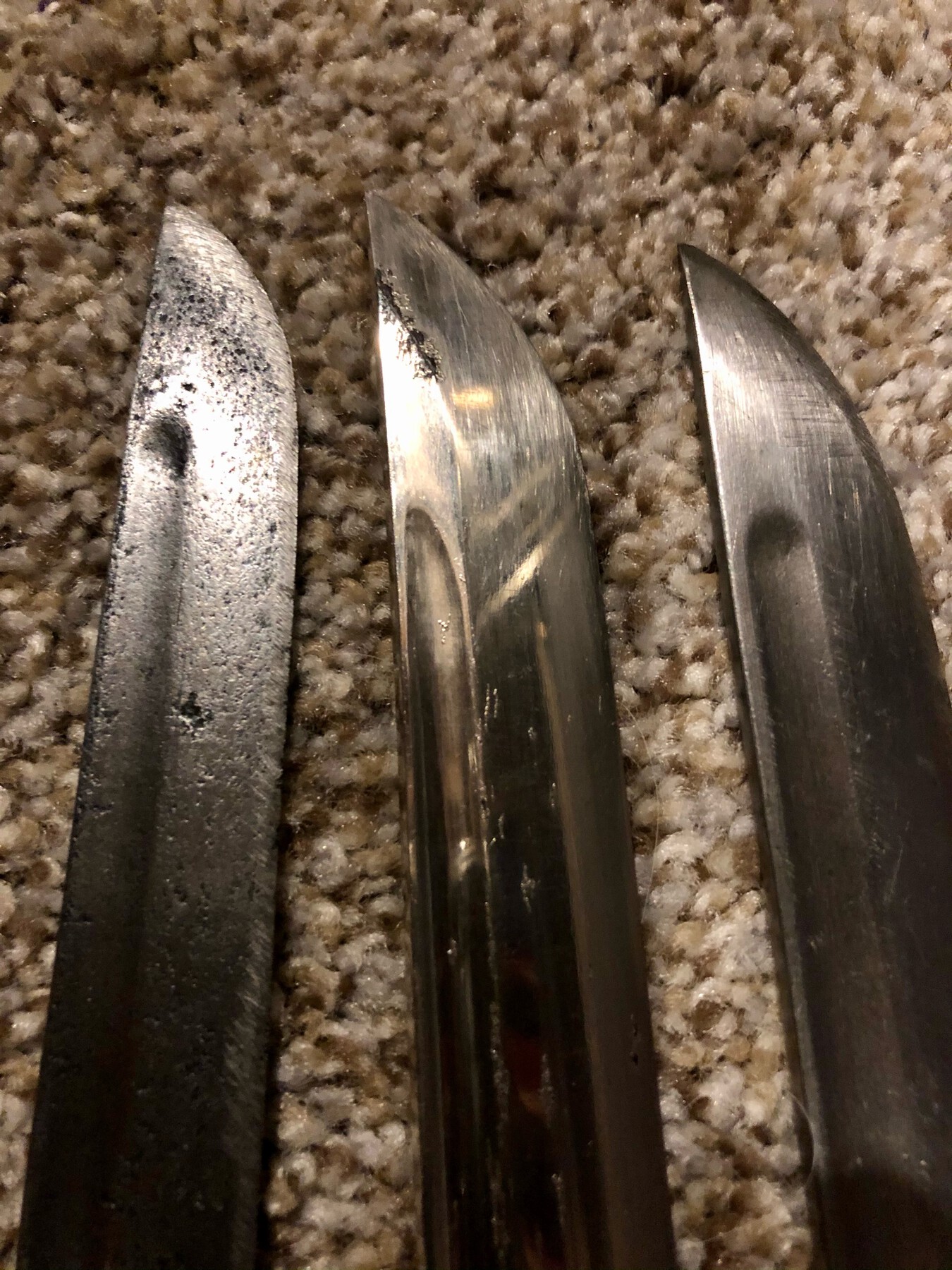

Bruce Pennington Posted August 13, 2017 Author Report Posted August 13, 2017 I've taken better picutres and compared it to a Type 95 blade. It's definitely different and not made the same way. It is more koshi sori than the NCO, slightly shorter, slightly narrower. The weight feels quite close, with the difference only due to the dimentional differences. The bo-hi goes under the habaki, and stops sooner than the NCO. Obviously the nakago is shorter. So, while this may have been made from a single piece of steel, like the NCO, it was made specifically to be this kind of gunto. 4 Quote

Bruce Pennington Posted August 13, 2017 Author Report Posted August 13, 2017 Very interesting blade Bruce. The saya was dark red colored? Very interesting blade Bruce. The saya was dark red colored? Chris, the red seems to be a thin undercoat. Looking in the dented areas, therefore unrubbed, the top coat is the dark IJA green. Quote

Bruce Pennington Posted September 10, 2017 Author Report Posted September 10, 2017 Update: Picked up a sarute and Field grade tassel. Now it REALLY looks like the one in Dawson's book! 2 Quote

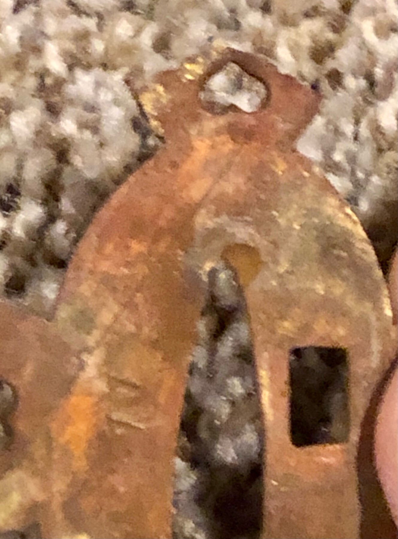

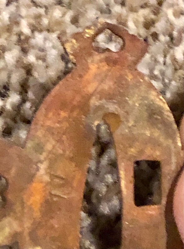

Bruce Pennington Posted March 11, 2021 Author Report Posted March 11, 2021 8 hours ago, Kiipu said: Better late, than never! If the sword is still at hand, I would like to see a picture of this nakago marking. Also, there appears to be some sort of marking on one of the seppa. It looks like a square but the resolution is poor. Are there any other markings on this sword? Sorry to say, that nakago mark is something square and indistinguishable, not a "NA" like I thought originally. What looked like something square on the seppa was just a shadow of some hammer-work or imperfection: The only thing I found identifiable on the nakago was an "11" matching the numbers on the fittings. 6 hours ago, Stegel said: It looks like the blade shown as the modified type95 (from type 32) I haven't had time to get any dimensions, but these pics should give some perspective. I really don't think this was a re-purposed 32. The sori is deeper than the 32; the bohi begins and ends differently and the blade is simply much smaller. Quote

Shamsy Posted March 11, 2021 Report Posted March 11, 2021 Darn, now there is a comparison shot against a 32, it's not even close, is it. The search goes on. 1 Quote
